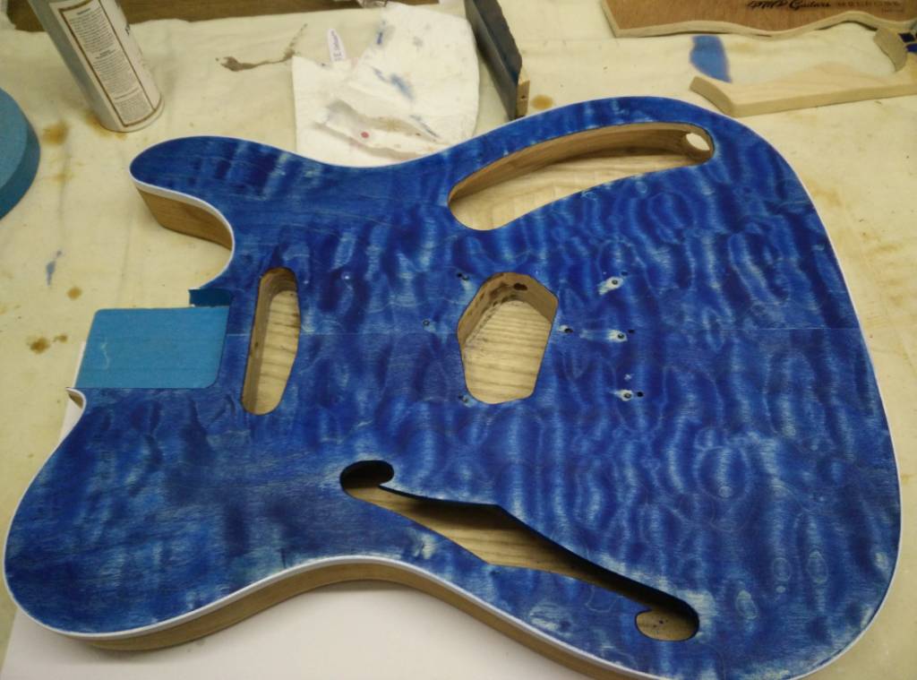

Not a huge amount of success with the acetone to actually remove the glue, but with some careful use of blue sharpie (and blended using the acetone) the visible white dots are suitably covered.
I've now started building up layers of finishing oil. What have others done when dealing with two different coloured strains? I'm worried about the blue bleeding into the amber on the sides so I'm oiling the top first and will do the sides and back once the top is more stable.
