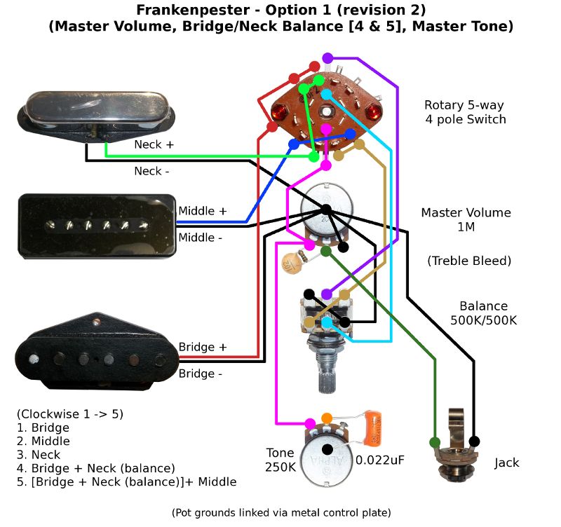

Pest, if you haven't done your wiring yet hold off for the moment. I was thinking about how to do a better version of the option 1 layout and realised there's a flaw in the original one I posted (it would still work but the balance would have an impact where shouldn't). I'll draw up the revised/improved/fixed version later tonight. Sorry.
Hey Weirdy, all I have done so far is wire up a treble bleed, that's all!

Pest, here's the revised Option 1 diagram (I've also updated it in the original post). It still has the same switching/options as before, but now all the pickups connect directly to the switch which then controls what goes to/from the balance pot. This fixes the balance pot issue and simplifies the wire routing a bit. It should all work as intended now.
http://www.buildyourownguitar.com.au...3&d=1434724749
(wow, that 97KB limit really is a pain... even these relatively simple wiring images start to look mangled when you compress them down that far)
@Weirdy, cheers mate, I have now downloaded the new diagram and deleted the old one!
