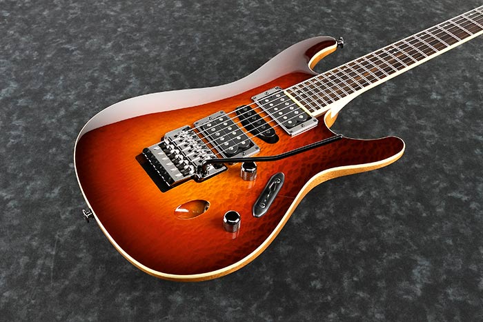

I'd look at getting and fitting a VLX53 5-way switch. It's the switch Ibanez use on their HH guitars which makes getting various pickup combinations with splits very easy.
https://www.realparts.com.au/vlx53-h...er-switch.html
34mm deep though, so check you have the depth.
This is the standard Ibanez HH configuration selection. A bit different from some, one could say rock biased with no individual neck or bridge single coil selection.
Attachment 41087
If you also managed to find an Ibanez 5-way switch cover from an S-series, you could open the slot up and have the switch mounted on the top of the body which will give you plenty of depth. Try eBay. Here's an example of what you'd be looking for: https://www.ebay.co.uk/itm/203462347002
Looks better when installed.
I really like the S-series look.
Attachment 41088
That's true. I just noticed it was on my main reference model. https://www.ibanez.com/usa/products/...21q_00_02.html
Looking at the control rout, it might be a very tight fit. The two normal mounting holes are already quite near the edges of the cavity, and the fixing holes for the cover would sit outside of those holes. Cavity enlarging may be required. Anyway, it’s a possible option for consideration.
