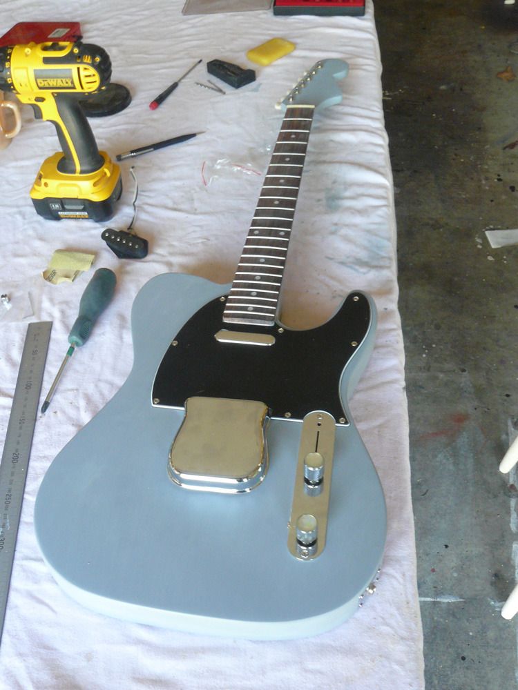

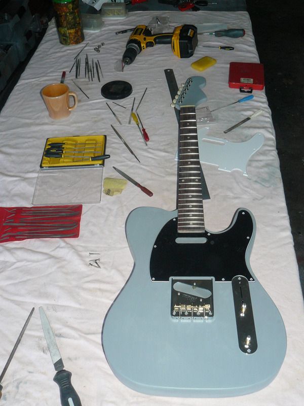

So, busy dry build today. Fitted the tuners and they lined up spot on. :)
Fitted the neck, adjusted the pick guard to fit and mounted the front PUP, fitted the bone nut (not glued in yet as I forgot to buy glue :P ) Fitted the bridge, found I had to use the adjusting screws from the PBG in the Wilkinson to get intonation set up right...went to install the rear PUP..Oh Oh. Tone riders are wider and longer that PBG ones. Aren't I glad I did a pre top coat test! (I didn't have the toneriders when I did the first test. I dont own a router so...sanding drums on the drill it was. OK, lets wire this up. DOH some dickhead ordered a 4 way switch instead of a 3!
Anyway great progress made,

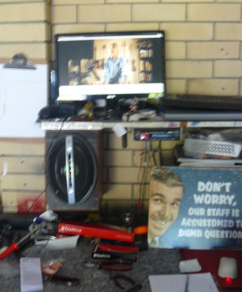

Adam was there watching I didn't stuff up . Nice to have a PC in the storeroom.work shop
http://img.photobucket.com/albums/v2...ps71lxi6dy.jpg
HA ha good ol' Ads on the tube.
That pickguard has a nice fit.
I grew up with the same coffee mug lol (70's mug)
