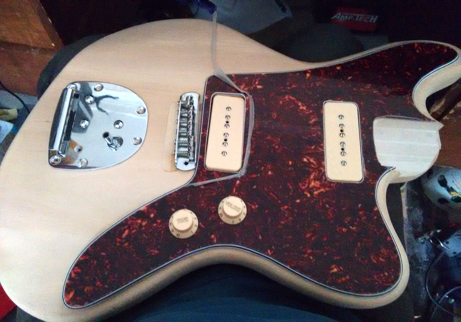

Hi to all. Havnt been on for yonks, no work on my tele yet, will get round to it now winters coming.
A HUGE QUESTION. Im doing a bit of maintainance on my JM 1 and having a problem. The intonation is a little off at the low e string, i think its because i should of set the bridge on a slight angle. Bit late now!
So i could remove the neck, fill the screw holes and replace with it just away from the body, the scratch plate would cover it, but i was wondering if the other option could be if i replace the bridge with one with more adjustments? And have you seem one i could use. Any thoughts out there guys?
Ta in advance.
Are they the same dimensions as a 'normal' TOM bridge? I think I saw someone (Probably Simon) mention that the Nashville style have more adjustment available - how much extra do you need?
EDIT: Just scrolled back through the pics, doesn't look the same as a TOM - have you tried removing the spring on the low E to get it back a bit further?
Doh!! I did exactly the same with my JM-1.
Fortunately for me it became evident whilst still in pre-finish state.
I had to re-dowel and then re-drill.

What if you removed the saddle and filed down the side closest to the adjustment screw, essentially flattening off the barrel/cylinder?
Tried to mark what I mean in pink here on the high E
https://i.imgur.com/gJdU3lp.jpg
On my bridge the bass E was all the way to the back.
The high E was all the way forwards...and I needed it even further forwards.
If you want to try and gain a bit more you could probably file the front of the high E barrel.
That should get you a couple of millimetres.
