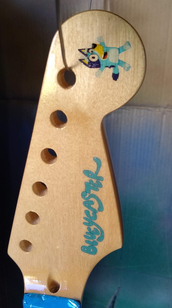

A little more progress. Neck is sprayed with 7 coats of SCA clear (acrylic lacquer):
Attachment 35230Attachment 35231
Now begins the long wait before I can polish the surface. The first coat raised some stray wood fibres so before applying the decal I gave a light sand with 400 grit using barely more than the weight of the paper itself. After that, the back of the neck felt fantastic so I will keep that in mind during final finish as I do prefer a satin feel when playing.
I am very happy with how the colour came up from just the clear with no stain. And the level of smooth glossiness is much better than my first attempts on the body. It should polish up nicely in a few weeks. The hard part is just letting it hang there for all that time.
There was one minor mishap when removing the tape. A small section (just 1 or 2mm next to the fretboard edge) of lacquer came away with the tape in one place near the body end of the neck, but unfortunately not where it will be inside the neck pocket. I don't want to remask everything to paint again so I thought I would try the same method I used to apply the CA. I sprayed some lacquer onto printer paper folded into a brush shape, and used that to carefully apply clear to the small area of exposed wood and smoothed it out. If I remember to sand extra carefully in that spot it might be OK. I will add another application in the same way in an hour or two.
Headstock looks great...was thinking of leaving mine like that but thought why not use stain and stuff something else up lol.
