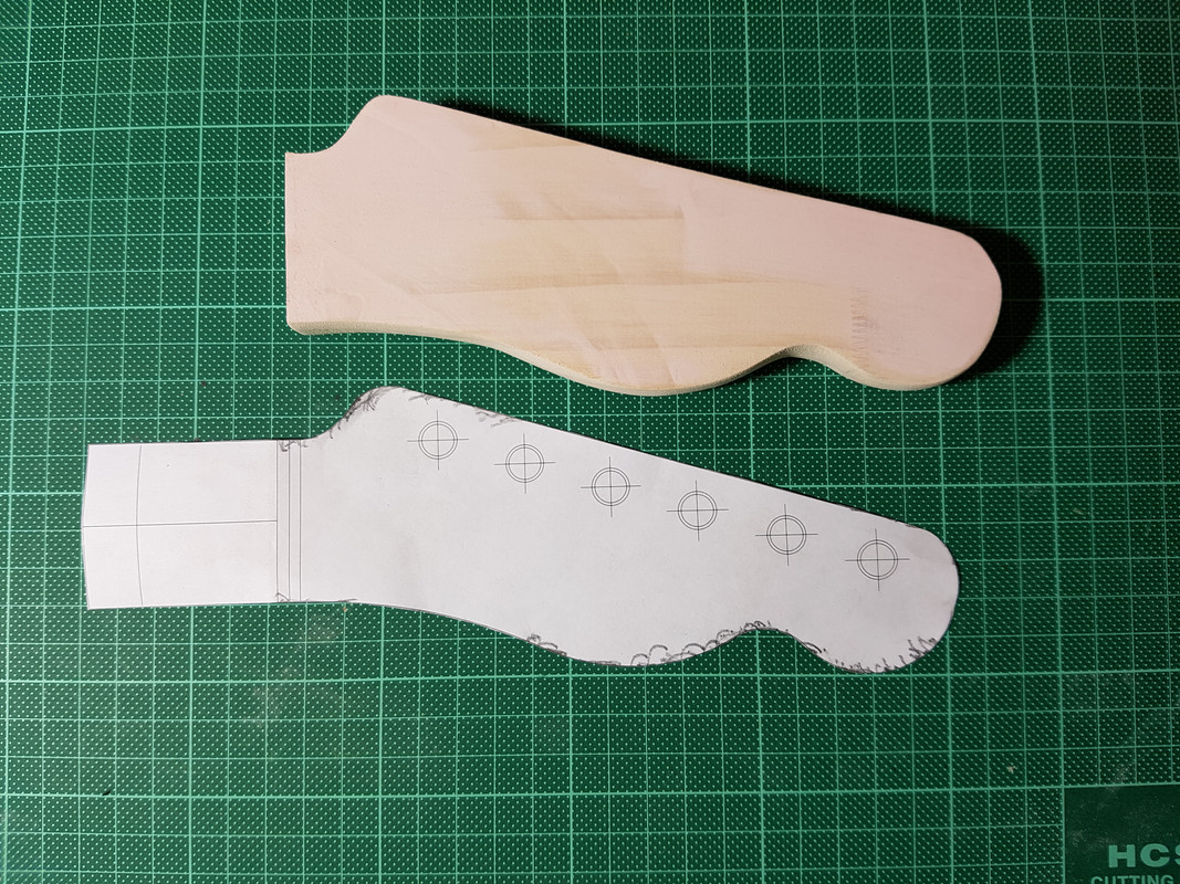

Some jigsaw and fake Dremel practice:
https://s19.postimg.cc/48mazdghf/20180619_164212_1.jpg
Hand sanding practice:
https://s19.postimg.cc/7w6nj9e37/20180619_173142.jpg
Nice! Headstocks often work better when attached to a neck.
