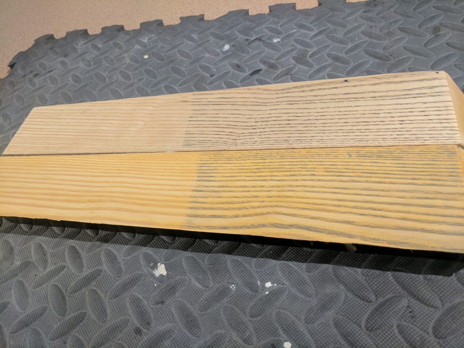

Test scraps
One piece of scrap has natural timbermate on one side and ebony timbermate the other with DT Natural (2 coats)
The other piece of scrap has natural timbermate on one side and ebony timbermate the other with DT Butterscotch (1 coat)
Attachment 22643Attachment 22643

Nice work Andy. Tend to like the natural timber mate look on the vertical LH face in those shots. Ebony seemed to look more dirty rather than enhancing the grain. Does it look better in the flesh?
Yeah it does Waz. The picture doesn't pick up the lustre of the DT in light. Ebony looks good on the natural but no good on the Butterscotch.
Suppose I am just in a 'Natural' mindset at the moment with finishing off the Blonde MMB-4 build.
