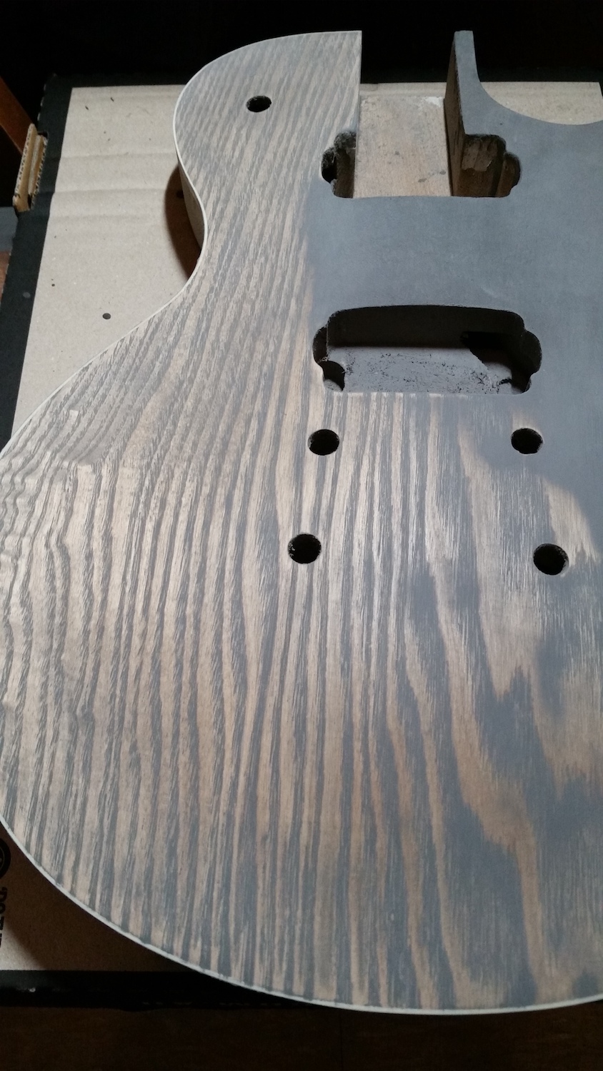

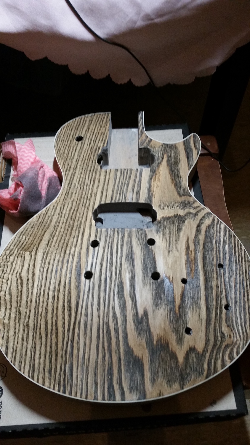

time to pop some grain...
timbermate....

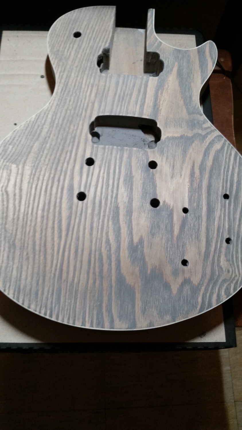

Attachment 14218 Attachment 14219
2 hours of feather sanding.... pop.
Attachment 14220
and black stump DT. intense coming tomorrow.
Attachment 14221
woooo!
Looks great DM, love the way that ash popped
Hell yea!
:cool:
Great result with the timbermate!
Very nice indeed!
Hell yeah, that looks awesome!
Great use of TM and don't recall seeing another Ash LP before?
In the bottom pic it looks like there is the typical Ash grain waves happening where the TM shrinks back in on itself leaving the ripple of the grain behind. Pretty hard to get Ash dead flat and from most other threads, Doc Nomis's Gold Strat in particular, even under solid colours it can prove difficult to hide so I reckon just embrace it as part of the unique look you have already created.
Yeah - Agreed.
Unless I put something like 15 odd coats of clear on it, I think I'll have myself a grainy LP. Does that matter? Not in the least.
My original idea was to shoot for more of a grey-black, this color is more of a brown black. I've been playing with a black to body brown burst idea , but if it's not gonna turn out I'll just 0000 it back to neat, and start the topcoats, I think.
When I get the end result, I'll throw more pics up.
On my Red Ash J Bass there is more than 20 coats of TO and it still has the 'grain waves' visible which is a fairly unique look that I am really happy with and also a great conversation starter from everyone who looks at it.
Agree. The ash grain features in my JBA are part of its uniqueness and look great

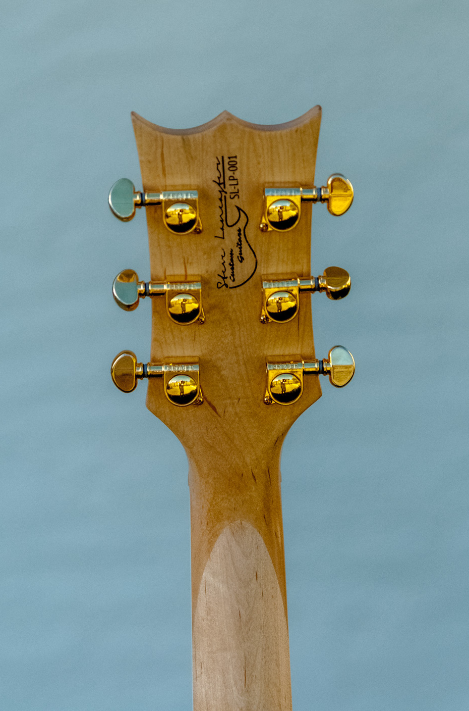

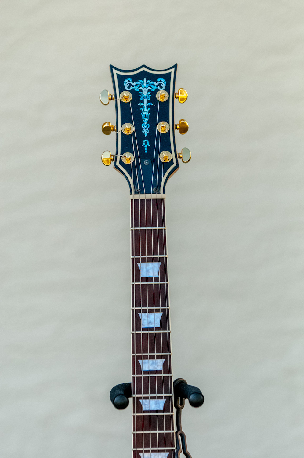

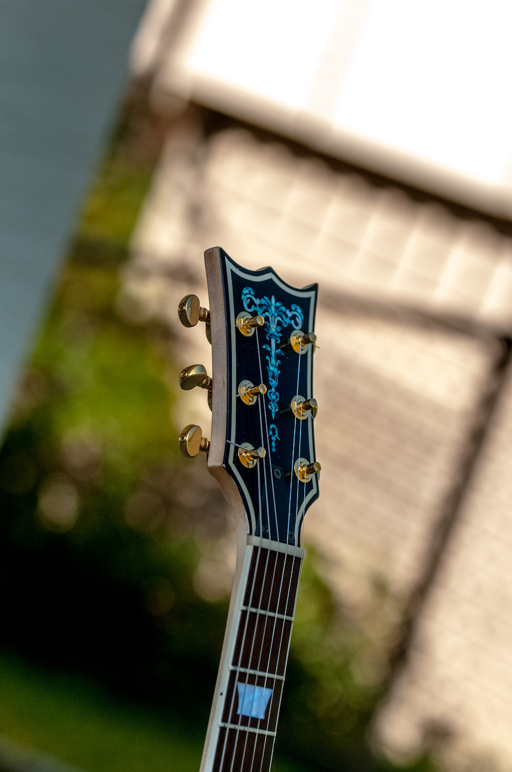

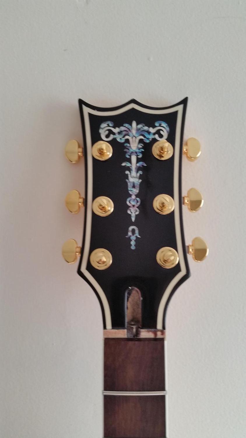

Headstock with the grover's in it.
Horrible Photo... it's a lot prettier than the image.
Attachment 14512
:D That looks great!
Very nice headstock!
Is that an inlay sticker from Jockomo?

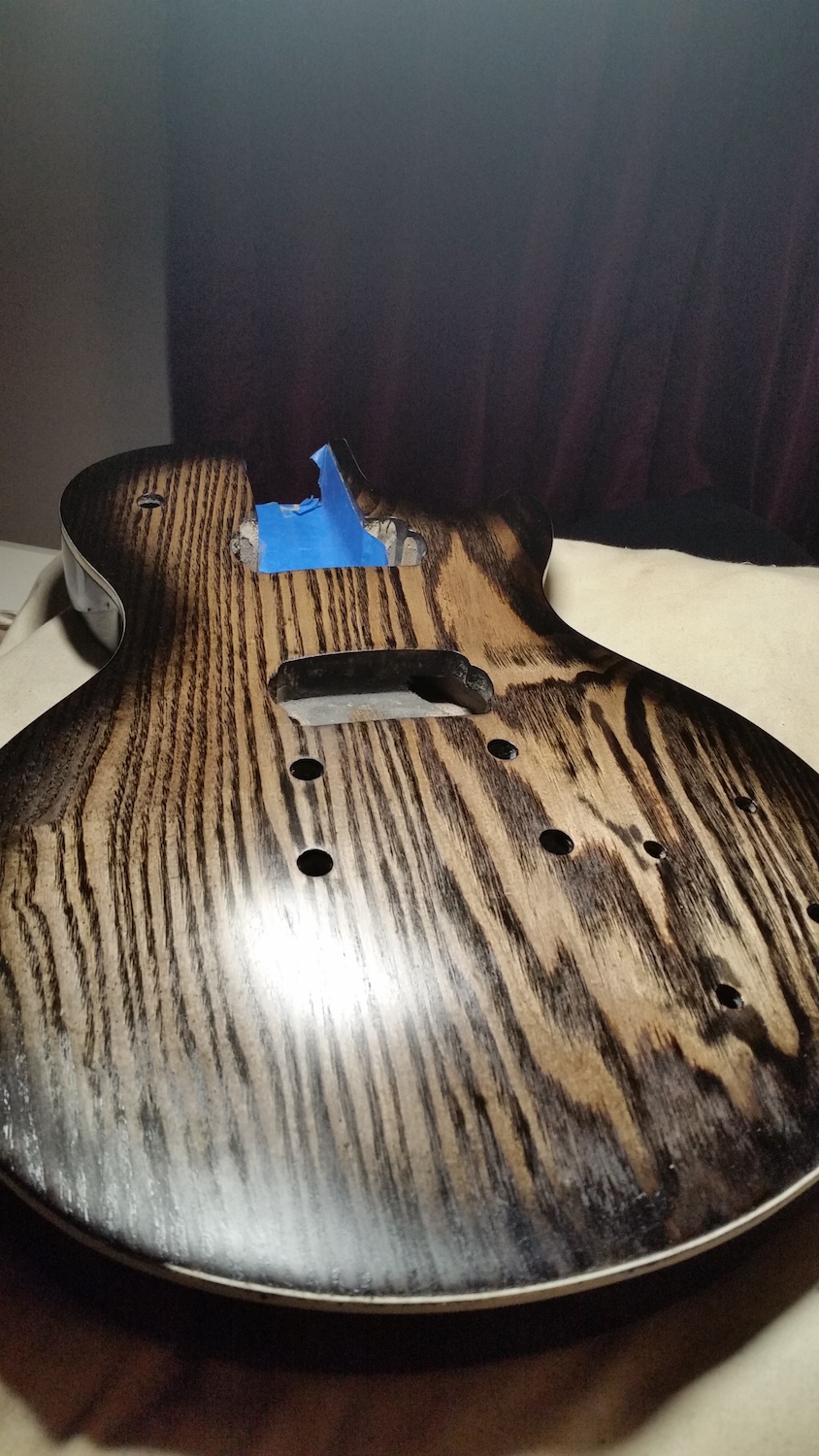

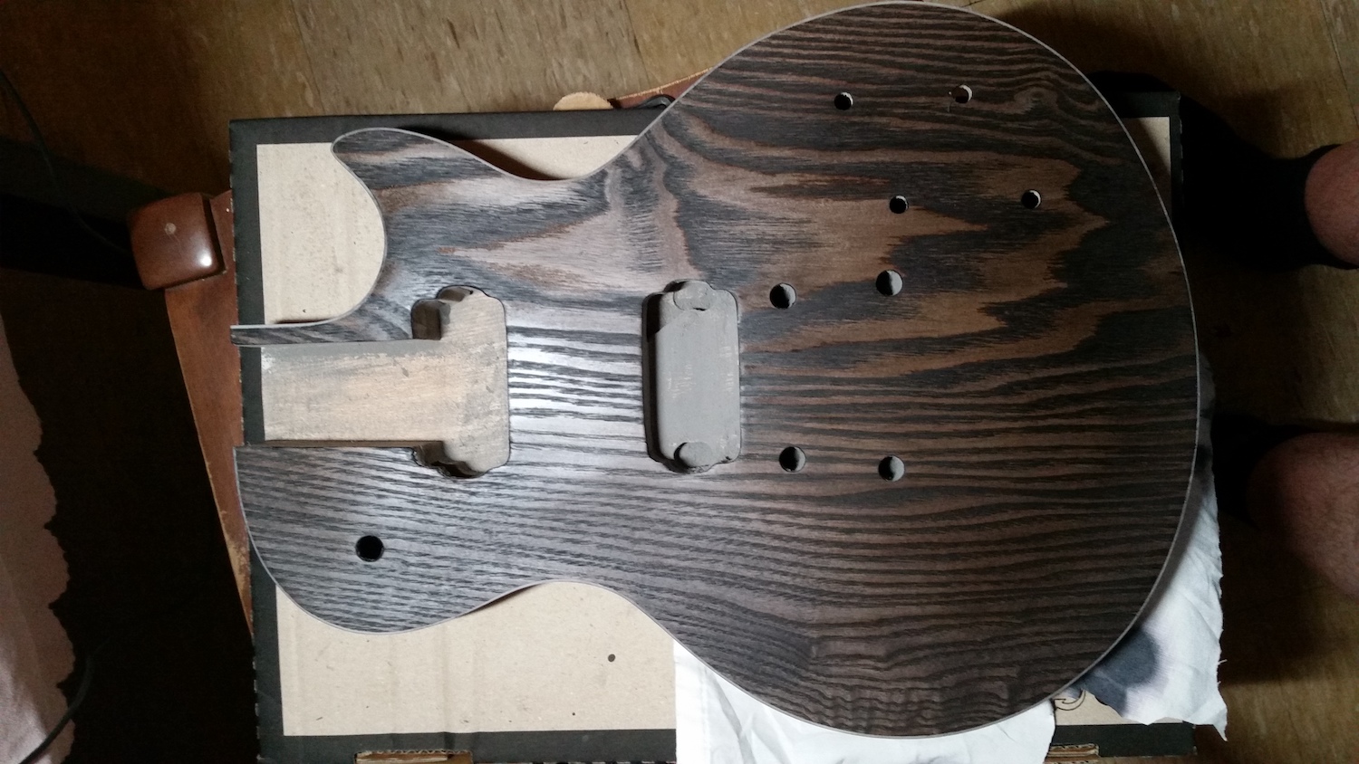

Right - Back to where I was, Thank god.
Im at the "DONT TOUCH THE DARN THING" stage now, while I wait for the finish to cure, before cleaning it up a little. Started scraping the binding but I might just leave it a little longer, so I dont cause any damage.
Still need to clean out the pup holes and stuff, but for the moment the face at least looks like it's back on track.
Attachment 14595
DM the grain has come up awesome. head stock is nicely finished as well.
Looking very nice.
looking fantastic, keep it up!
similar to what i was contemplating for my next build. nice job!!
you are correct, dont touch a thing, it looks amazing
nice work DM you really popped that ash grain nicely. Love the headstock too this should be a sweet axe
Wow man, that grain looks amazing. You've done a really fantastic job. (Retract jaw from the ground)

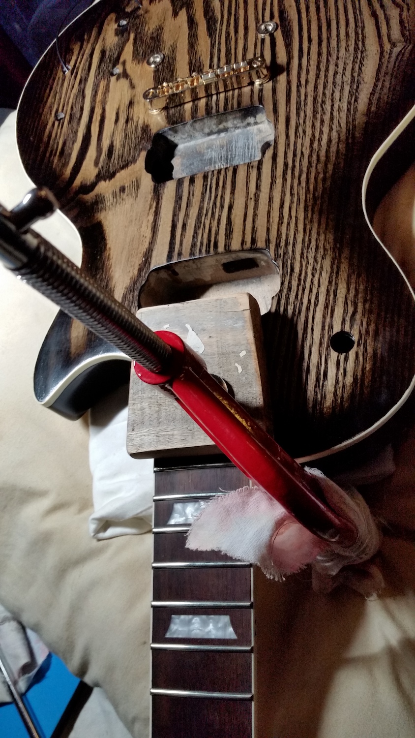

GLUING THE NECK...
Omg... Gluing the neck...
Measured... Measured again.... I measured it again. And again. 2 Different rulers.
Angle? Yep- That's right. It's straight, It's the right length... Omg.. Im gonna glue it.
... Crap... is that too much glue? Crap... IS THAT TOO MUCH?
... is that ENOUGH GLUE?!?!??!
.... Toothie brush in hot water!... Is that water too hot? DOES IT FEEL HOT!?!?
(As you can see, Im gluing my neck in....)
Attachment 14811
Looks like you took all the necessary precautions! This is going to be a killer axe.

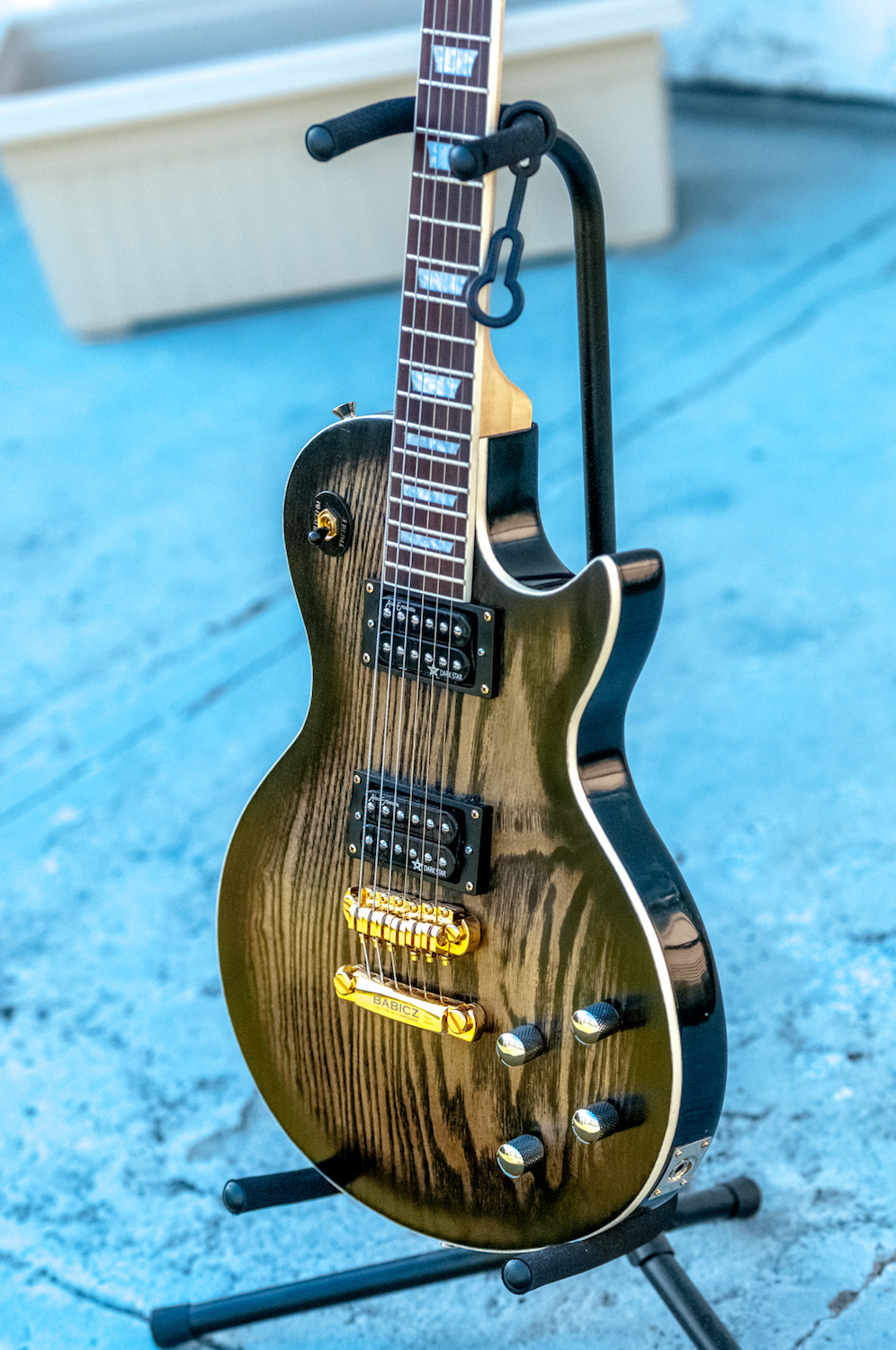

AND SHE'S DONE!
SOUND DEMO RECORDED (Please don't laugh at me - Im still a learner!!)
My Soundcloud Demo of me fiddling with my new guitar
Recorded Entirely on this guitar (drums and bass obviously not of course)
Finish
Dingotone Blackstump / FW Black Japan burst
Dingotone Top Coat
Black Acrylic side and back
Automotive clear coat side and back
2 Coats Tru-Oil for the Neck - Neck finished matt for speed.

Headstock
Inlay-sticker Headstock, Hand trimmed face
Grover Locking Mini Rotomatics

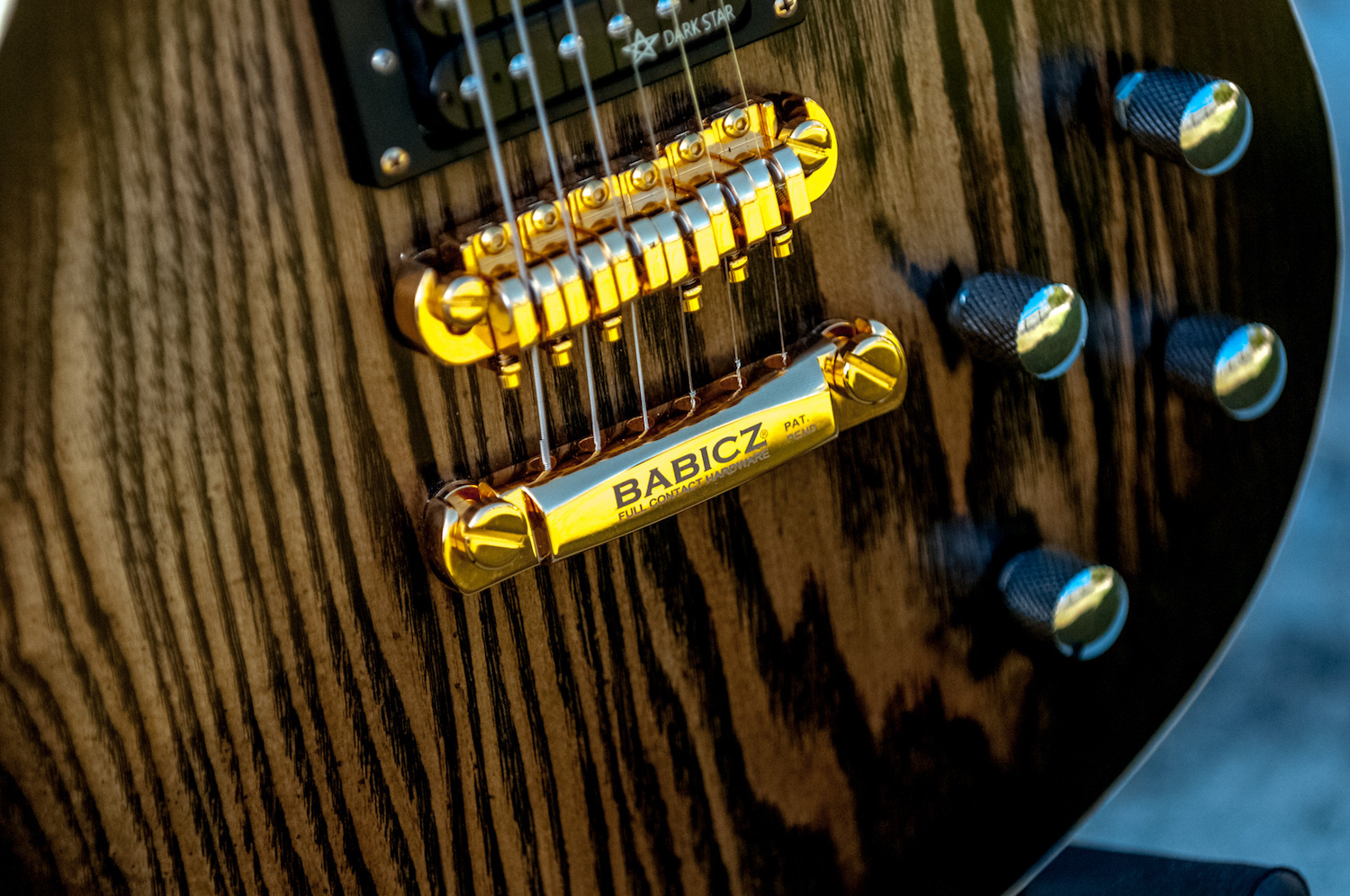

Babicz FCH Tuneomatic Gold

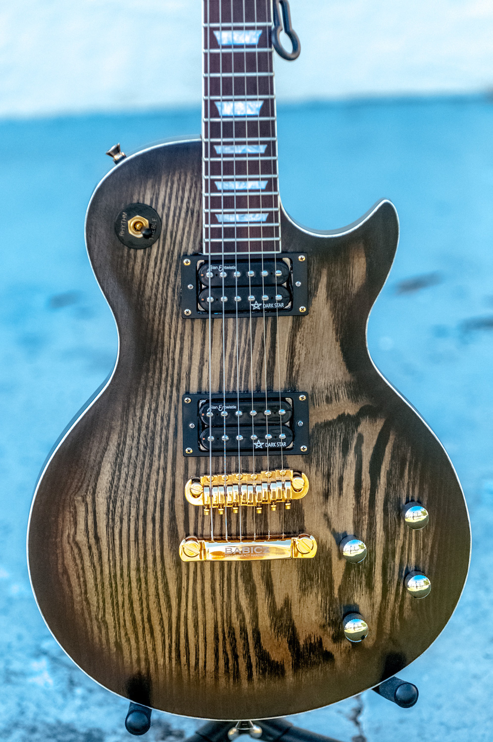

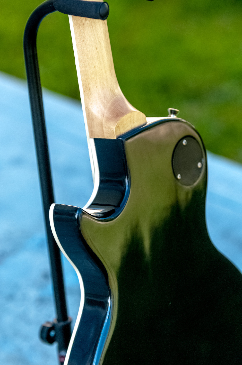

Some modelling shots - I'll get more later on...
Attachment 15130
Attachment 15131Attachment 15133
Attachment 15134
You have done an outstanding job, what an awesome guitar
Dude! Get that in the GOTM. That's a ripper!
