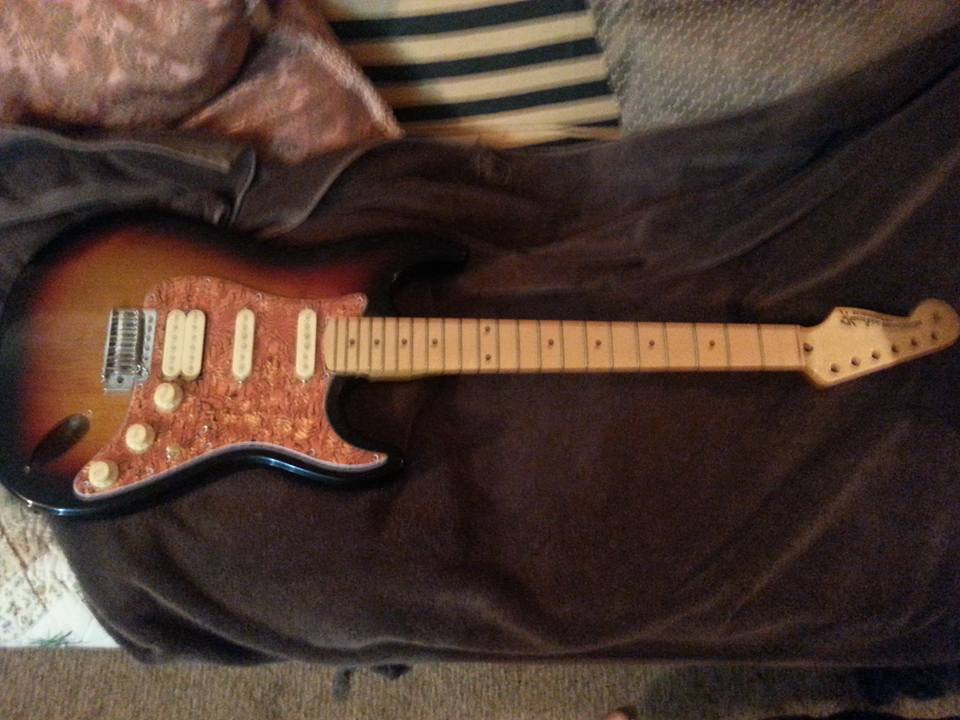

Started staining

I really like the grain highlights on that body. should look even better with your purple colour scheme laid on to it!

3 coats of "Joe's vintage amber blend" and the neck is to my liking will start tru oiling after i put the custom inlays in material should arrive in the coming days.

Outlined the edge with another coat of black will try to sand a smooth transition tonight or tmro

Coming along well Joe. With the fret dot markers get some similar color saw dust to the fingerboard, mix with CA glue and fill in the gaps. Let it dry and sand off. Try going over the burst edge with black again. Looking at the earlier burst pic you need a darker black stain. It looks grey

8 (extremely thin) coats of tru oil and the back is starting to shine.

First coat of TO on the headstock.

Sexy Magical things happening with the fretboard.

Roller nut BAM

Nice roller nut Joe. You may need to adjust the height once the strings go on
Looking good Joe. what tool do you use to cut those inlays?
http://uploads.tapatalk-cdn.com/2016...193e0b70d4.jpghttp://uploads.tapatalk-cdn.com/2016...5240939765.jpg
And then just drilled the existing inlays with a 6mm hand drill and the side inlays with 3mm.

Final curing of the front and sides of the body and back of neck.

Hey guys haven't updated in a while here's a pic ofbwhere i'm at got it all put together and today im gonna do the soldering and string it up.

ok she's wired up and roughly dialle din gonna wait for the neck to settle before i do anything else but all the electrics are working sound is good. One little mistake is that the pickup selector is upside down, but it is wired correctly so not that big of an issue.
