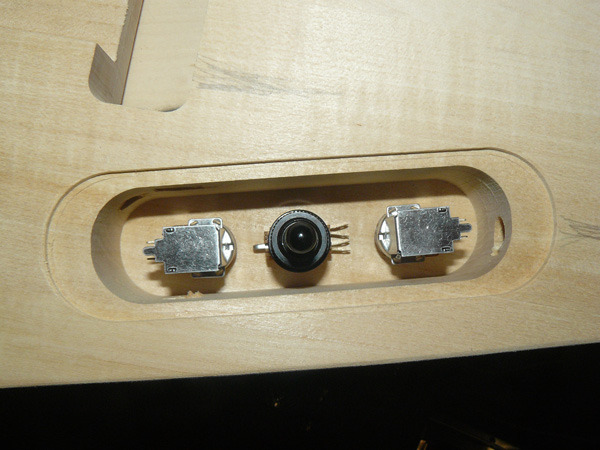

copper covers for the switch cavity and the trem cavity, done. :D This is just thin copper sheet wrapped over the existing plastic covers. If you heat copper then drop it in a bucket of water it becomes soft, I did most of the bending here with my fingers then just tapped the edges with a plastic hammer to close the fold. They are now soaking in a mild solution of cold gun blue. Cold blue makes copper go a warm charcoal black, its a delicate finish on non-ferrous metals so it will need a clear matt coat on it. Of course if you use it on steel it goes blue/black and is quite tough.

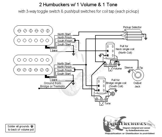

I have this diagram
Attachment 11372
but my toggle switch has 4 terminals not 3 as shown in the diagram
Attachment 11373
what am I missing?
The inner two are your 'out', so link them with the wire to your master volume. The outer two connect to the pickups, and the lug on the other side is the ground.
