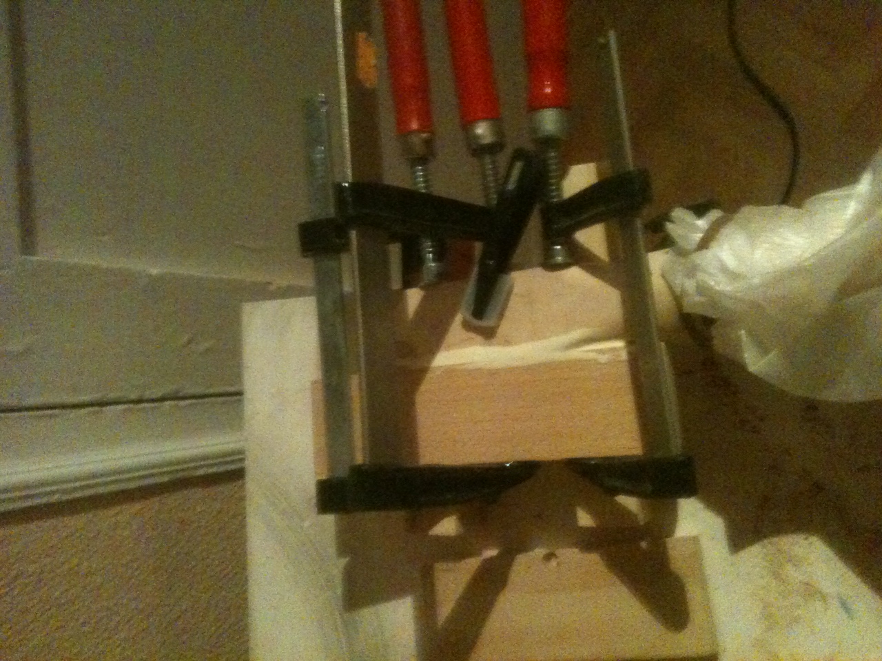

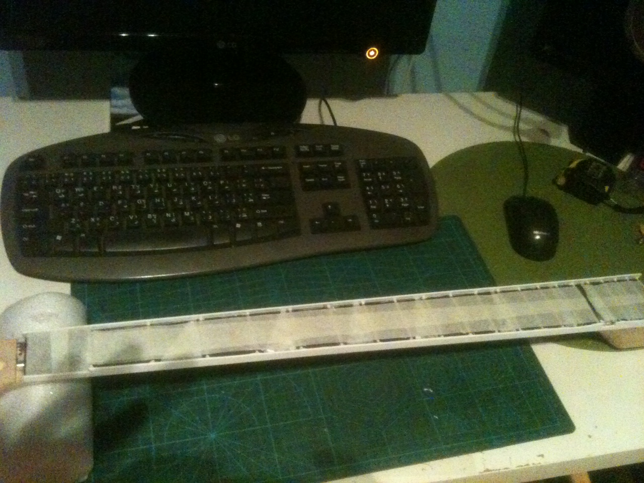

Finally, i get some steel bar from a walmart kind a place here in Europe, to make a cheap fret leveler, but before, lets make the truss rod hole so i can straighten the neck a little more.
I think a single hole is just than enough. 13 mm drill bit, quick and easy, key fits well, ok its done.
Attachment 8295

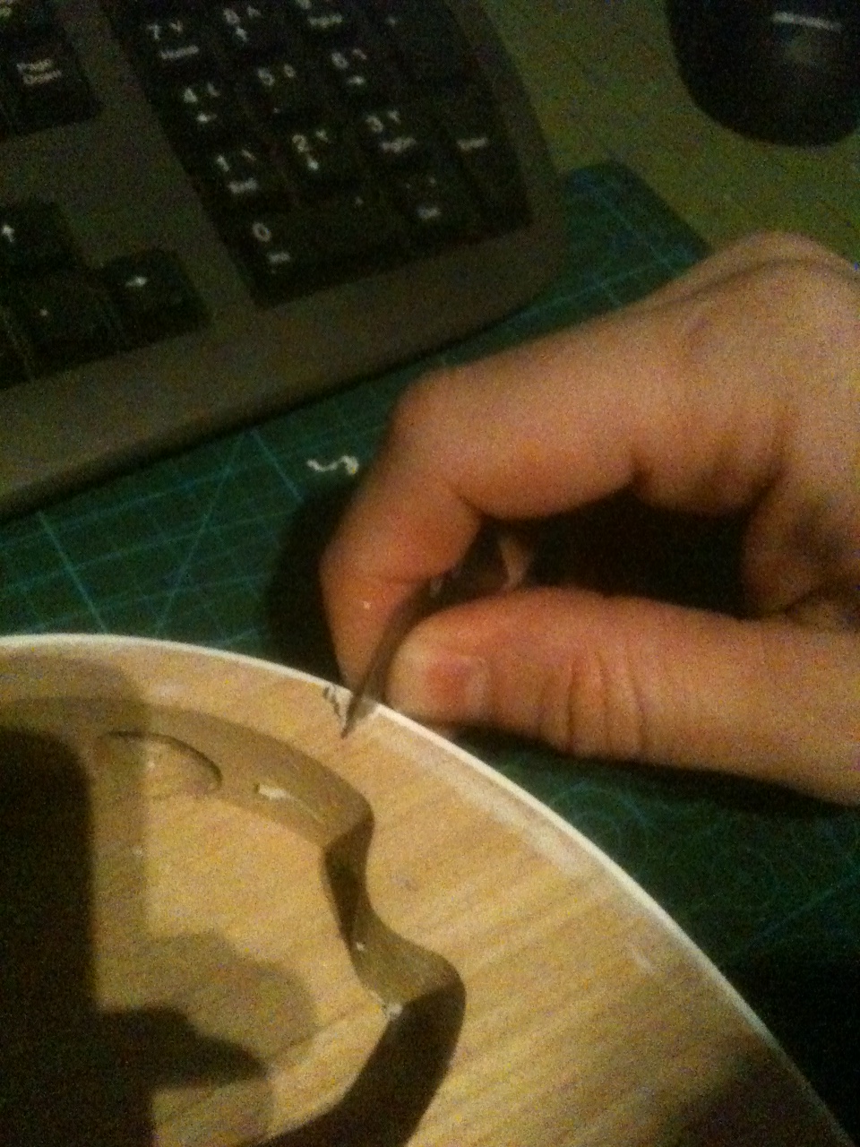

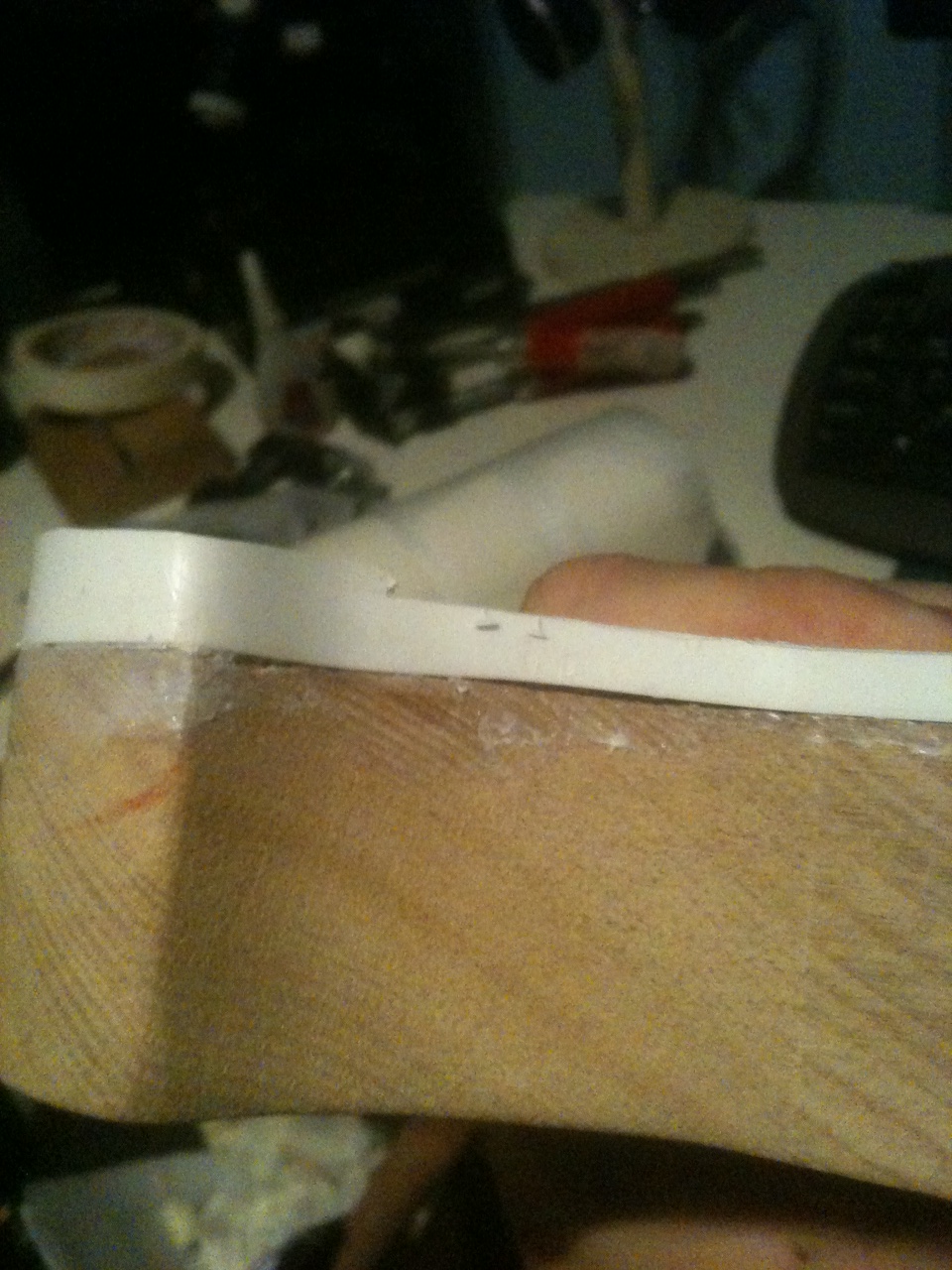

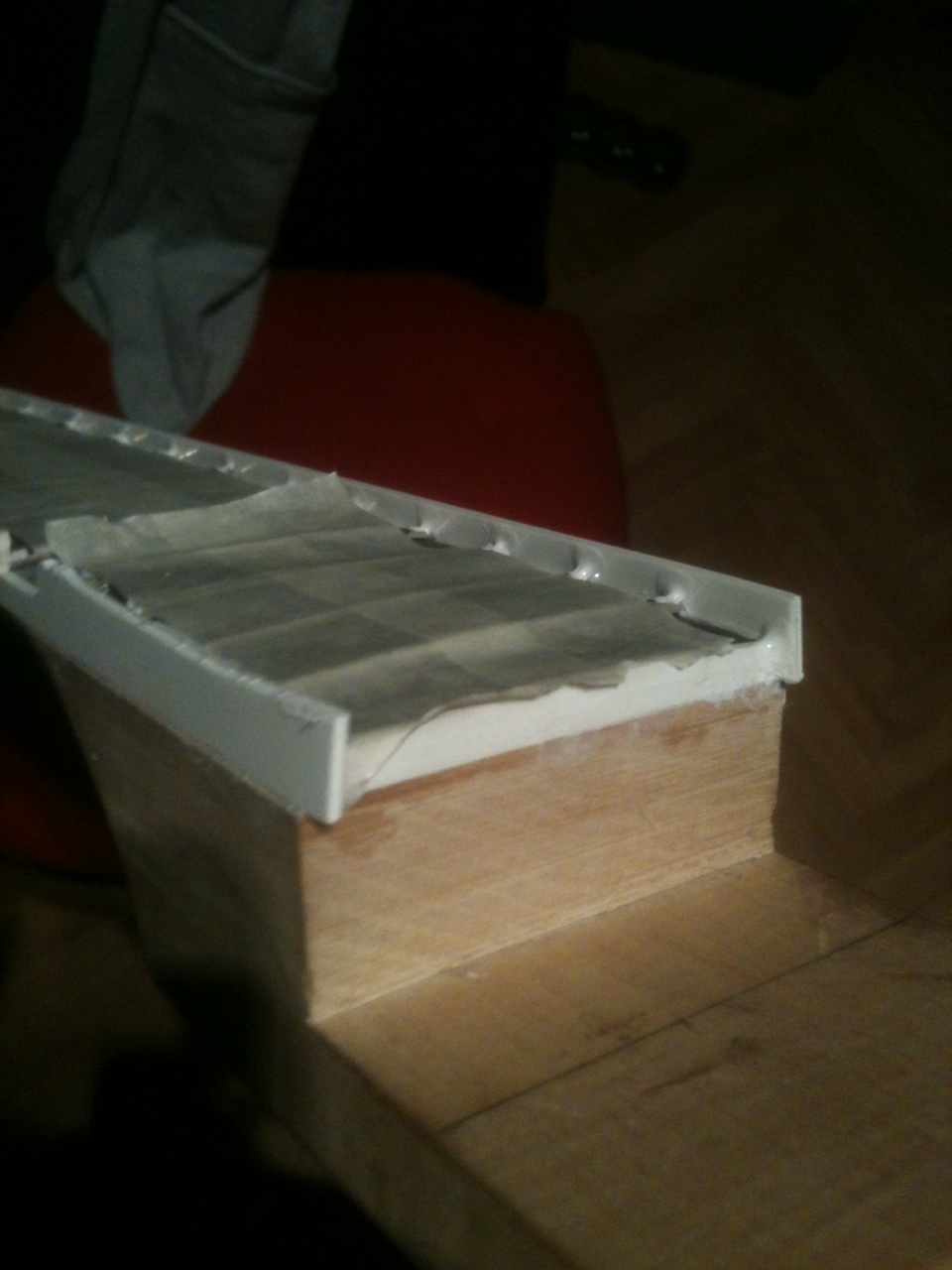

I started to binding out the entire guitar, using the acetone/binding cement mixing, and for me its the best method.
Attachment 8297
Attachment 8298
Some wood filling or maybe binding cement refilling...not a problem
Attachment 8299
Attachment 8300
I tried out the CA gluing, but a few spots on the wood, make me change my mind..

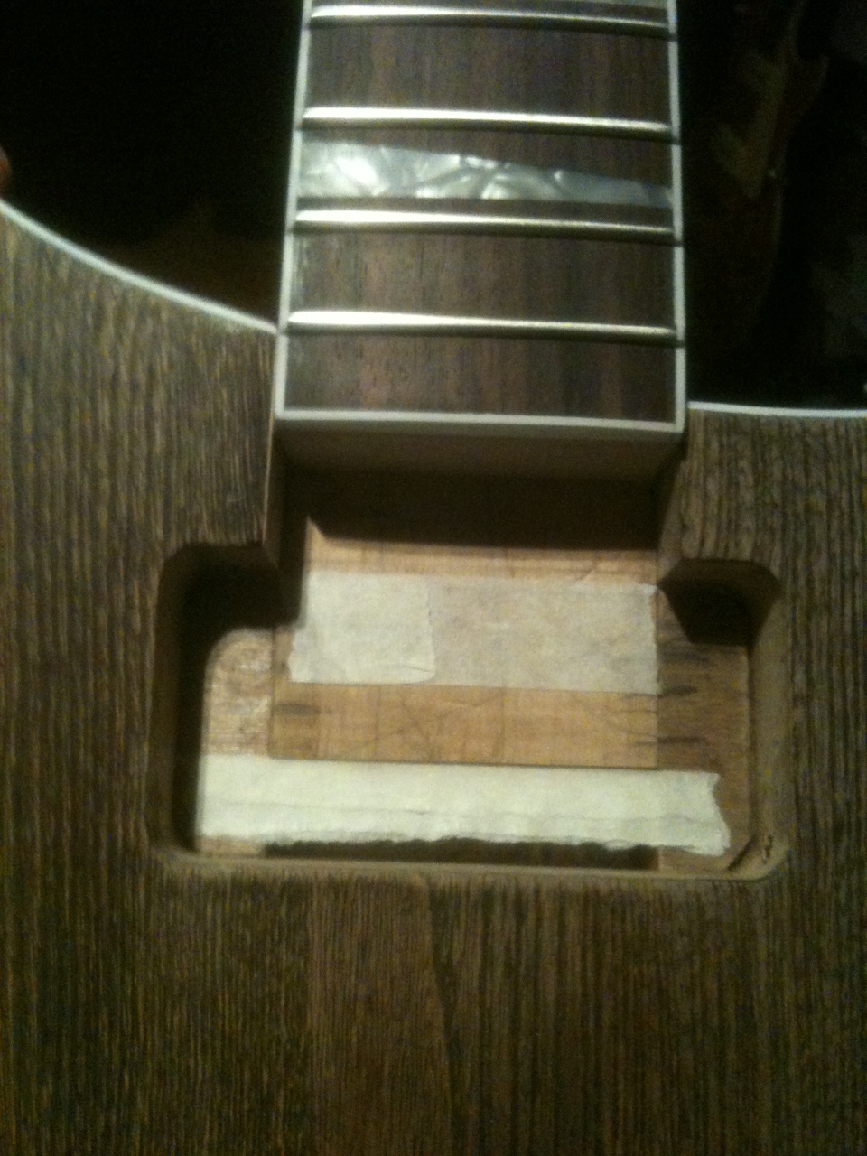

One question a have about the set of the neck into the body..There is almost a nice fit but needs to refill at the end just a little to be perfect...
Where its supposed to be better? On the sides of the neck joint or body cavity? I've read about two ways in diferent threads, but i think i would get some more stability from neck joint reinforcement, right?
S!
Hi Sansan
I'm not sure if I understood correctly but do you mean that the neck joint fit is not perfect?
When I built the RC-4 my neck heel was just a bit angled for maybe 1mm and I just took a sanding block and sanded it straight. Some builders have reinforced the neck joint by either putting blocks of wood on the sides/deeper cavities next to the neck or one poured some kind of epoxy or something to fill the sides. When I sanded the neck to fit properly to the pocket - I didn't do anything but glue the neck in place. Mine has been secure in place and so far no signs of bending on the back of the body or twisting on the neck (7 months). But I understand if one wants to make it stronger just in case cause the thickness of wood between neck and back of the body is quite thin. If I did it again now I would propably do the same myself.

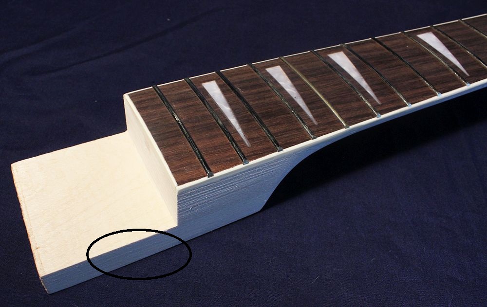

Hi Arzi, thanks for reply.
I mean, the sides of the neck when meets with the body hole is not tight, so the neck just move from left to right making some angle due the tiny space between them. This can make some confusion when placing the bridge on the right position.
Maybe regular gluing do the trick, but i prefer to have a perfect match that keep the neck and body together without any glue..
There is a little gap (0.4mm or less) between
Attachment 8602
and
Attachment 8603
Ok now I understand and you're right - the fit should be snug so the area that is glued would not get to move. I'm not sure if and how well to what point this can be solved with just applying enough glue - will it do the trick. If there is too much gap it would need filling. Now I don't have the expertise to give advise on how to do this. Hope the more experienced guys like DB and others can help you. I'm also interested to hear what methods there are.
The answer might be some glue that would not shrink too much and would fill the gap at the same time while you clamp the neck in place.

0,4mm doesn't sound too much and when you divide it it's 0,2mm per side. Now I think this is a gap that could be filled with just glue but I'm gonna let someone else give their opinion too.

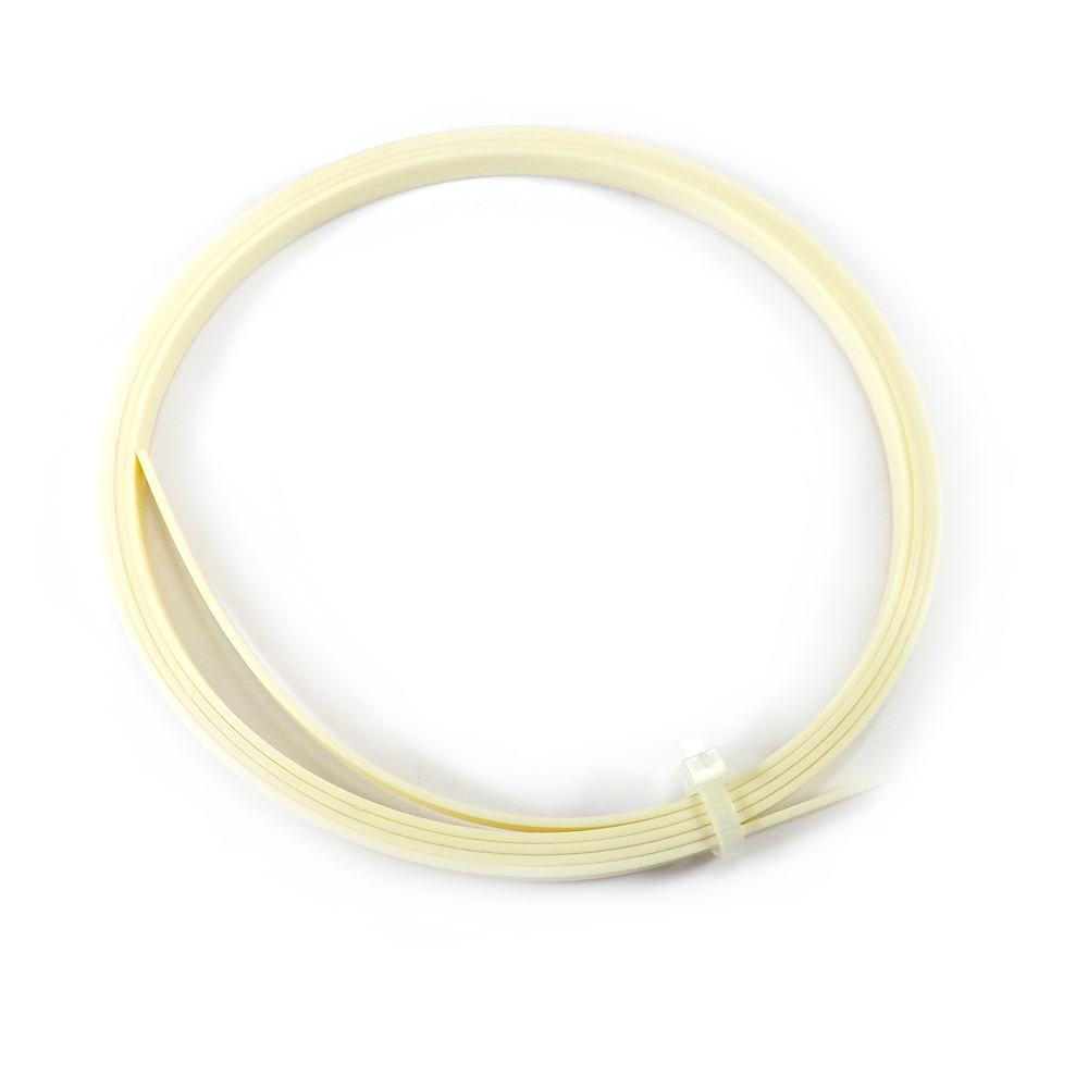

Hi muxo, the kit comes all bound. i changed it because i want it in white color to match with the inlays. REmoving the binding was not easy, plus, there so many parts in neck and body that rip off some wood, so have in mind to fix the channels for the new binding.
I barely remember, but it reminds me more like an ivory...
Attachment 8613
definitily not as cream as
Attachment 8614

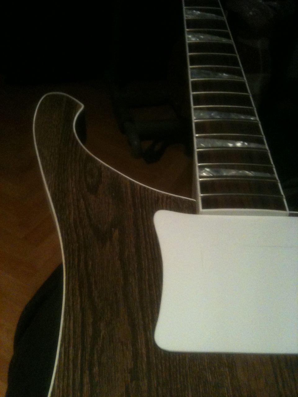

I've been busy giving some minimal touches, reshaping the new pickguard, filling and setting the neck joint (now it fits perfect), and deciding/researching for the finish that will be a black satin oil finish..so, let the masters speak..
This is what a want to achieve without using any spray can..
http://guitarampboard.com/forum/view...=16555#p319836
I used ebony grain filler at the top, but i'll not use on the rest, i want to feel the grain a little more..
I finally decide to stain the bass with speedball superblack indian ink (purchased on ebay), then finishing with my own blend of wiping oil poly, due the overprice products i've found on ebay (wipe on poly)...since i found this...

Lets update. I dont have much time for working on the bass, so i've been doing little things from time to time..
First, close pic of the Gibson type nibs of the fretboard...i like this way than regular fretwire finish.
Attachment 9479

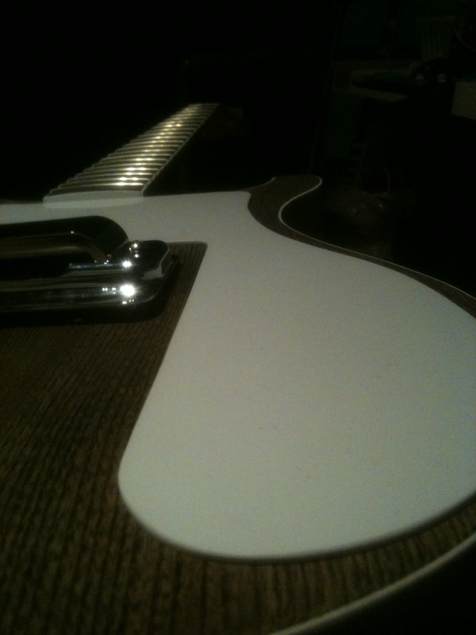

I've make a new pickguard, from 3 ply white sheet and waiting for the wiring (incoming from banzaimusic in deutchsland)
Attachment 9480
Attachment 9481

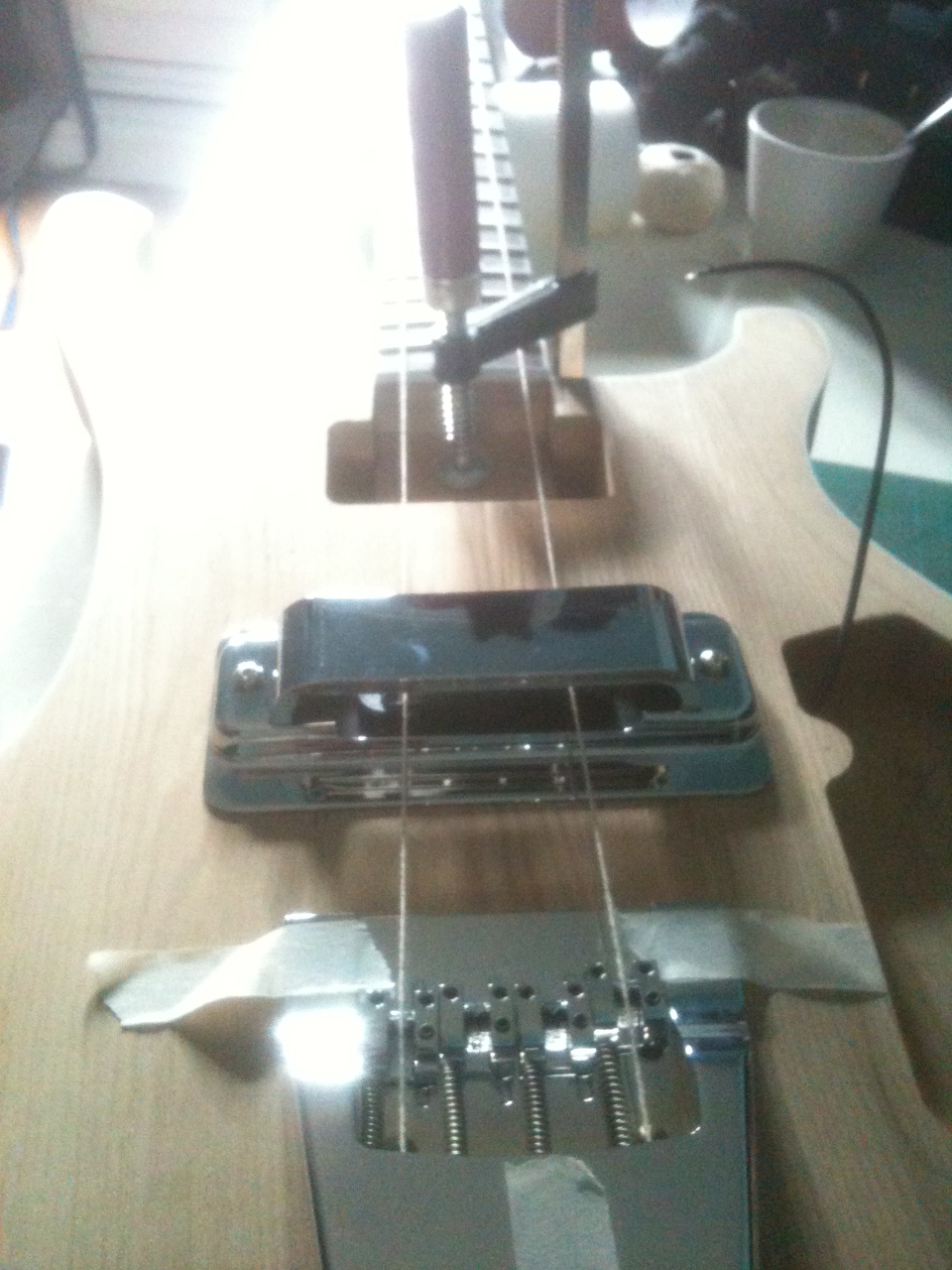

Setting the neck for the glue stage..It fits almost perfect.
Attachment 9483

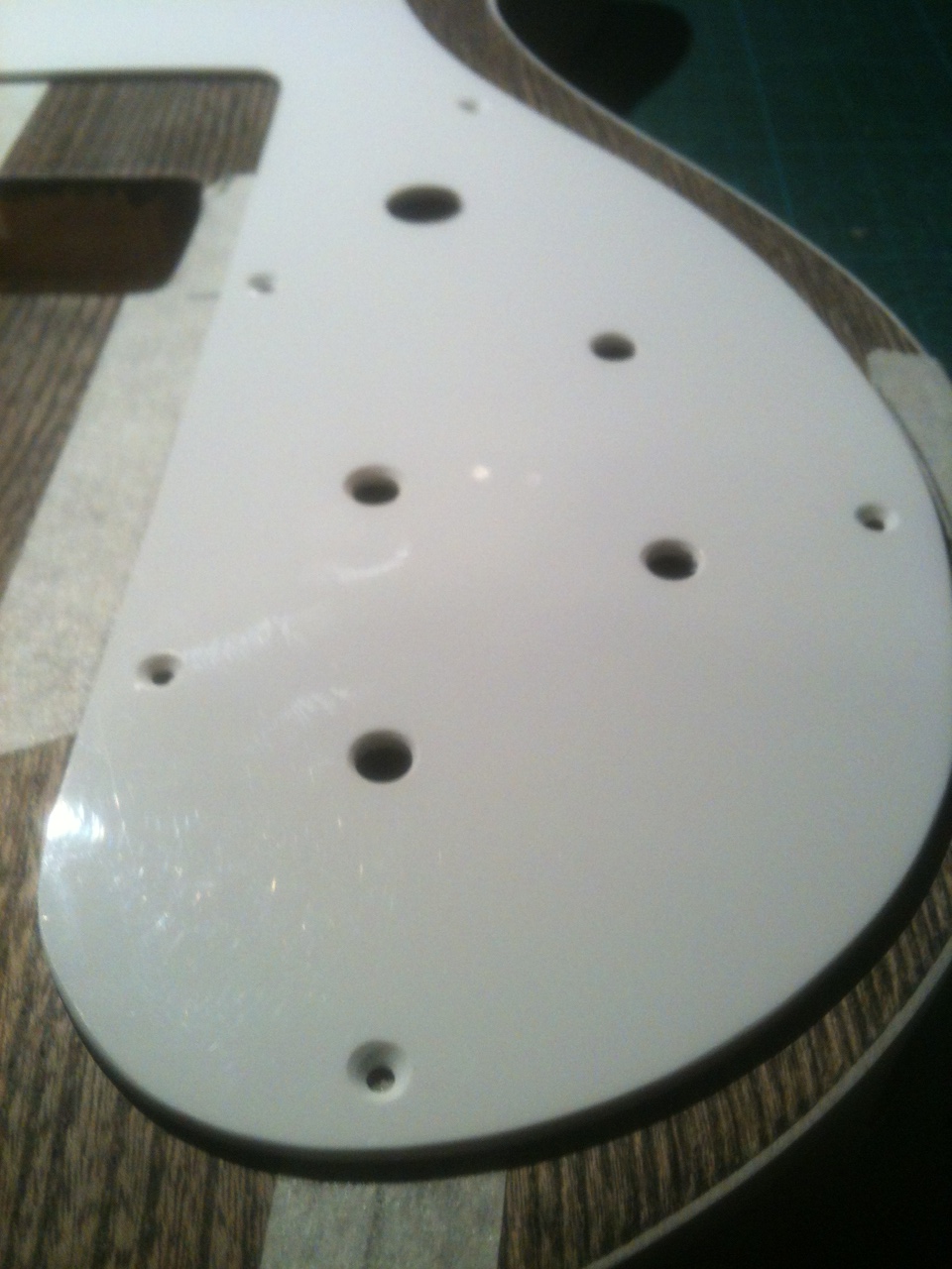

making some pickguard holes, and final touches to the pickguard sides. Only lefting pickup cavity and polishing.
Attachment 9513
Attachment 9514

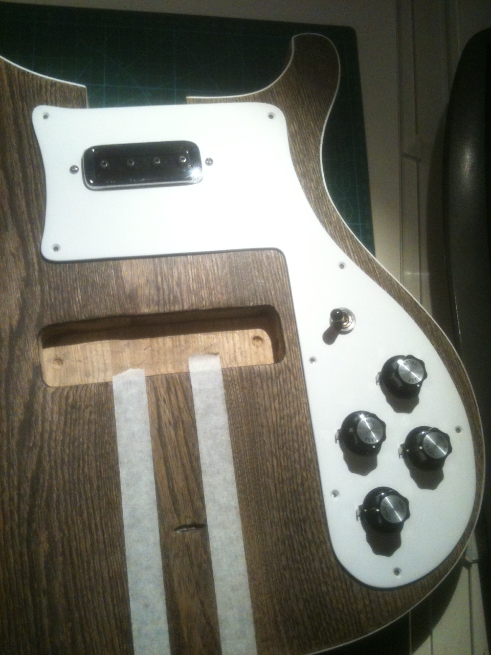

Been very busy at home..Being a father its time consuming but...you know, the first is the first...
Some progress around..

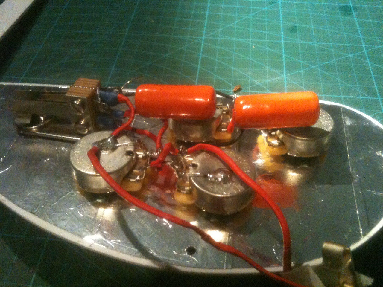

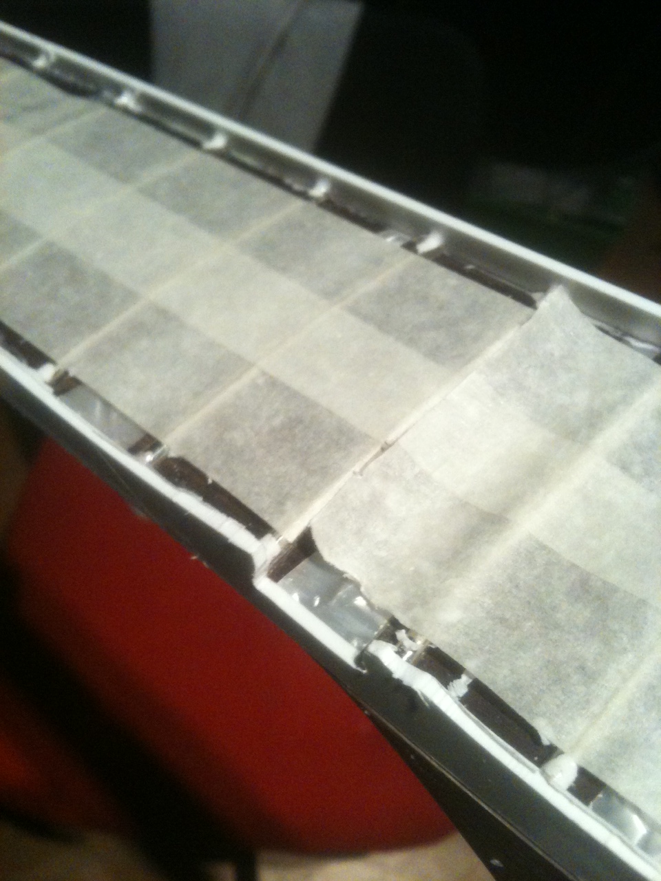

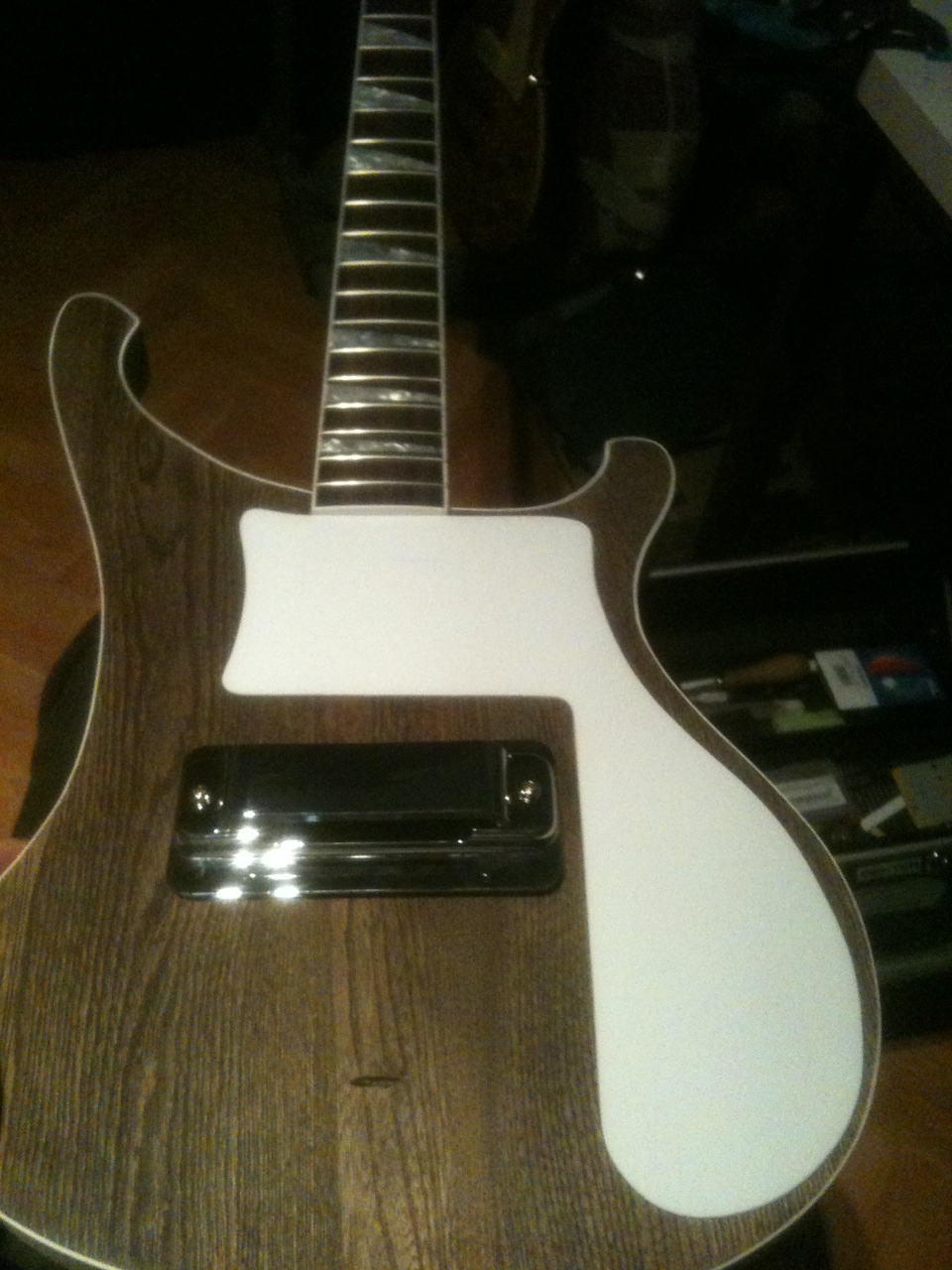

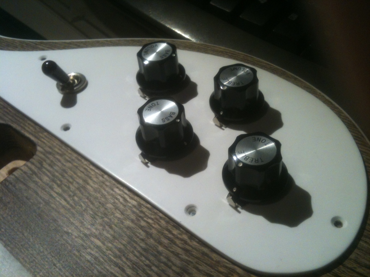

I've finish the pickguard and installed the electronics...because of the shielding theres no need to ground pots to switch but its ok.
-CTS 500k (linear/V and log/T)
-Sprague orange drop 715p 0.047uf
-3 way switch remain from another previuos project
-All parts rickenbacker style knobs
-4 pointer washers
-neck pickup cavity aligned and installed and shield job finish.
Attachment 10523
Attachment 10524
Attachment 10525

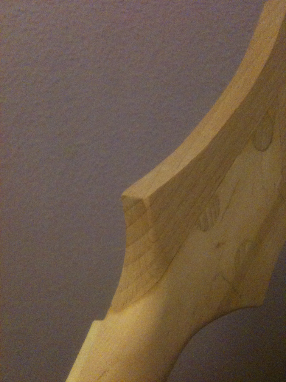

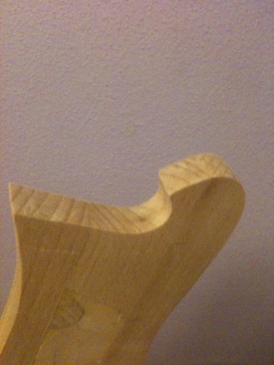

Anyway, there is 2 ways i've been thinking about.
Considering the width of the body is 40mms, and the joint tenon 15mms, One is sawing the body in two pieces making the side wings and gluing a long maple blank to simulate the thru neck (not my favorite, too much work for hand tools)
Another will be glue the neck to the body and then carved out with a router bit, along the back side of cthe body keeping the width of the neck all along with a thin maple blank (15 a 20mm). This will be cover the back side of the thru neck.
Next, will rest to carve out the top side for the other 20mms blank and glue the top maple blank all along to make a solid one piece with the two..
Finally will rest to carve out the pickups cavities... all of that requires extreme measurements, patience, time and some help from supernaturals divinity.

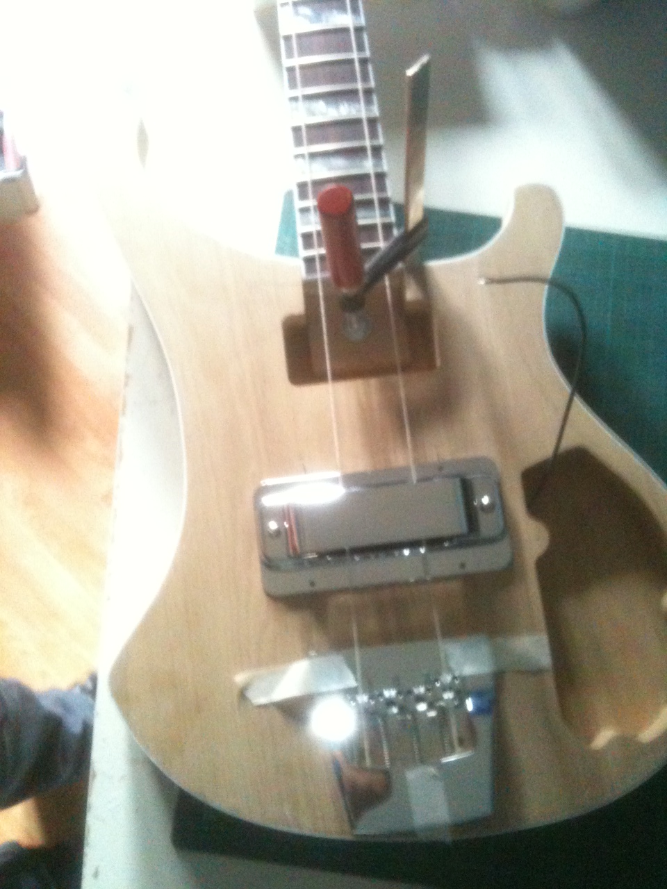

I had to routed 3mm for the bridge installation. A little bit of high action seen in the mock build so...dremel...heres your turn..again!
I decided to routed the cable room from neck pickup, due the complexity to solder to pots. I did it in my drill press, as I have seen on some original basses.
Here are the pics, not good quality sorry.
