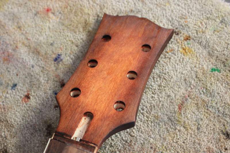

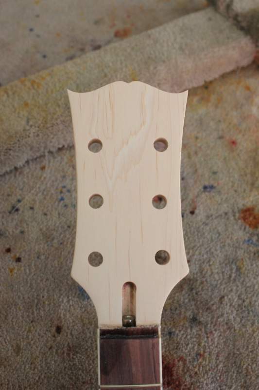

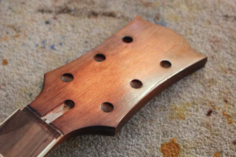

Finally got the headstock shaped this morning. It's always the most nervous part of the build for me (TBH any woodworking is a worry) but now all the woodworking is done!

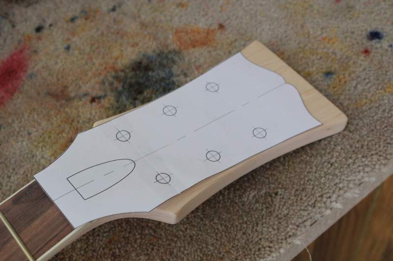

As usual, I used the LP headstock template from here: http://www.australianlespaulforums.c.../Headstock.pdf.
Also as usual, it didn't quite fit the blank, but I just shifted it up until the sides met.
Attachment 930
Attachment 931
A bit or work with the jigsaw, the bastard file and slapwheel and she was finished. I even managed to not knock off one of the "wings" with the file this time - bonus! I'm reasonably happy with the results. It's one of my better attempts with this template.
Attachment 932
I'm thinking of doing a gloss black headstock with the neck stained the same colour as the back and sides of the body. Not sure - my plans always seem to change.
nice shape headstock Gav, its got some sick grain but black face with same colour neck should look excellent
Like that headstock.....nice wing tips. :)

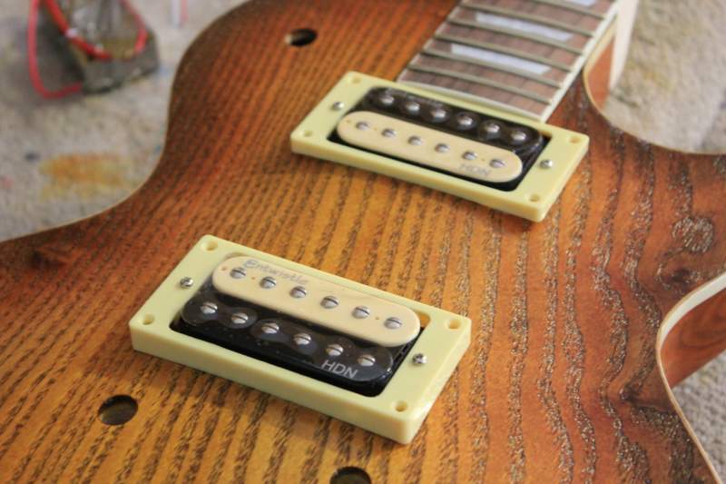

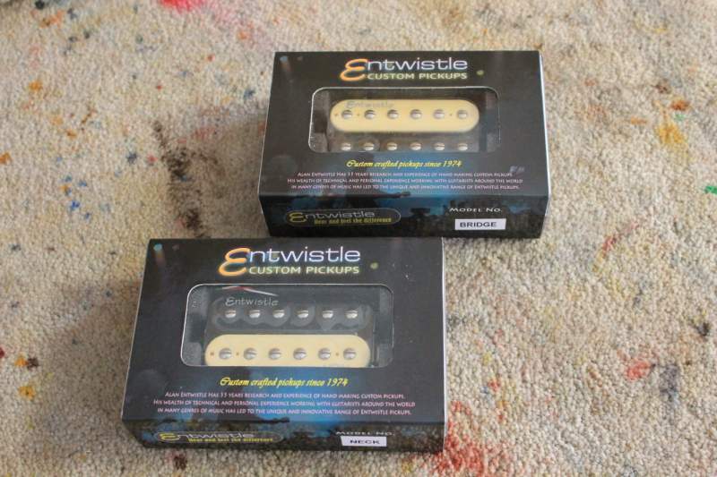

Today I received a pair of Entwistle HDN Zebra Pickups for my Ash Les Paul project from Ads. The HDNs, which utilise Neodymium magnets, promise an "ultra hot" response giving note definition, crunch and tone that's perfect for rock and metal. Mmmm metal..
Attachment 947

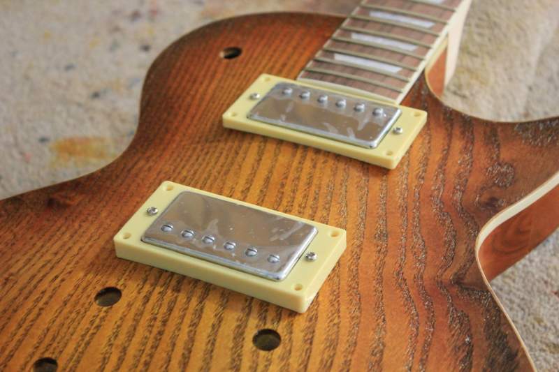

Initially, I had planned to use the original cream humbucker rings that came with the kit to mount these new zebra pickups. Here's how the stock chrome humbuckers look with these cream rings and the 10-coats of Tru-Oil that's currently on the body...
Attachment 948
Attachment 949
And now with the zebra HDNs in the same cream pickup rings. What do you think? Do the zebra's look better or worse? They certainly look more "rock" to my eyes - and that's a good thing!
Attachment 950
Attachment 951
The only question now is the pickup rings themselves. To be honest, I'm not sure that I'm really sold on them anymore. The cream in the rings is a little more "yellow" than the zebra cream (Mmmm zebra cream), and this lends them a more plastic, cheaper look. I'm thinking that either black or chrome rings may look better in this situation, or maybe I should just buy some AllParts Cream Rings to replace them? What's the consensus on there amongst forumites?
Yeah, the stockies don't look quite right. I think cream rings will still be the go, but it's tough to get cream plastics to match even when they're from the same source. It wouldn't hurt to have a look at it with black rings though, as there's enough dark on the top that they may work.
I wonder how it would look if you 'aged' the stock cream rings slightly with some stain... teabags maybe.
Mmmm, oh baby! <drool> ... those zebra's do look especially delicious on the 'burst (excellent choice all-round!) - very, VERY Rock 'n' Roll!
Personally, I'd definitely go the cream - it so matches the binding 'round the edge of the body and fretboard (where I think silver or black just wouldn't "fit" nearly as well)
... but I see what you mean about the slight colour difference between the two creams (from the pics, the p/ups seem to have an ever-so-slight pink cast to them whereas in comparison the rings are slightly more yellowish)
But either way she's gonna be one sexy beast!
Side Note - Don't know if you've read about the concerns regarding NeoD p/ups ... (and I don't know if I buy into that much myself, but ...) some sources seem to think that the Neo-D's noticeably reduce the sustain of the guitar (supposedly the extra strength of the magnets, provides more "pull" on the string and thereby reducing its ability to vibrate)
... now, whether its that noticeable or not I think depends on a number of factors, not all of which are with the p/up ... the theory certainly stacks up but having put some hot Entwistle Neo-Ds on my "scrapper" ST-1, I certainly haven't noticed the effect myself ... but then they are only single coil ... maybe you might find it more noticeable with the 'buckers ... be interested to see what you think when she's finished
... but sustain-effecting or not, they do give a really great sound! :D

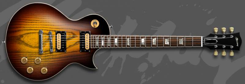

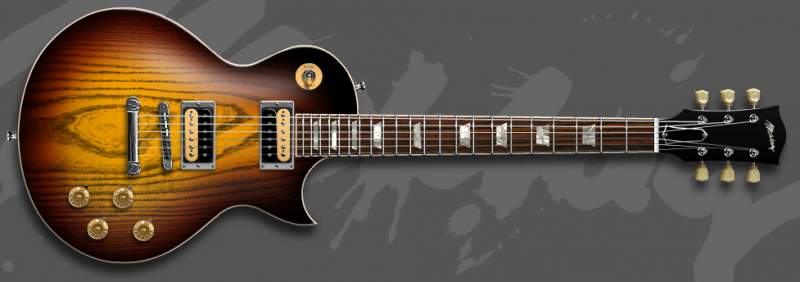

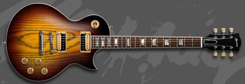

Ok Gav, 2 things. Here is a picture of the realtone pickup surrounds, I think they will be pretty close to the zebras. The stock PBG pickup is housed in the realtone surround, I purchased these to go into my latest as I wasn't happy with the stock creaminess. Zebras rock, I was thinking going some, another project.
Go to this website and put in your guitar colour scheme and then change up your pickup surrounds etc for a quick look.
http://www.frankmontag.com/editors.htm
Thanks Kane the Realtone rings look great. Here is the output from the tool. I don't think there is any doubt that the cream rings are the ones to go for. Both black and chrome choices just don't look as good!
Attachment 954
Attachment 955
Attachment 956
I like the middle pic, for me the black blends nice with the colour and the pickup surrounds almost disappear. Thats one nice guitar mate.

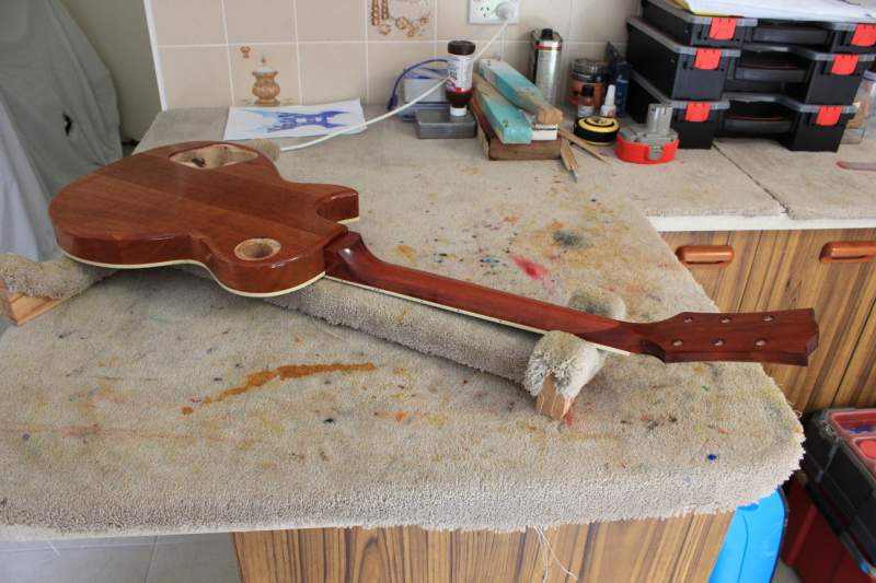

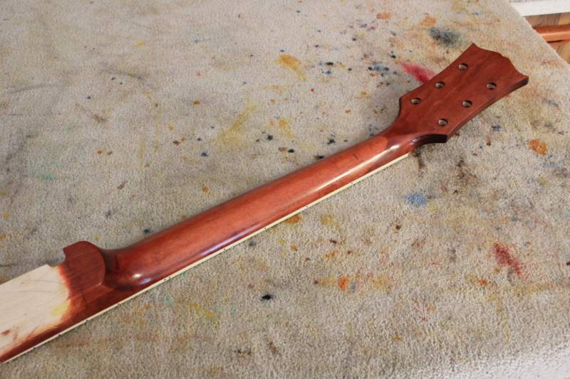

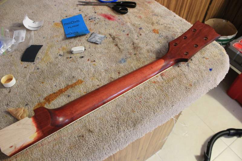

Today I got to spend a little of Boxing day on the build. That meant finally getting to sand and colour the neck and headstock. I used the same colour combination as on the body of the guitar - although the neck has taken the colour differently and ended up much more darker and redder. I still think it will work well in any case, even with a darker neck. I also attempted a small burst on the headstock. Not as good as the body but it's ok. If I decide it isn't good enough then I can always spray back over it later on ;). Anway here's how the headstock and neck looks with the soak coat of TO applied.
Attachment 968
Attachment 970
it's looking good Gav. I actually don't mind the black rings...

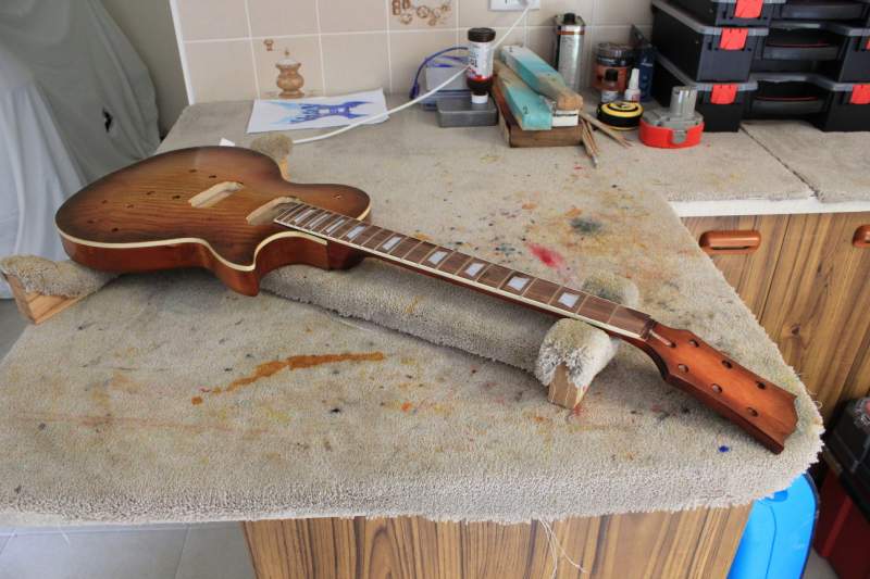

Thanks @Stan. I think I'll go with the cream as I've never gone this way before. Over the last few days I've been slowly building up he TO on the neck and headstock. I've got about 8 coats on there at the moment and have wet-sanded once with 600 grit. Will slowly be working my way through the grits to 1500.
Attachment 1048
Attachment 1049
The colour is a little darker then the body colour, but it's growing on me. I've also come around to the headstock burst - I think I'll keep it as-is.
Attachment 1050
Attachment 1051
A few more coats of TO and I'll be able to set the neck. I'm still waiting for my new pickups rings from Realtone, as well as a couple of electronics upgrades. In no time I'll be getting this baby assembled :) .
looks awesome Gav well done, keep the burst headstock for sure and I wouldn't worry about the neck/headstock being a bit darker, can't wait to see how it looks with the cream pup rings, think this will be a knockout LP and you might be getting calls from Slash to buy it !

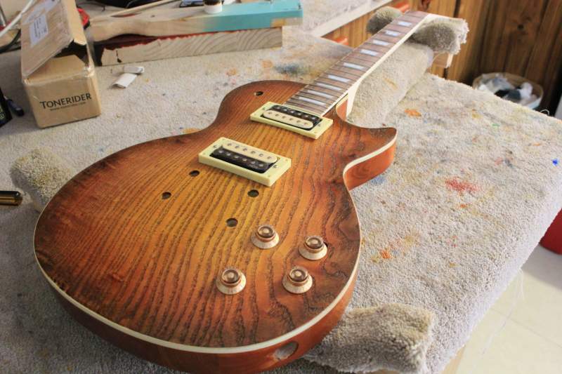

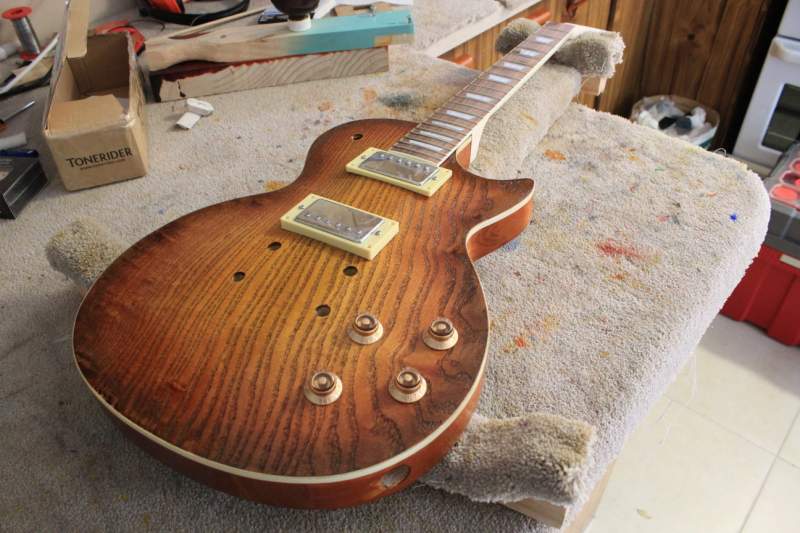

The cream rings from Realtone arrived today as well as some gold speed knobs. I'm now very excited to get this beast wired up. The cream rings match the Entwistle zebras perfectly.

Coming together nicely Gav.
real interested to hear this guitar sing.
looks choice as Gav, I won't bother entering GOTM February, I reckon you have it in the bag !
