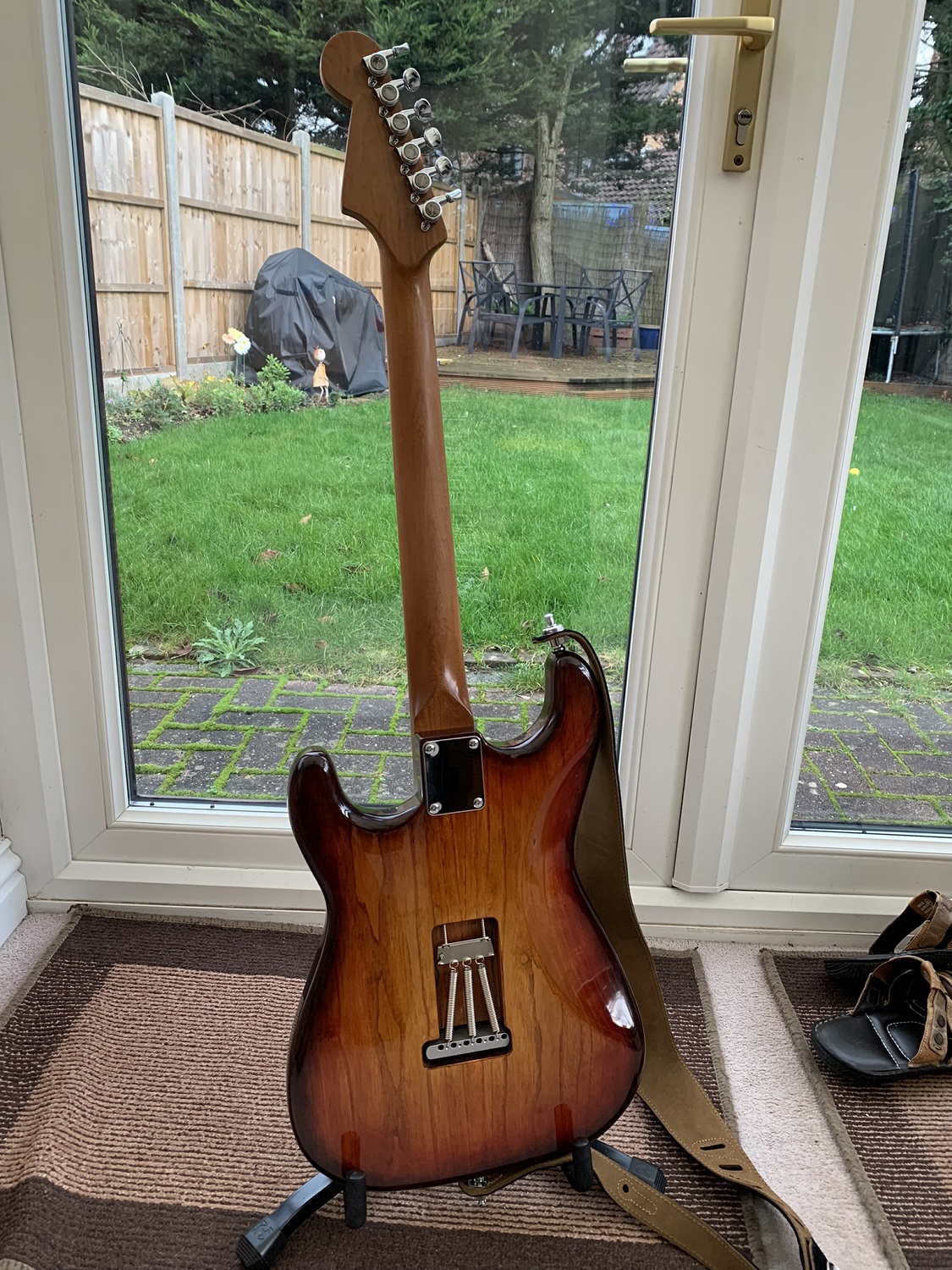

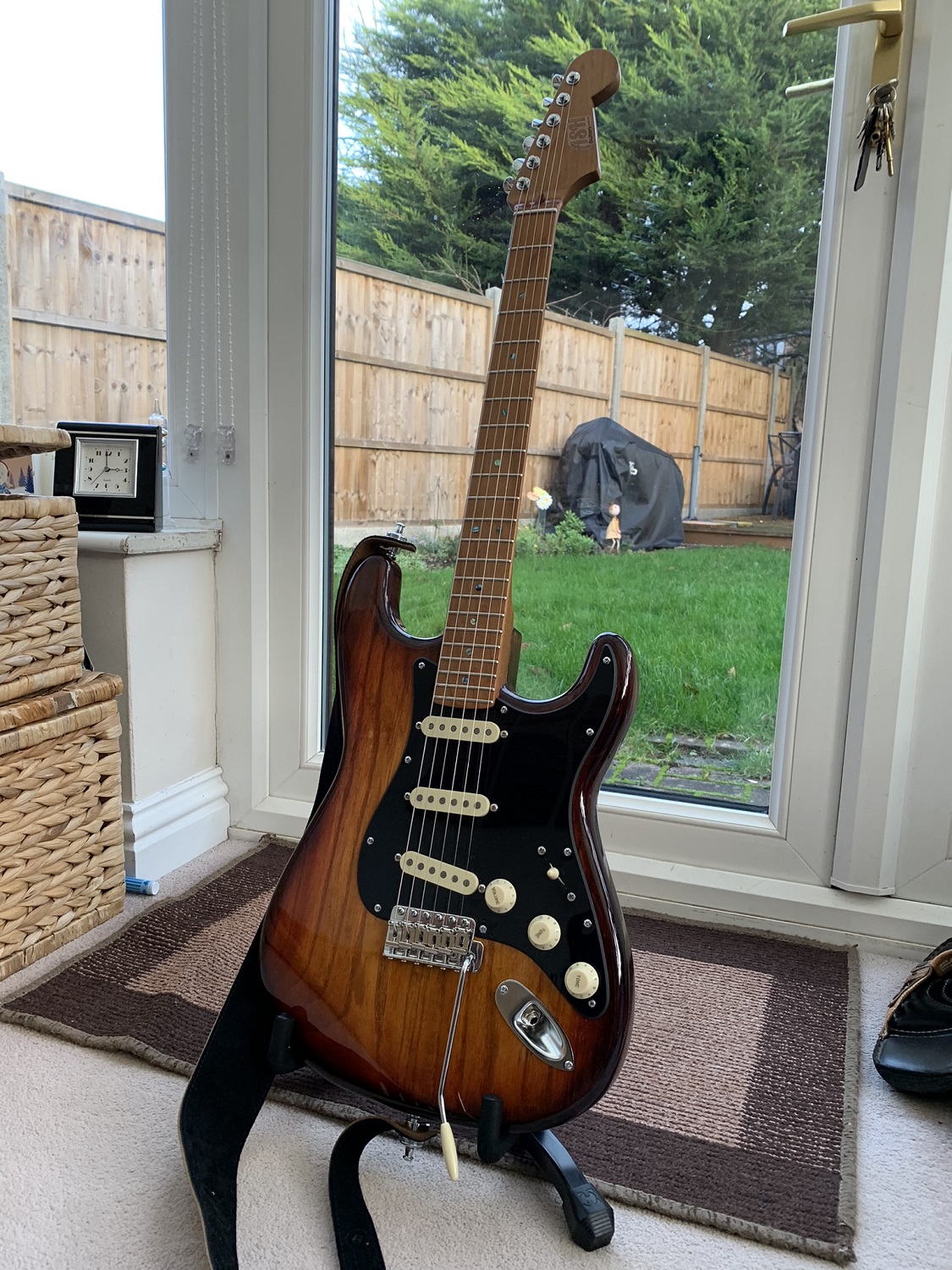

It's been a good while since my last update on this. Progress has been slow but this week I finally got it all together. The weather isn't great for glamour shots so this will have to do for the time being:
Attachment 42235 Attachment 42236
Of course, the finish is far from perfect. Applying the RPC with a brush leaves an uneven surface which is then prone to sanding through. And the nature RPC means that it's not easy to fix and any repair is quite obvious. But the biggest limitation is my skill level so it's just a matter of practice.
Assembly went okay. Although I narrowly avoided disaster when one of the bridge screws sheered off just below the surface. The bridge is a Gotoh so I thought I'd be safe. But it was my own fault; in an effort to avoid oversizing the pilot holes, I undersized it enough to make it too tight. I rescued it my drilling into the broken screw with the smallest drill bit I had. I managed to get right down the middle so I was then able to open the hole out the correct size, removing the debris as I went. Fortunately replacement screws were easy to source - so major lessons learnt without any major damage - I got lucky.
I enjoyed the wiring up process. I made a mess of applying the shielding to the back of the scratch plate despite trying to be really careful to avoid bubbles and wrinkles. But it's nice to have the majority of the soldering completely away from the guitar.

Over all I'm really happy with how it plays and sounds. The Monty's pickups (with the £££ cap??) are beautiful - not quite as hot as the Texas Specials I once had but they have loads more clarity and charm then the Fender Noiseless 4s I have in my Elite Strat. With a BE100 Helix model with a Klon in front you can a sweet sounding SRV type tone. Not that I can play like SRV.
I had to fiddle with the setup quite a bit but I think it's just about right now. It's my first time setting up a Strat from scratch so I spent a long time juggling with the relief and saddle height whilst keeping the float on the trem where I wanted it.

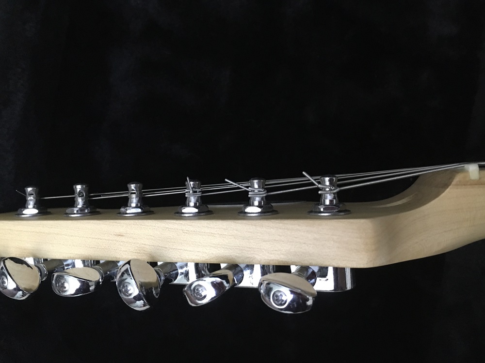

And +1 for string trees. Unless the nut slot bottoms are a long way from the headstock face, the break angle on the B and E strings is almost always too shallow for enough downward pull to keep the strings in place. The G string is often marginal, and I wait and see how it plays before fitting a second string tree. On standard tuners, putting enough turns on so the strings come off the bottom of the tuner post helps. Likewise, use staggered height locking tuners so that the G, B and E strings leave the posts as low as possible.
Even though you’ll pretty much always need to fit one string tree, the less it has to pull the string down by, the less friction generated by the string moving beneath it when bending strings or using the trem.
I have several strat/tele builds from my "early days" that have two string trees, but ones I've done in the past 4 years or so, I've been able to get away with just the B/E one (or none on my 2020 strat). I attribute this to just getting better at doing nut work.
I have contemplated redoing all the nuts on my guitars with two trees, but I've yet to get up the motivation to do it.
Plus it would involve plugging the old screw hole (which could lead me to refinishing the headstock because I'm a bit of a nut that way) and the reality is there are some guitars that you just need a retainer on the G no matter what. I find that confounding, but it is just the way it goes sometimes.

This works fine with no trees:

This is just a shameless exhibition of said guitar!
Attachment 42239
