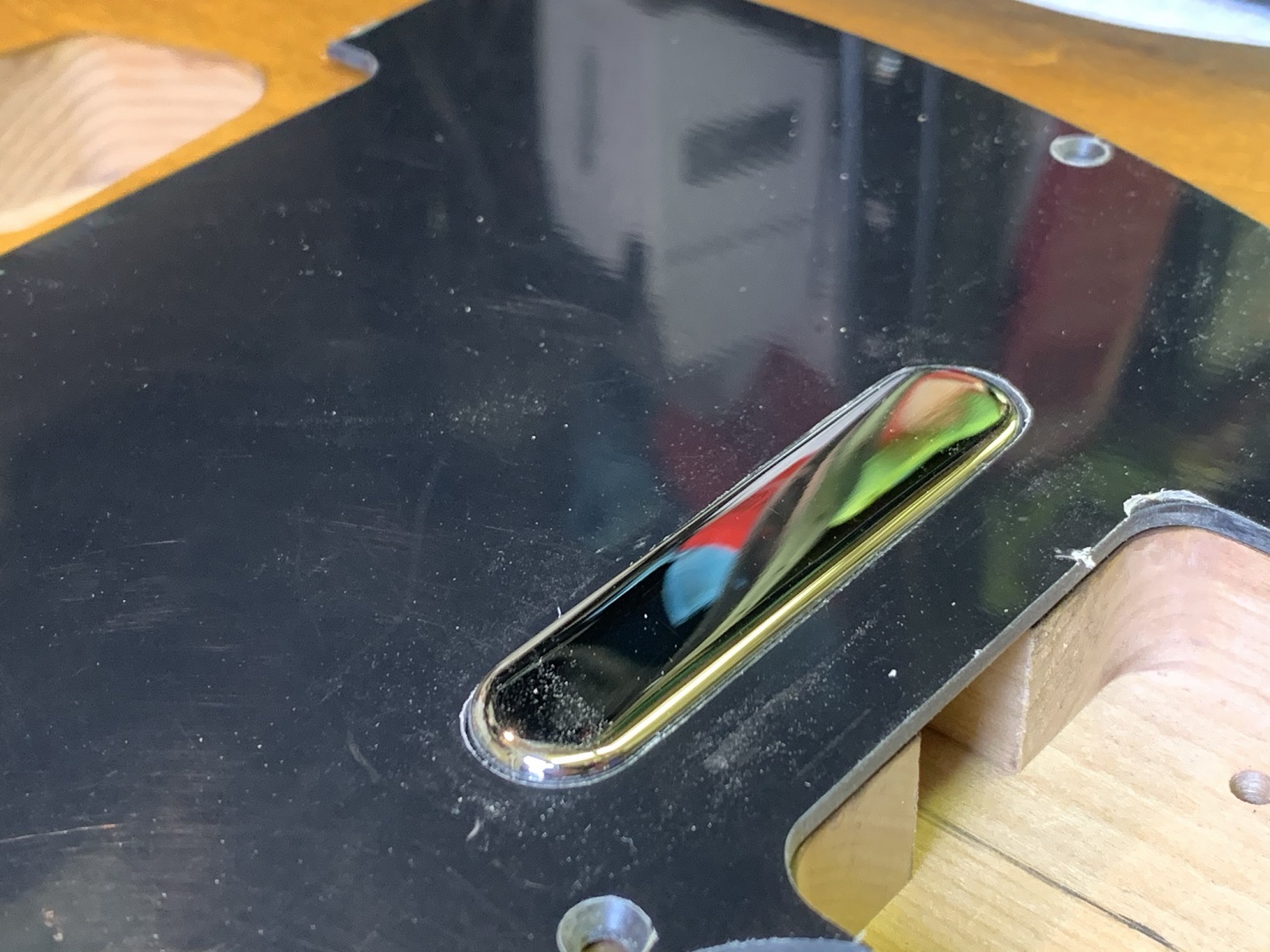

The next stage is to deepen the neck pickup cavity to accommodate the stacked pickup.
I was worried about the stability of the router on the body as there's not a lot of surface to keep the router upright. So I ordered some acrylic and made a base. I didn't have a good way to make a hole large enough for the collet assembly pass through. I removed the base from the router and stuck to the acrylic in an attempt to use it as template. It meant routing without the base attached to the router which felt a bit sketchy. It didn't really work as I didn't end up with a perfectly round hole. But it's both big enough and not too big - so all good.
Attachment 40568
I did a quick practice with the new base on some scrap and it seemed to work okay so I went at it on the body.
It it seemed to work out pretty well. Did three passes and took about 4mm of total depth out of the cavity. It looks really clean and the now the pickup sits just proud of the scratch plate.
Attachment 40569 Attachment 40570
The next problem was the hole for the wire was too high in the cavity and was preventing the pickup from sitting flat. So I widened the hole and that seemed to help enough to the get the pickup to sit low enough.
There's some minor damage to the finish - why I didn't think to put some masking tape down I don't know #dumbarse - but should be easy enough to repair.

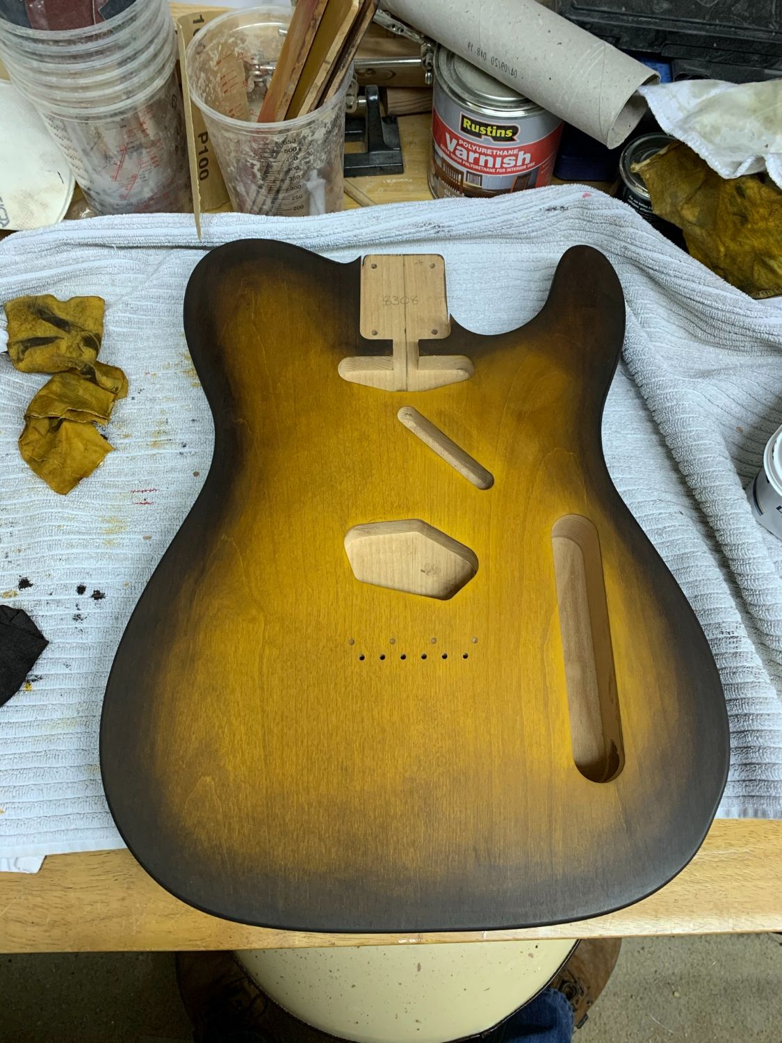

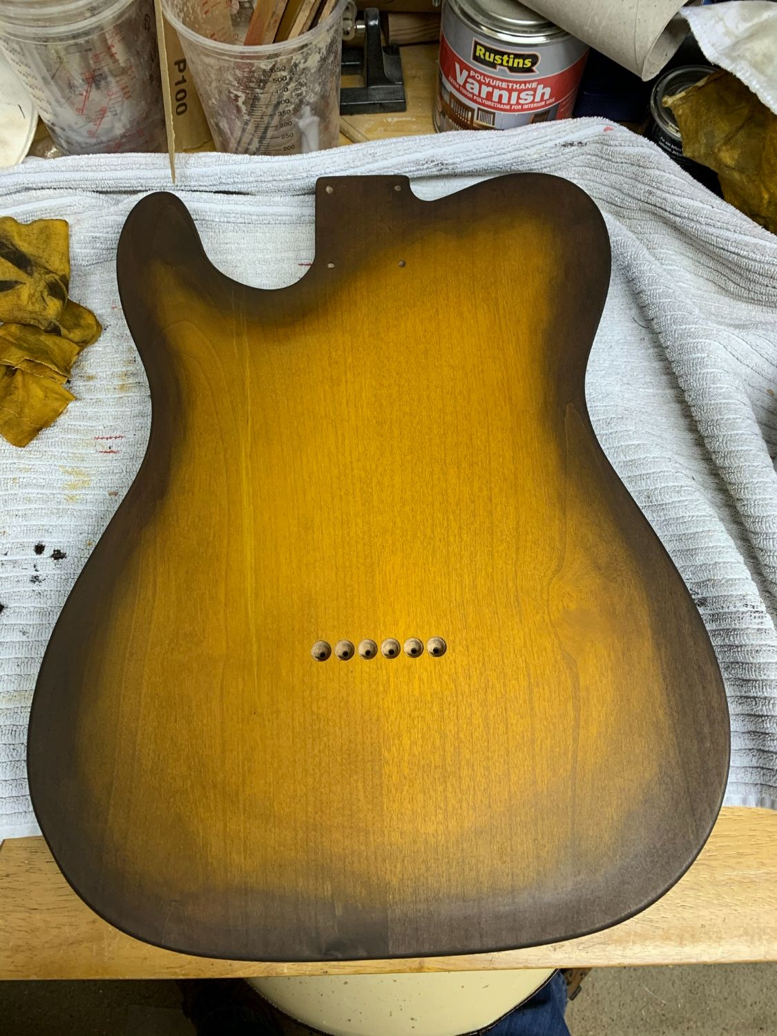

Anyway... I've put the first coat of wipe on poly onto this body. The things I'm doing differently this time:
- Only apply finish when the temperature is above 15C
- Store the poly in a glass jam jar
- Keep the jar sealed and above 15C
I might also move the body inside over night.
So, one coat down... I'm not sure I'll go to 50 coats, like I did with the last build - perhaps 25?
Attachment 40731 Attachment 40732

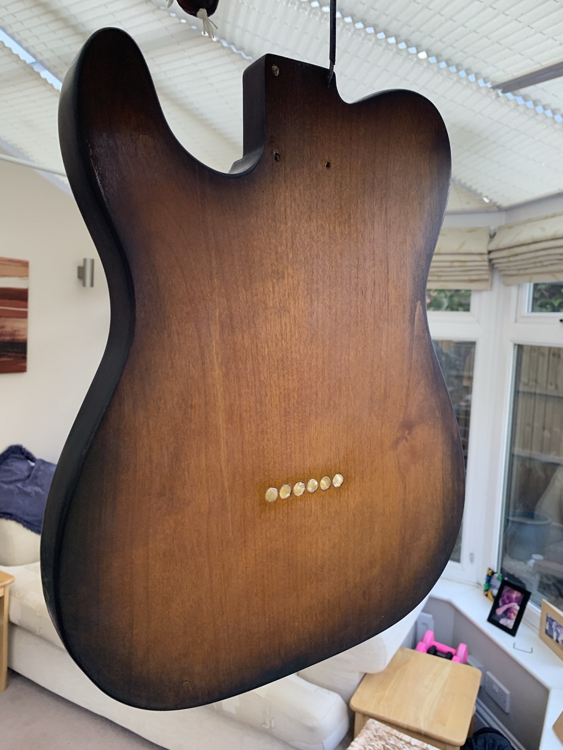

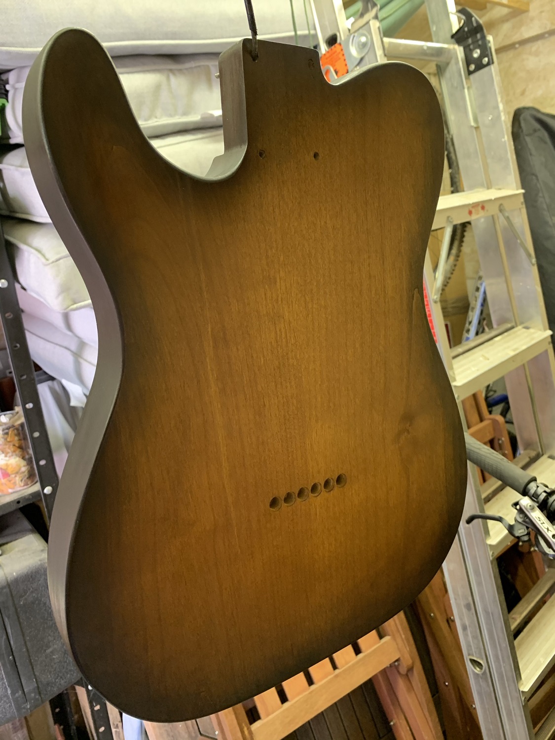

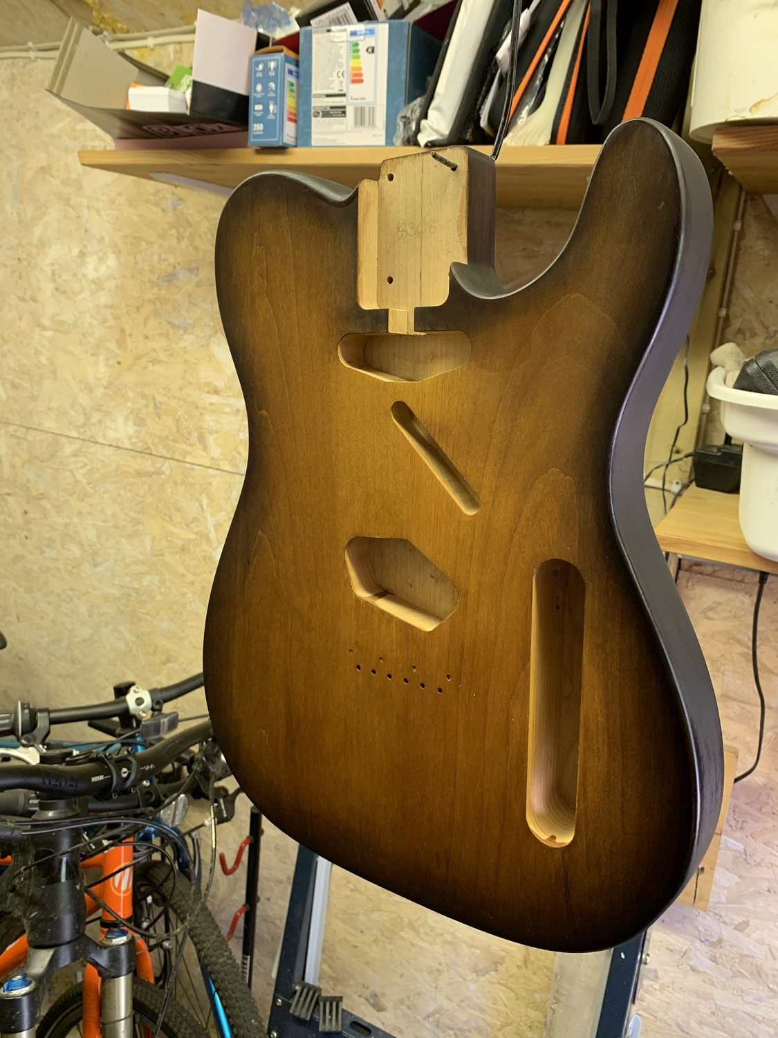

~40 coats later and I have this:
https://uploads.tapatalk-cdn.com/202...d30f241de4.jpg https://uploads.tapatalk-cdn.com/202...34c9f434b9.jpg
I think the poly has gone on okay… I dry sanded at P800 every ten coats or so with the last coat applied last Thursday. I did a final sand and left it hanging in the shed..
It’s been four days now and the smell has almost gone. My plan is leave it two weeks minimum.
The outside temps have been good in the UK ~25C during the day for the last week or so. They are due to go up a little before dropping later in the week to about 20C.
Should I move it to my conservatory which will peak at about 30C or leave it in the shed. I’m worried that higher temps might soften the poly?
I'd leave it where it is. It's warm enough. A bit of air movement helps more than a few more degrees. Too big a temperature difference can let the wood swell and contract a lot, which can't be good for the finish. 30°+, more if in direct sunlight, and then down to maybe 14°-15°C at night is quite a swing.

Well, it's been five or six weeks since I finished applying poly to body and it's still not passing the finger nail test.
A week or so ago I decided to wet sand. It went okay but I went through a couple of times and had to touch up with stain and extra poly. The fixes look okay - but once you point them out you can't un-see them. It's more of a problem with the stain not blending properly rather than the poly.
Anyway - now's it at 2000 all over and feels super smooth - but alas, still soft.
Attachment 41036 Attachment 41037
I'm not going to polish until I've finished messing about the inlay on the headstock. I've had a bit of practice now but I'm not ready to have a go at the headstock. So the body has plenty of hanging time.
I can see a few rattle cans of nitro in my future.
Well that's a bummer, as well as troubling. I've not experienced poly not curing especially after that amount of time. I'm not sure I would have wet sanded if the finish was still soft though.Quote:
One thing I might have tried is dry sanding with medium grade sandpaper and letting it sit a while longer (even just a few days). I have experienced this with acrylic lacquer that was taking an inordinate amount of time to set. So out of frustration I sanded it a bit, and a few days later, it came good. I thought it may have been coincidence or my imagination until Simon B mentioned it another thread months later.
My theory (I think Simon mentioned this also) is that the last coat cured quicker than the coats underneath and created a "skin" that prevented the solvent gases escaping, thus keeping the sub-layers soft. After sanding/abrading the skin the solvent gassed off and everything hardened up.
As I said, I've only experienced this with lacquer with which the solvents are much hotter than turps, but maybe the same effect can occur. Dunno...
Well that’s the thing. It’s hard to the touch. If you sand it, white powder comes off. It’s not like it’s smearing about when sanded.
A few days after the last coat, I did do light dry sand with 800 before leaving it. It was around a month before I started wet sanding.
When I say it’s soft, if I push my finger nail into it, it leaves an indent. (I’m doing these tests where the neck plate is going to be). I sanded it as I remember someone (Simon?) saying that it would increase the surface area and I thought that I might also remove the layers that are preventing the lower layers from hardening. But as I’m burning through in places it seems it’s not even that thick.
The same happened with my PB kit finish. It’s got a load of indents in it from “normal use”. I’m wondering if it’s either the poly / white spirit combo not working well together. Or I’m putting it on too thickly and not letting it dry enough before the next coat…. There’s too many variables to be able to viably experiment with.
Anyway - I’m going to leave it while I finish working on the inlay and then try to make a call on what to do next.
