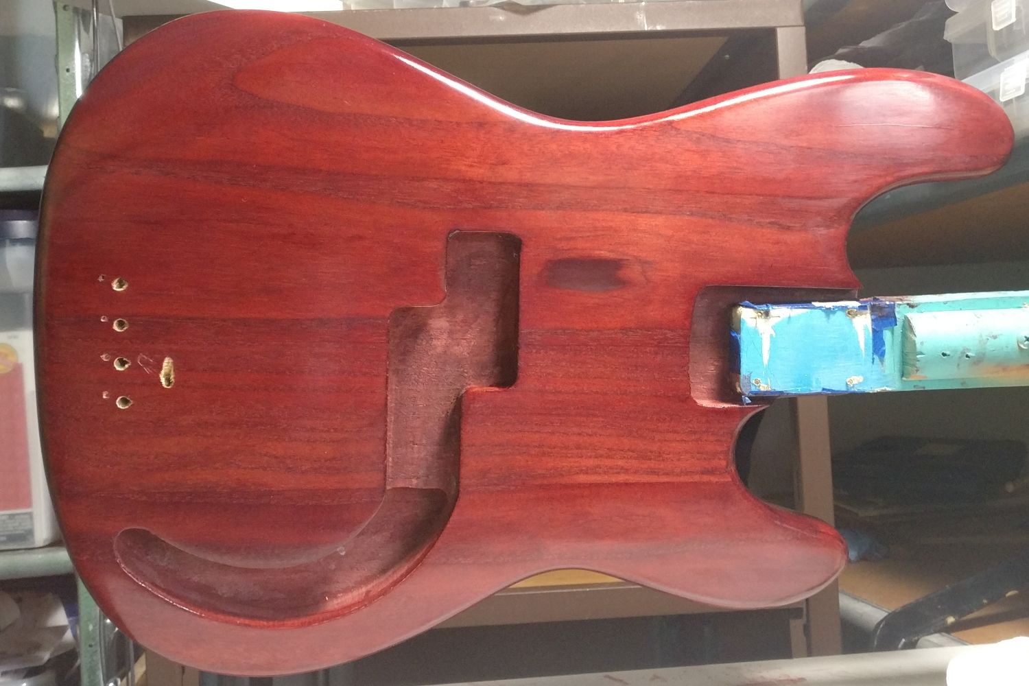

Just a bit more on the finish. An odd thing happened on the last coat of Aqua Coat filler and some of the coats of top coat (General Finishes High Performance Satin). I got this weird sort of cloudy sheen from them...
Attachment 39532
You see it on the back and even more so on the side. [Edit March 13, 2021] I just realized than when I originally posted this, I forgot to mention that after about an hour with the topcoat and about 30 min with the Aqua Coat, there was no more cloudiness. It had turned crystal clear.
That said, the top and back are really well filled. There are a couple of places where there are some natural grooves that follow the figuring of the wood at the bass of the cutaways, but I decided I sort of like how they looked, and the filler has made them quite smooth.
I have now used up all but 1 or 2 ml of my Top Coat. It seemed pricy at $32/quart (.946ml), but I was able to do 3 bodies and necks with this amount. I have just 1 or 2 ml left. I suspect that someone with spray equipment or a steadier hand could do better. The mfg recommends 3 coats with a brush. I brush on 6-10 coats in order to be able to safely sand out any imperfections.

You may be right, and it looks like I'll get that opportunity. I just botched putting the string-through holes in.
Attachment 40543
With the other bad parts of the finish, it has enough other blemishes, that I think I may just finish with a solid color anyway. Too bad. Paulownia has a beautiful grain that is quite stunning in places. There's a spot on the back of the upper horn that I have been thinking of as the "Eye of Sauron"
Attachment 40544
If it has to get covered with veneer or plywood, it might as well get paint to. Probably well to reflect on the fact that Sauron was the villain...

It worked like a charm, although it does not hide my accident. Even before that I had some other spots that were not doing well. Mostly this is because I tried to repair little dents and scratches, not realizing how deeply I'd have to sand to deal with them, and how resitant they'd be to fixing...so I was half way to thinking the finish was just not going to work.

I also replicated the tear out that I got under one of the string-through holes. Those experiments have not gone as well so far. I first tied to fill with plastic wood (mfg: DAP). It says that it is "stainable" and "looks & acts like real wood." This turns out to pure BS. The dye stain turned it hot pink. So did the gel stain. Mixing with stain turned it pink. Mixing it with red and black turned it gray. So far the best I have been able to get out of it, is black that looks a bit like a knot-hole. Suboptimal but not hideous.
So far the best result seems to be coming from dye staining the tear out, then filling with aqua-coat clear, then staining with gel stain. Not perfect: maybe a tad better than black. I have thought about trying to glue in a little, stained, paulownia patch, but the tear out is jagged enough that I think it would be impossible to avoid visible glue spots that would make it worse. Also thought about making a paulownia-and-Aqua-Coat slurry, but haven't yet tried it.

I have a few coats of shellac on. Got the dents fixed as best I could with AquaCoat. Not perfect but better. Did better with the sand-throughs. I used a tiny paintbrush with tiny amounts of the original stain until I could not see the damage. To my surprise that seems to have done the job.
Attachment 40782
At the moment my plan is to let the shellac sit for a couple of days and then begin using the Brite Tone finish. If that does not make it more dent-resistant...then I guess it's just not going to be dent resistant. Since beginning the project, I have found some water based wood hardeners that might have made a difference if I had known about them earlier. At this stage, it would be easier to get a new body and start over than to take the finish back and try again with this one...so they will need to wait for a future project if I try to work with paulownia again.... And I might. I DO like the weight.
