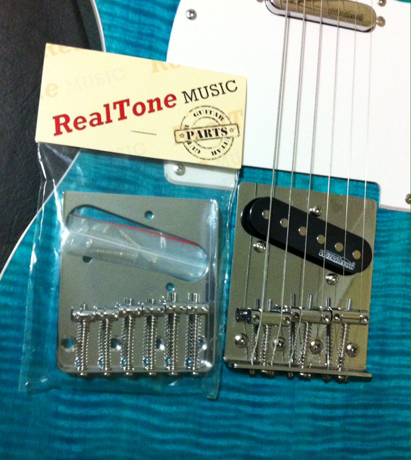

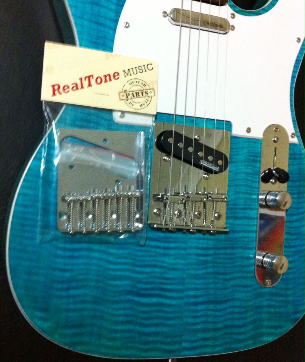

Re-checked the intonation across all 6 strings and it is a compromise at best to get somewhere near the fretted 12th note. Arrggghhhh, so frustrating and as the 6 saddle replacement arrived in today's mail proceeded to install it to see if that would do the trick.
Attachment 12131Attachment 12132Attachment 12133Attachment 12134
Slightly shorter base plate length but thankfully long enough to hide screw holes from previous one.
Started intonating high E at exactly 646mm and had to screw plenty south to remove the sharpness on fretted 12th note and ended up at about 649mm with all others staggered backwards a little bit further from there.
May have solved one problem but now have a couple more to deal with as the bridge PUP no longer makes noise and suspect it may be shorting on the copper shielding or a wire came loose. Also had to wind the saddles up really high to take out fret buzzing and now some of the strings are buzzing against the protruding ends of the saddle intonation screws. Neck is dead flat and maybe I need to shim the front edge a bit, add some front bow, or take a bit of meat out of the neck pocket to drop the altitude down closer to sea level?

Thanks DB & Andy. I will probably revert back to the original 3 saddle and from the 6 saddle version I have some good reference points for where each string was intonated on it's own to help with the compromise on shared post positions.
