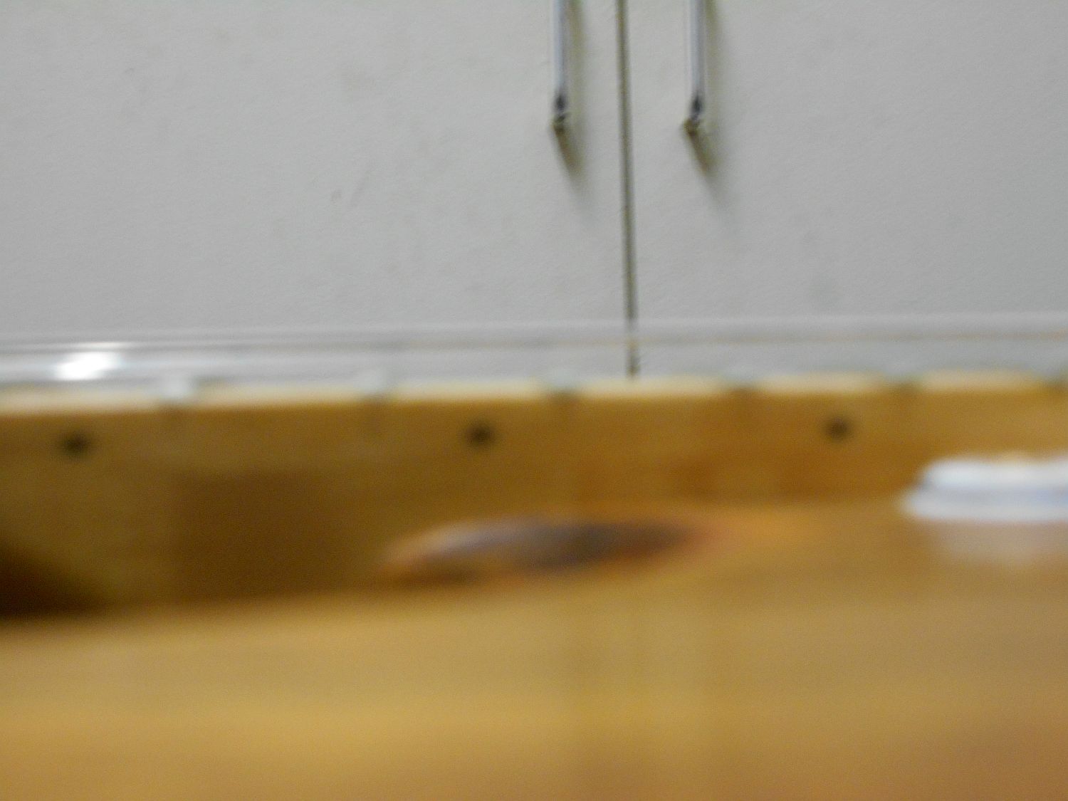

Okay, here's some pics so you can see how I have set the action and the bridge on my Strat:
Here's the action at the 1st Fret, it's only .020 inch between the top of the 1st Fret and the bottom of the string for each string:
Attachment 10476
Here's the action at the 17th fret, I have set it to an even 2.5mm for each string:
Attachment 10477
And here's how I have set the bridge, tilted forward rather than flat against the body:
Attachment 10478
Setting the bridge so that it tilts forward is how Leo Fender intended the bridge to be set up, the gap between the end of the bridge and the body should be about 1/8th of an inch as per fender specs.
Of course, you don't necessarily have to stick to Fender Specs.
I know, some of the pics are a bit out of focus, I need to find out if the auto-focusing on my camera can be switched to manual.
