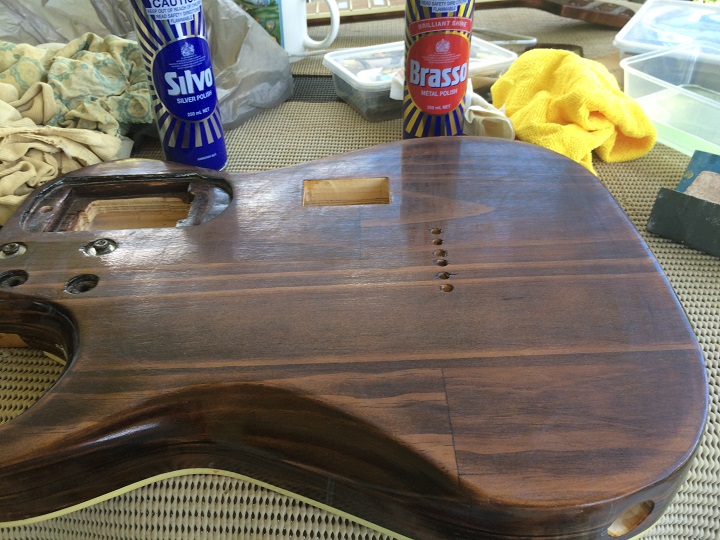

This may help or it may just confuse you even more, but I have just got back into my latest build and the TO that I was using was well past its use by, and had gone a little thick and had left fairly bad streak marks from the cloth applicator. The guitar is only made of pine so will damage easily and it is a bit of a test case so I am not too concerned how it looks, so instead of sanding back and starting again I thought I would try and get some sort of a decent finish on it.
Firstly I hit it with 1500 wet and dry using a drop or 2 of washing up liquid in a small container of water. This took off the worst of the ridges, I then went over it again with 2000. Again using washing up liquid in water as the lubricant. I let the paper do all the work and apply as little pressure as possible. I usually go to about 20 coats of TO but as I apply it in extremely thin coats I don’t want to take off too much.

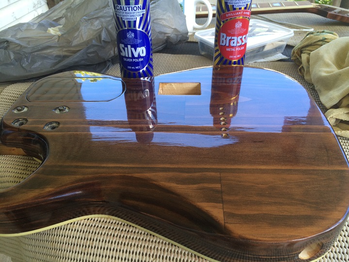

I tried to sand back to an overall even matte finish but as you can see from the photos, it was still pretty rough. I then used my secret weapon, Brasso. I have used it on nearly all my guitars to date with no detrimental effects, but I have no idea what's in it or what it will do to the guitar over time, so use it at your own risk. I also have some Silvo, but have never needed to go finer than Brasso.

You can see that it is fairly uneven, but it is good enough for a test bed guitar.
Attachment 14179
Still uneven, but it now looking a little better. I should have prep’ed the pine better, but it will damage pretty easily, so why bother. Lol.
Attachment 14178
