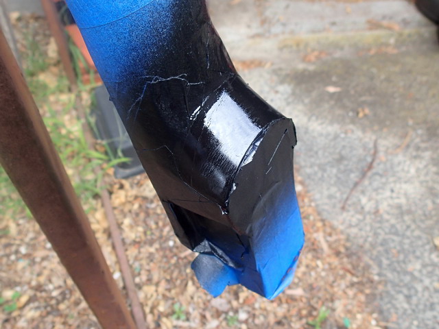

The troubles with the heel continue, the more i persist with it the worse it gets, nothing will take so plan B:
What happens is the bog wont take, then when it does it just falls back out again grrrr.
Get some black gloss rattle can paints and mask off the guitar.
I put some paint daown in the crack and left it for 24hours, then bogged it again, got some slight cracking so bogged it again, sanded it back for the 30th time until smooth then shot it with black enamel, sanded it back then hit it again, this will now wait 24 hours then i will shoot a fine coat after steel wooling it, i actually use a synthetic 0000 pad for this.
What a PIA this neck heel is
Gave it a spray the 30mins later light sand making sure i got the crack settled, then hit it again a bit harder.
