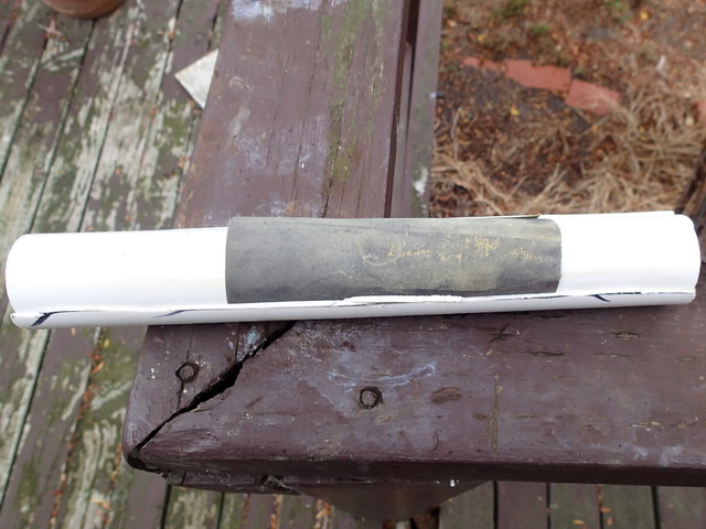

Someone asked me the best way to sand inside the bouts on the guitar, it can be a shocker of a job by hand, i use this method, cant claim its mine, but cant remember who showed me.
I get a piece of 32mm PVC cut 2 lengths 250mm one of the lengths i cut all the way down the length a bit shorter than half way.
You get a piece of whatever paper you are using and wrap it around the whole piece then snap the cut piece into place, instant curve sander.
2 bits one cut nearly in half
Attachment 8740
Clipped together, makes a great sanding tool for curves
Attachment 8741
Works a treat

nice tip on the curve sanding, which part of the axe are you using this for ?
PS you might want to edit your post to say PVC, not PVV !
I am using it at the moment on a telecaster neck where the headstock joins the neck, just to do a fix for a guy who did a real big oops and made it look like crud.
Inside upper and lower bouts on the 335 to round it nicely.
I have used this trick for ages on just about every sanding job i have
nice tip Tony and you can always use different diameter PVC pipes to suit the sanding job
