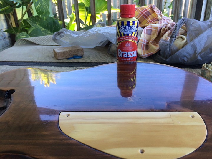

The back of the guitar after sanding back with 2,000 grit paper
Attachment 21155
The back after polishing with Brasso
Attachment 21156

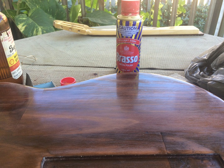

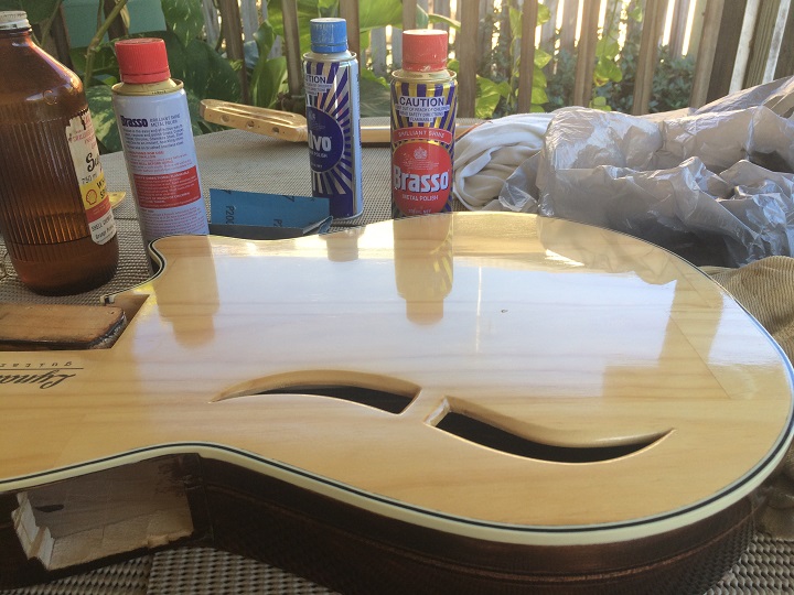

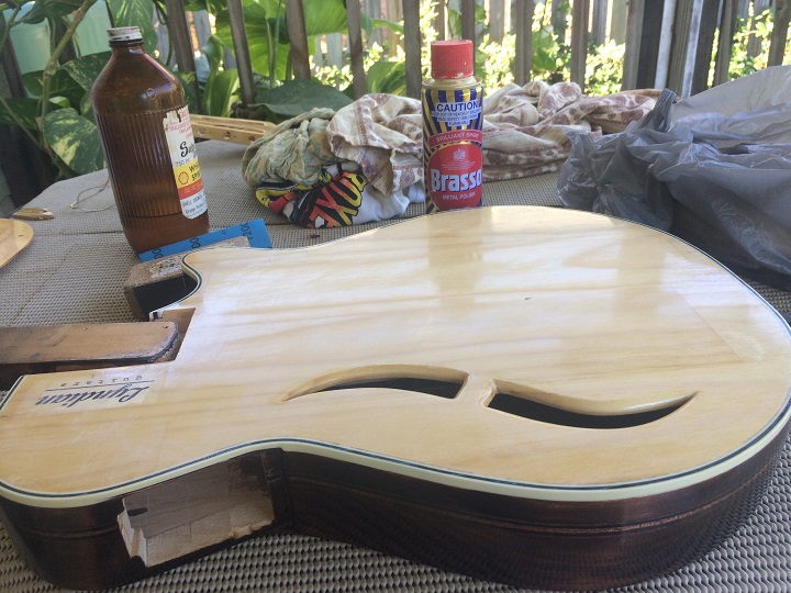

The top, after 2,000 grit
Attachment 21157
And after Brasso
Attachment 21158

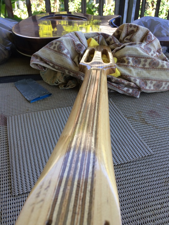

……….. The neck
Attachment 21159

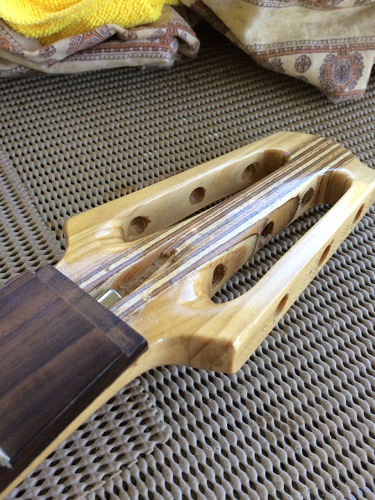

And lastly the headstock
Attachment 21160
