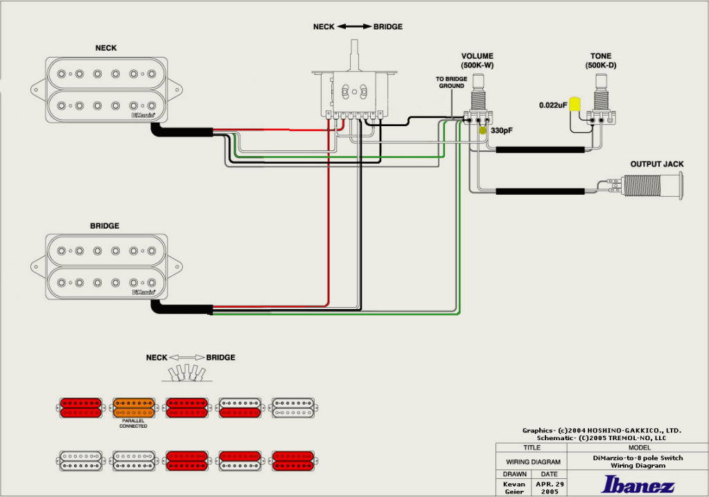

I'd look at getting and fitting a VLX53 5-way switch. It's the switch Ibanez use on their HH guitars which makes getting various pickup combinations with splits very easy.
https://www.realparts.com.au/vlx53-h...er-switch.html
34mm deep though, so check you have the depth.
This is the standard Ibanez HH configuration selection. A bit different from some, one could say rock biased with no individual neck or bridge single coil selection.
Attachment 41087
