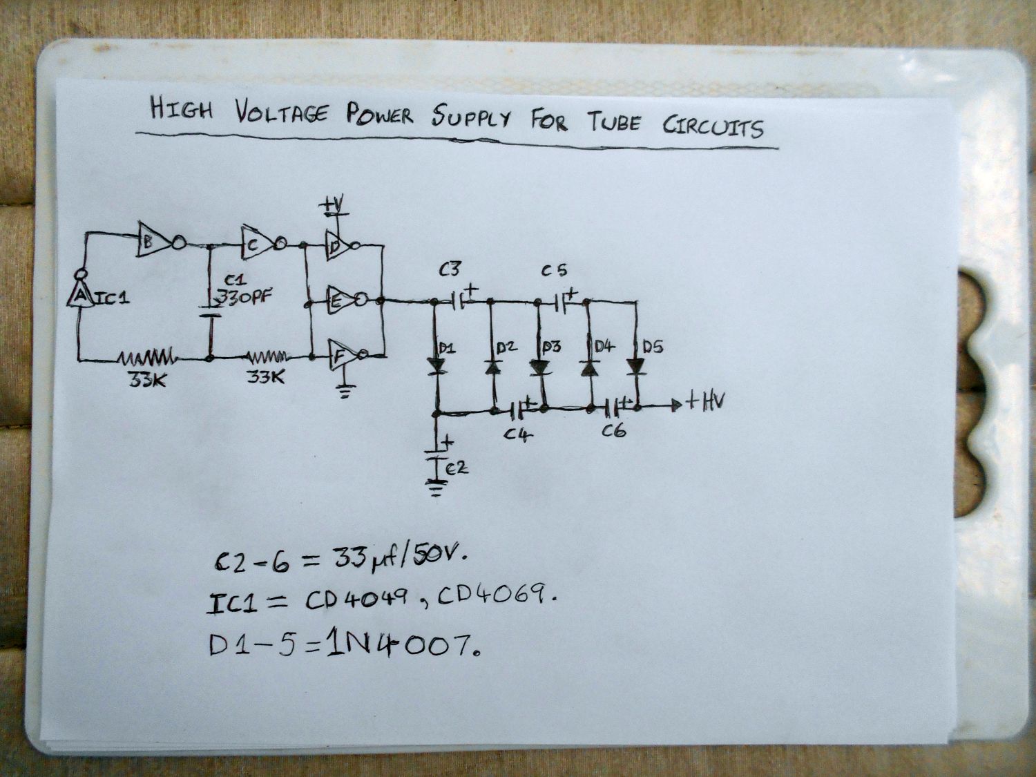

Here's a simple circuit for generating the high voltage needed to run tubes, like the 12AX7/ECC83 etc, properly, it's basically a 60kHz square wave oscillator made from a CD4049, or CD4069 Cmos Hex Inverter IC, two 33k resistors, and a 330pF capacitor, and a voltage multiplier made from five 1N4007 1000V PIV Silicon Power Diodes, and six 33uF/50V electrolytic caps.
Inverters D,E, and F are just used to buffer the output of the 60kHz square wave oscillator, formed by inverters A,B, and C, the two 33k resistors, and 330pF cap, so that it has enough current-output capacity to drive the voltage-multiplier circuit.
I remember doing some breadboard experiments with this circuit, and found that I could increase the output-voltage, simply by adding more 1N4007 diodes and 33uF/50V caps, I was able to easily generate +90V DC from a single 9V battery that I used to power the circuit.
Here's a pic of the circuit for those who are interested in checking it out:
Attachment 35974
One great thing about this circuit is that you can easily power it off a +15V DC supply, which means that you can then also run the tube heater off a DC supply as well, which will reduce hum.
The only caveat with this circuit is that the working voltage of each of the 33uF caps needs to be at least 50V DC or greater, 33uF/63V caps should work fine, I've used some 1uF/100V caps in the circuit instead of 33uF/50V and they worked fine.
As a side-note, if you build the high voltage power supply circuit as I have posted above, you will get about +45V out of it, to increase the output-voltage you need to add more 1N4007 diodes and 33uF/50V caps.

DrNomis_44 added it in his modifications, earlier in the thread. I've drawn up the circuit, which shows it.
Attachment 36002
