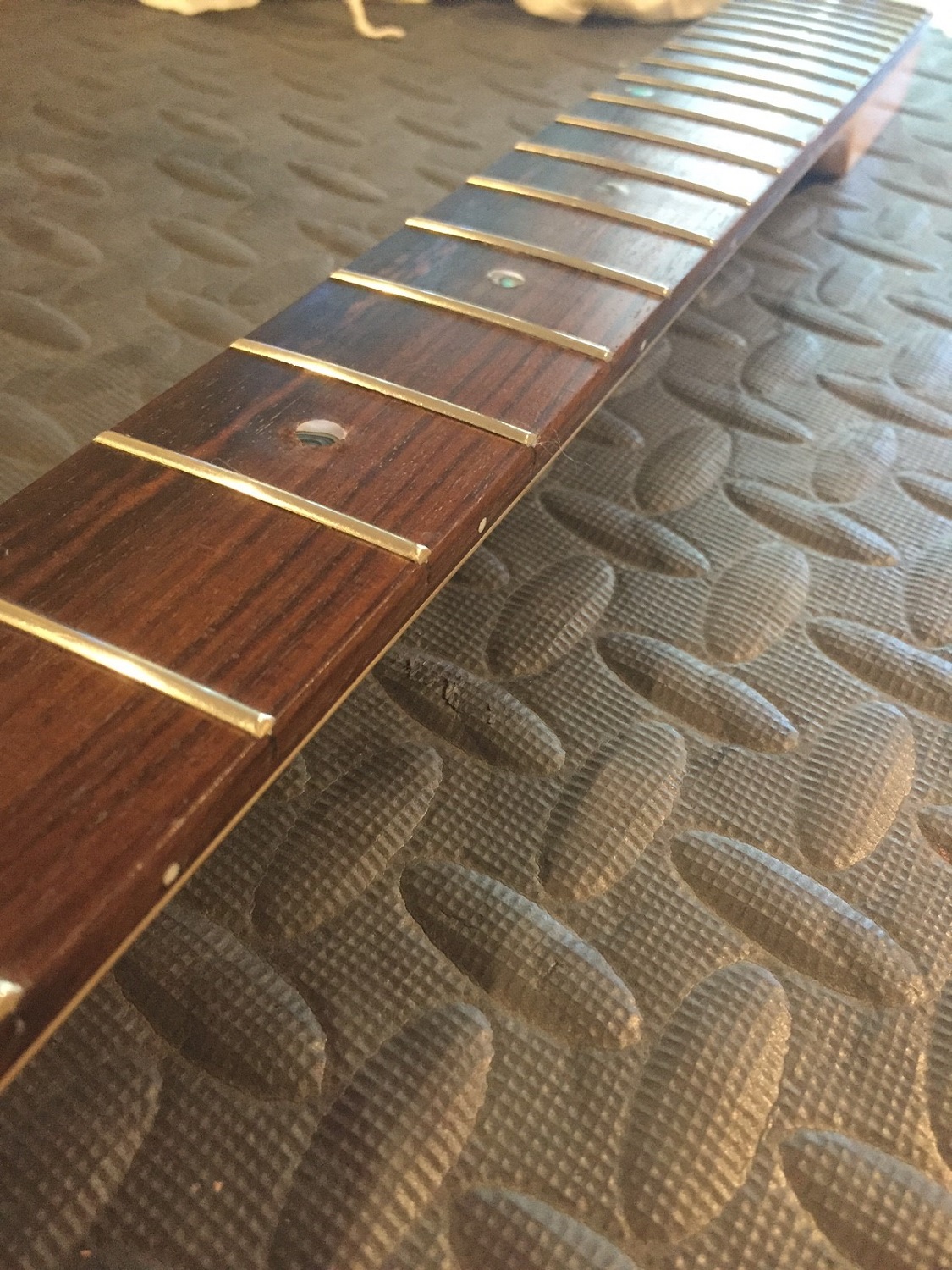

1 Attachment(s)
Cool,
the body should be finished with just the final coats. If you wanted to see how that comes out, I would put at least another final coat on and wait at least 21 days for it to cure before polishing.
Never tried waxing over DT finish, I think Shazzrandom did it on hers and I think she took videos.
I usually dingowax my fret boards. I have waxed both maple and rosewood.
My method is to get a heavy duty cloth, dig out a little bit of wax, kneed it with my fingers until it heats up a bit and becomes supple. I then put an eraser in the cloth (saves your fingers) and push a bit of the wax into the cloth on the outside then apply it to the wood and spread it out as best as possible. after about 5 - 10 mins, I use a bit of the clean cloth and take off the excess wax so its a bit more even. when im all done I put my polishing drill bit on my drill and give it a polish....comes up shiny;)
Attachment 14922Attachment 14922
