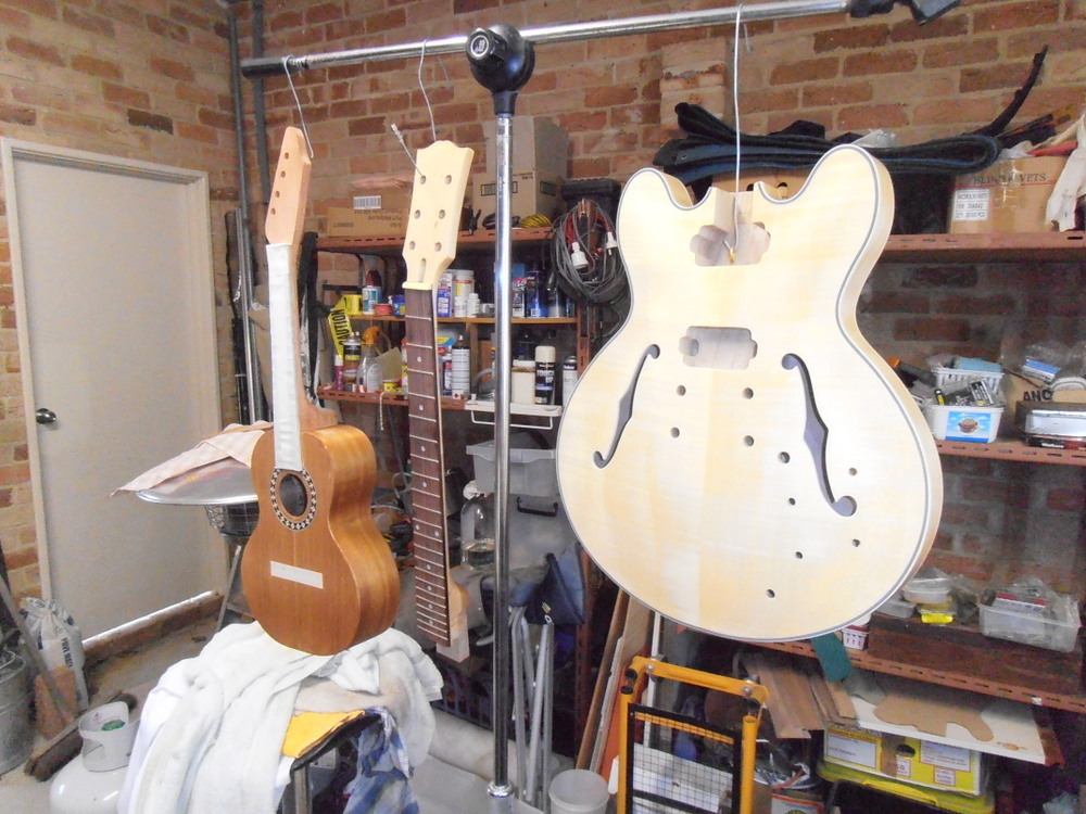

1 Attachment(s)
Hi Wokkaboy Here is the latest pic. The uke kept me occupied while Dingotone curedAttachment 14863
