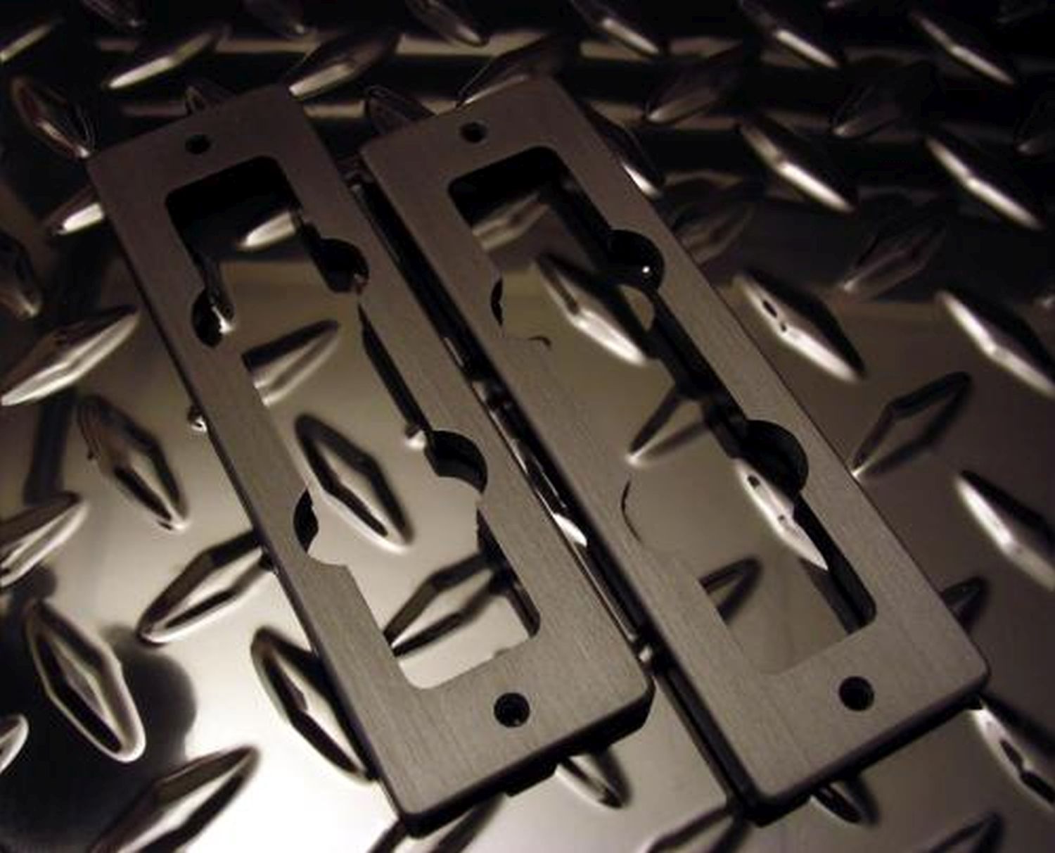

Also, why is the neck pickup hole not the same as the bridge? If it was, I'd probably ditch the pick guard, but there'd be a huge ugly gap around it then. Maybe I'll try to find a pickguard surround or something. Again, this isn't a complaint as the pickguard would cover that hole, I'm just wondering why it's like that.
