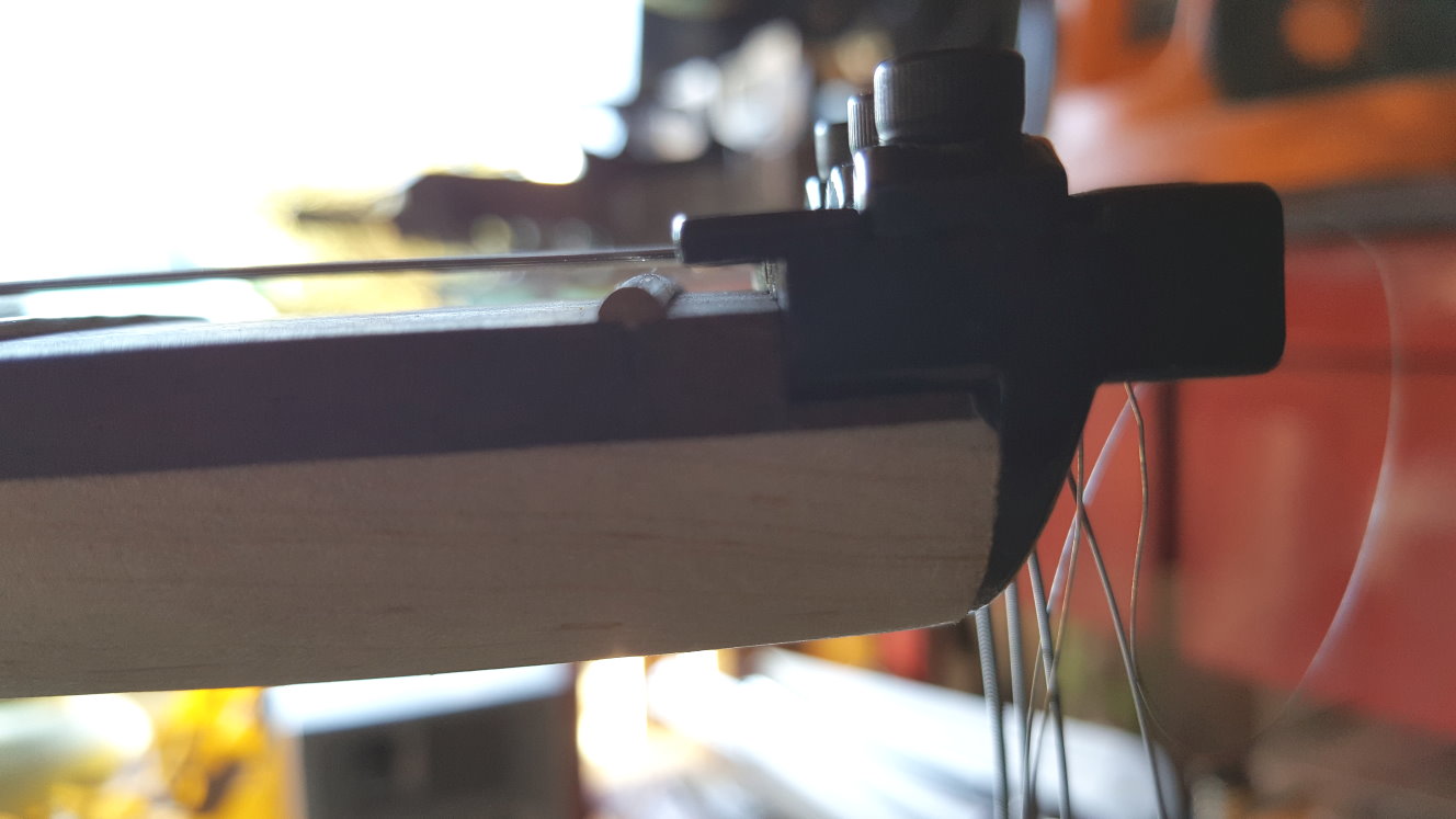

heres my Factory fitted locking head piece ..
Attachment 12392

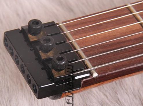

and heres the one example I found... clearly different, at least now I know how it should sit..
Attachment 12393
Thanks Stan... Once I knew that it should make contact I knew what to look for...
