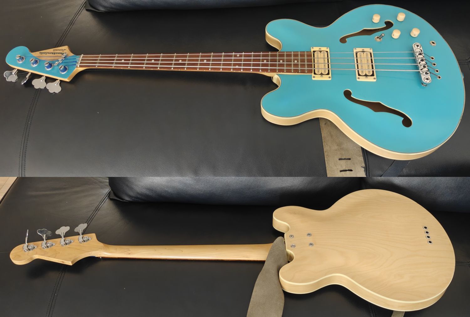

Both of my ES style basses ended up with solid colored tops, but I decided to do the back and sides natural. Not unhappy with the way it turned out:
Attachment 45985
On most of these the back and sides use a basswood veneer which is a bit thicker than the top, and a bit more robust. It is possible to sand through (as I proved with my other ES build which has solid colors on the back and sides as well), but the veneers are a bit thicker and will take a bit of gentle sanding.
Tru Oil would be a bit darker (I used a water based poly) but this gives you an idea.
The maple figured tops are SUPER easy to sand through. The top of this one was always going to be solid since I needed to cover some holes that I made in the top to get the bridge right. Even if it did not have that destiny, I am sure I'd have sanded through...
