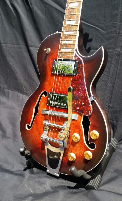

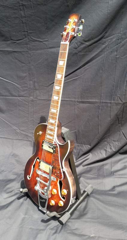

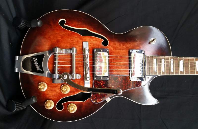

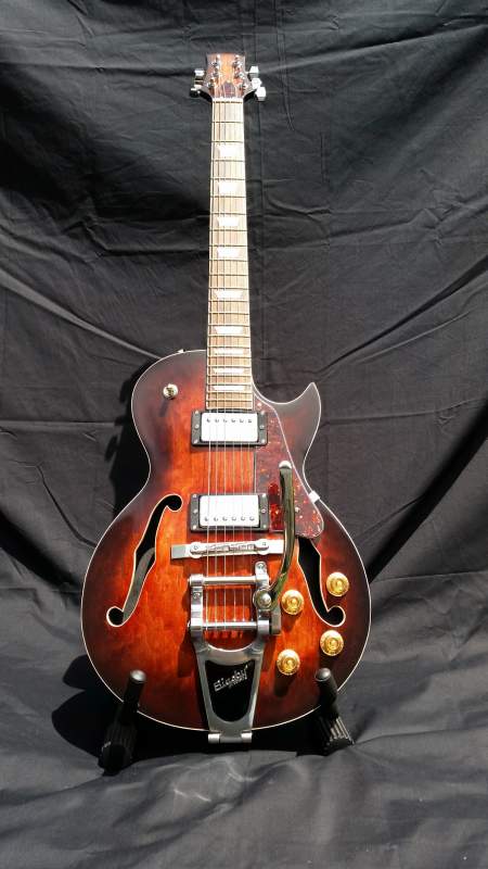

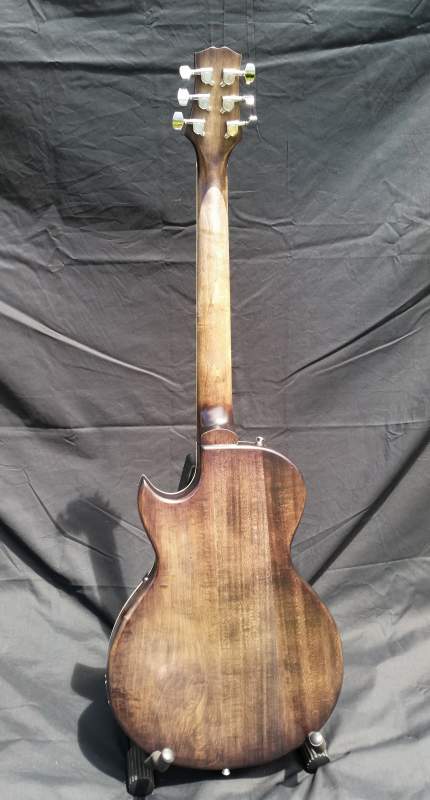

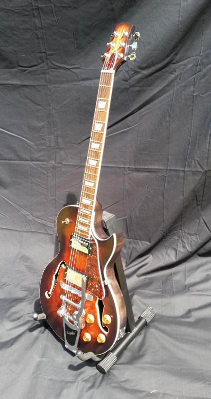

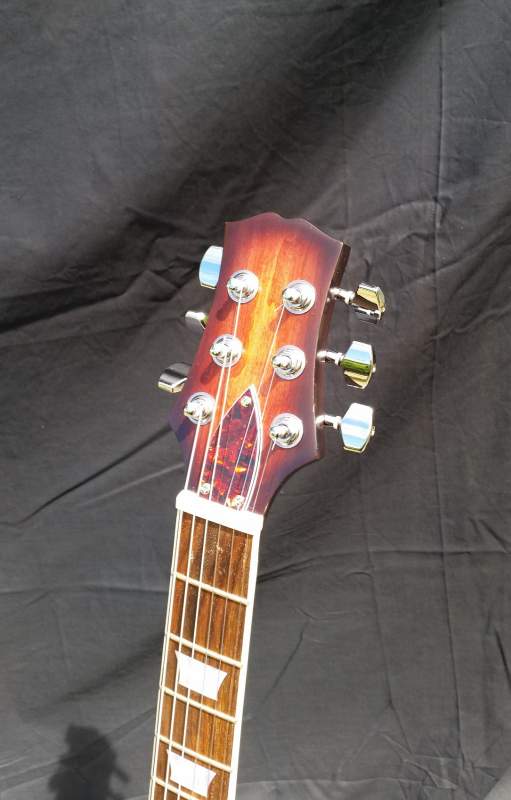

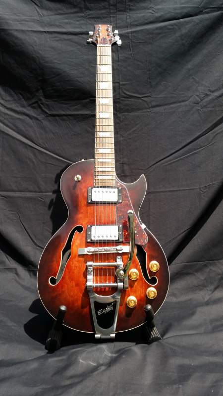

    more ES-2V goodness..
    Not as good as Gavs, but here is my ES-2V
    Front finished with Wudtone Carmine Gypsy and Black Magic Woman mix with BMW burst, back and sides BMW with gloss Wudtone
    Stock kit plus
    Bigsby B70
    Bigsby bridge
    vintage wiring, orange caps, tone circuit mod
    chrome switch tip and radio nut
    black pup surrounds
    tortoise shell pickguard and truss cover

    WOW! That's the exact colour I've been looking for!
    Could you please PLEASE give us a tutorial on how you achieved that tobacco burst? I've found Carmine Gypsy and Black Magic Woman on the Wudtone site, but I have no idea how to even start.
    And what do you mean by "mix with BMW burst"?

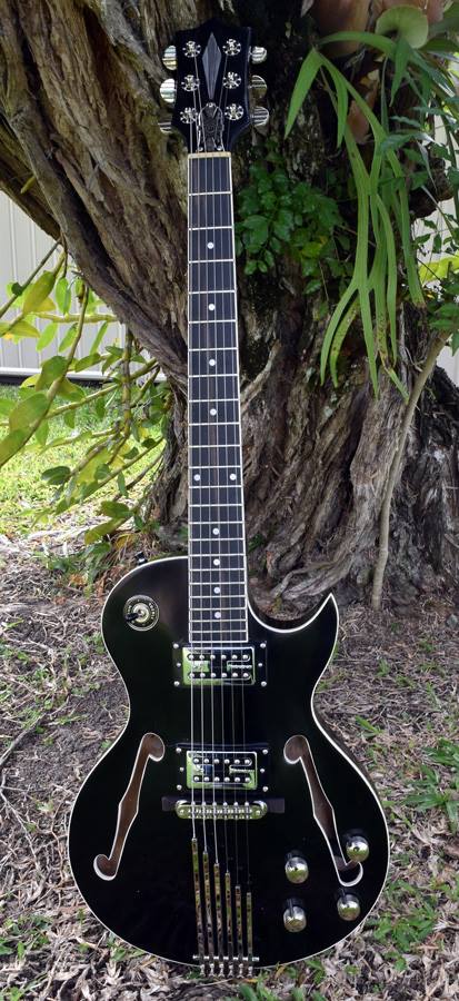

    Many upgrades. Duesenburg tuners and knobs , GF Retrosonic pick ups,ebony fret board and bridge base, Finger style tail piece with reversed fingers Hell guitars tuner washers,switch plate and truss rod cover. my own stainless steel headstock inlays.
