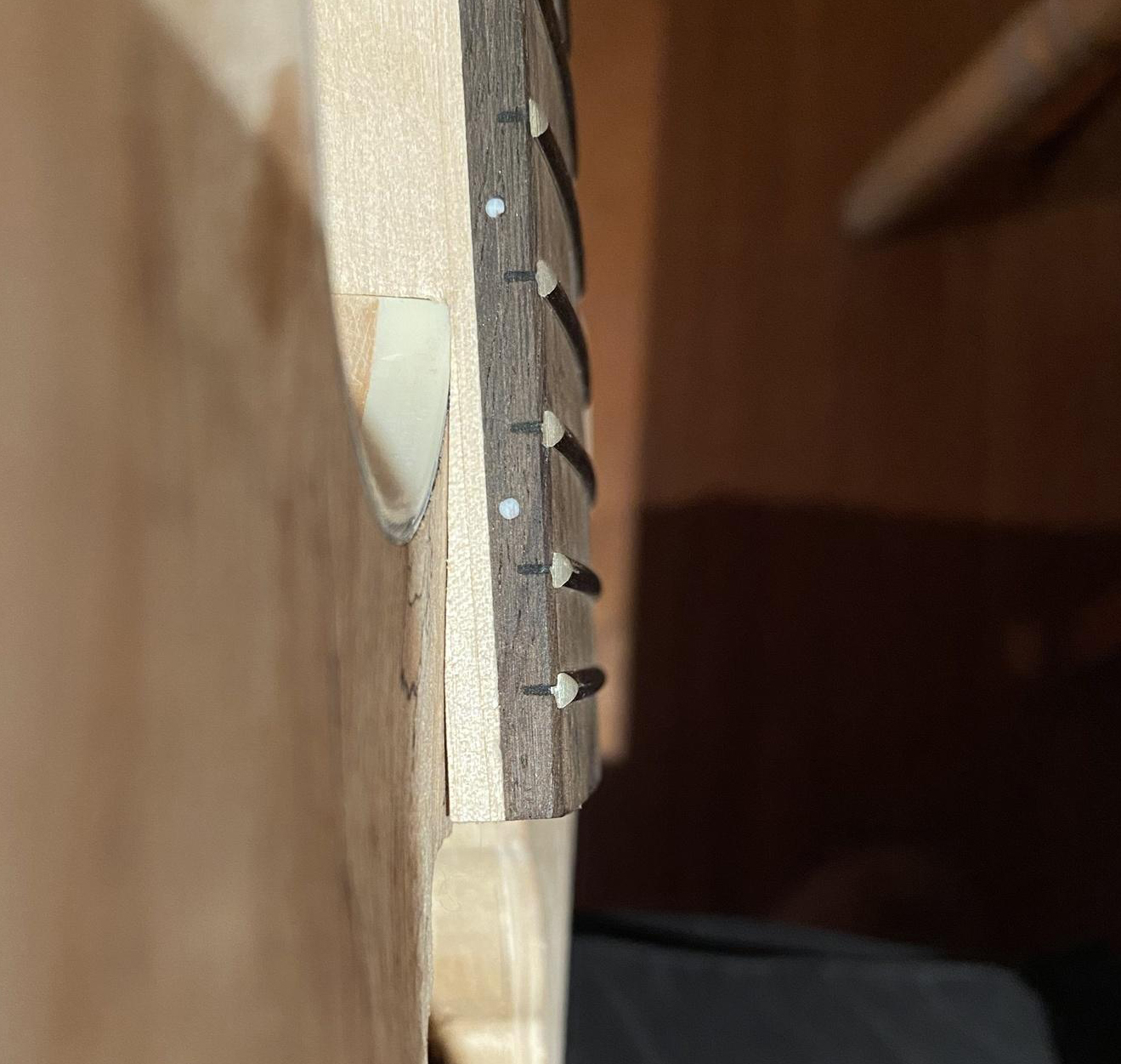

Testing the neck out and having a closer look at it, looks like there has been some timber flake off in the routing process. Upon fitting, my rough sight notices that the angle isn’t affected but there is a small gap on the left side more so under the last fret so I’m not sure if it’s something to worry about now or just keep in mind later on for something. I understand that the pocket also needs a little tidy up too.
