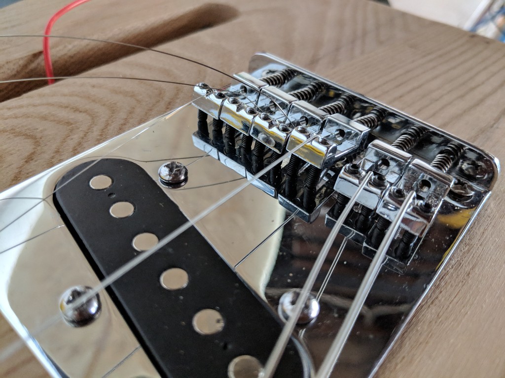

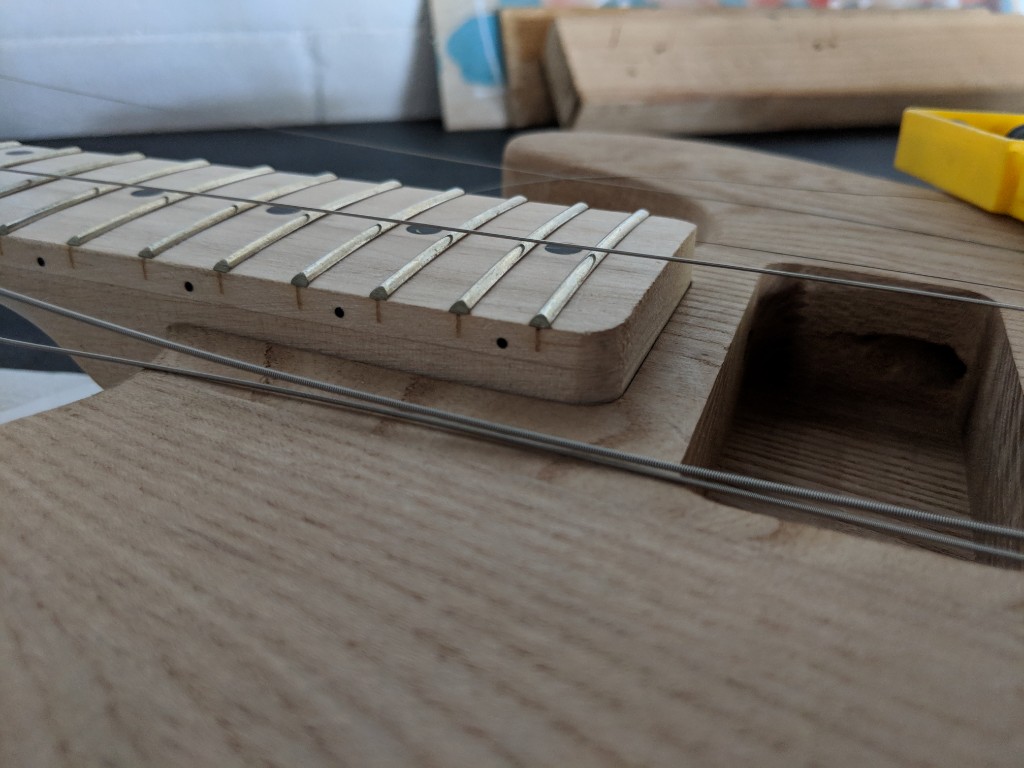

    Photos with the D string installed:
ID:	29586 I have the saddle as tall it can go.
ID:	29587 But it is still too close to the fretboard.
    I'm keen on the aftermarket bridge so it looks like I will have to deal with the issue at the neck pocket or heel.
    I've measured the depth of the pocket and it is around 18.80 +/- .20 mm. Is that the expected depth? If so, I will adjust the neck heel as I feel that is the safest path.

    Could you shim the bridge to elevate it?
    Pedalboard Build
    Quote Originally Posted by churchie View Post
    I definitely could but it is not the kind of look I'm going for. Bridge flush to body is a requirement in this case.
    Looking at that second photo, neck looks very tall against the top of the body but I have only a set neck PRS to compare it to. Would anyone be able to measure how tall their Tele's neck is measured from the body's top?
