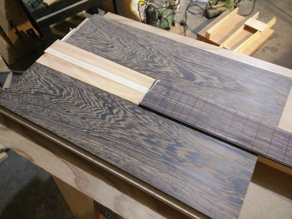

    For the bass, I plan to do 6 strings (5 strings was the original plan but why not have an extra string to play with? ), with a narrower string spacing at 16mm at the bridge and a 52mm nut. I plan to taper the neck all the way to the body, ala Wynn bass style without the tapered laminates. I also grew to like single cut basses.
    Seeing that they weren't any plans for 6 string single cut basses, I had to design my own. 34" scale, 24 frets, with a tapered neck to body.
    Enough of the rambling and here are some pictures!
    I later found out that the fretboard blank was too narrow, so I'll be using some rosewood binding to extend the edges plus that will help hide the fret tangs!

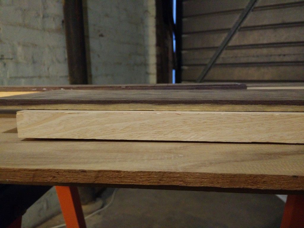

    Then I transferred the outline onto the mahogany blanks. Since the maple was thin, it started to warp a little but nothing too serious.
    Then I cut out the shape with a hand saw and a jig saw.

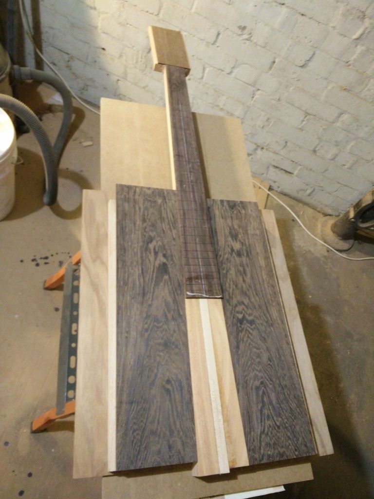

    Test fitting all the laminates together:
    And this is how they all look like:
