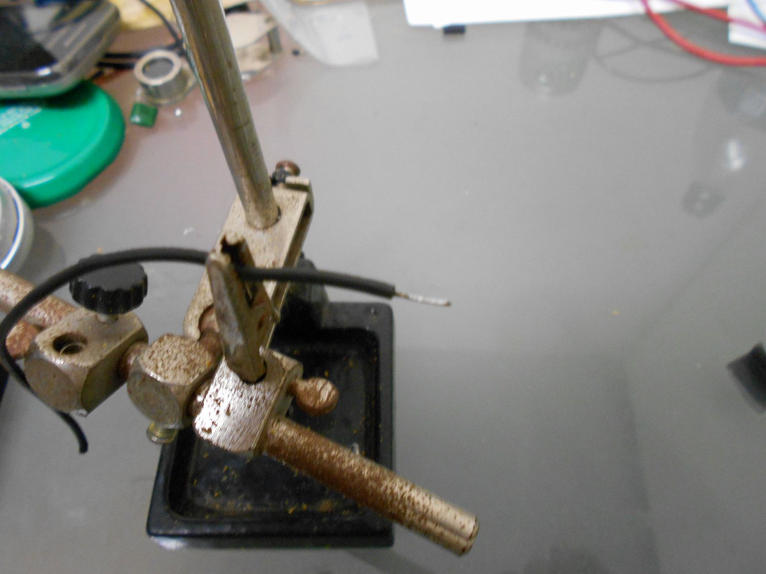

    Okay here are some pics to illustrate the four soldering-preparation phases:

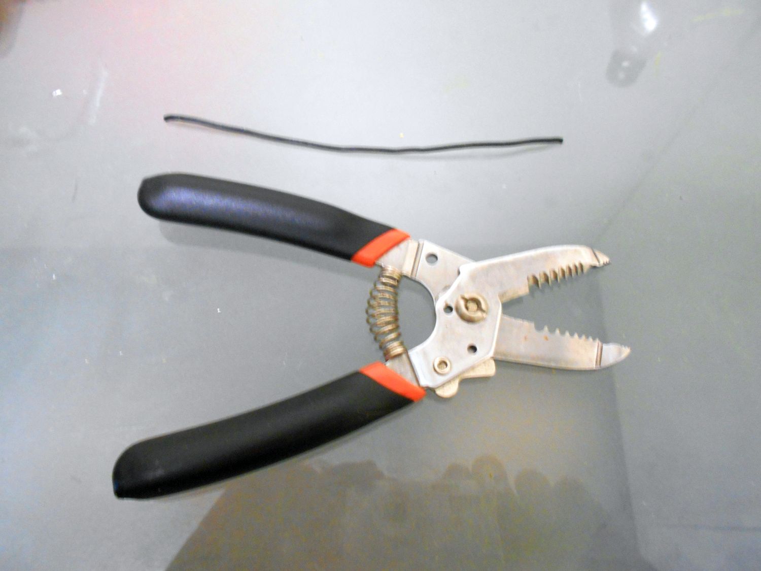

    Cut:
    I used my wire stripping-tool to cut the piece of wire to the required length.

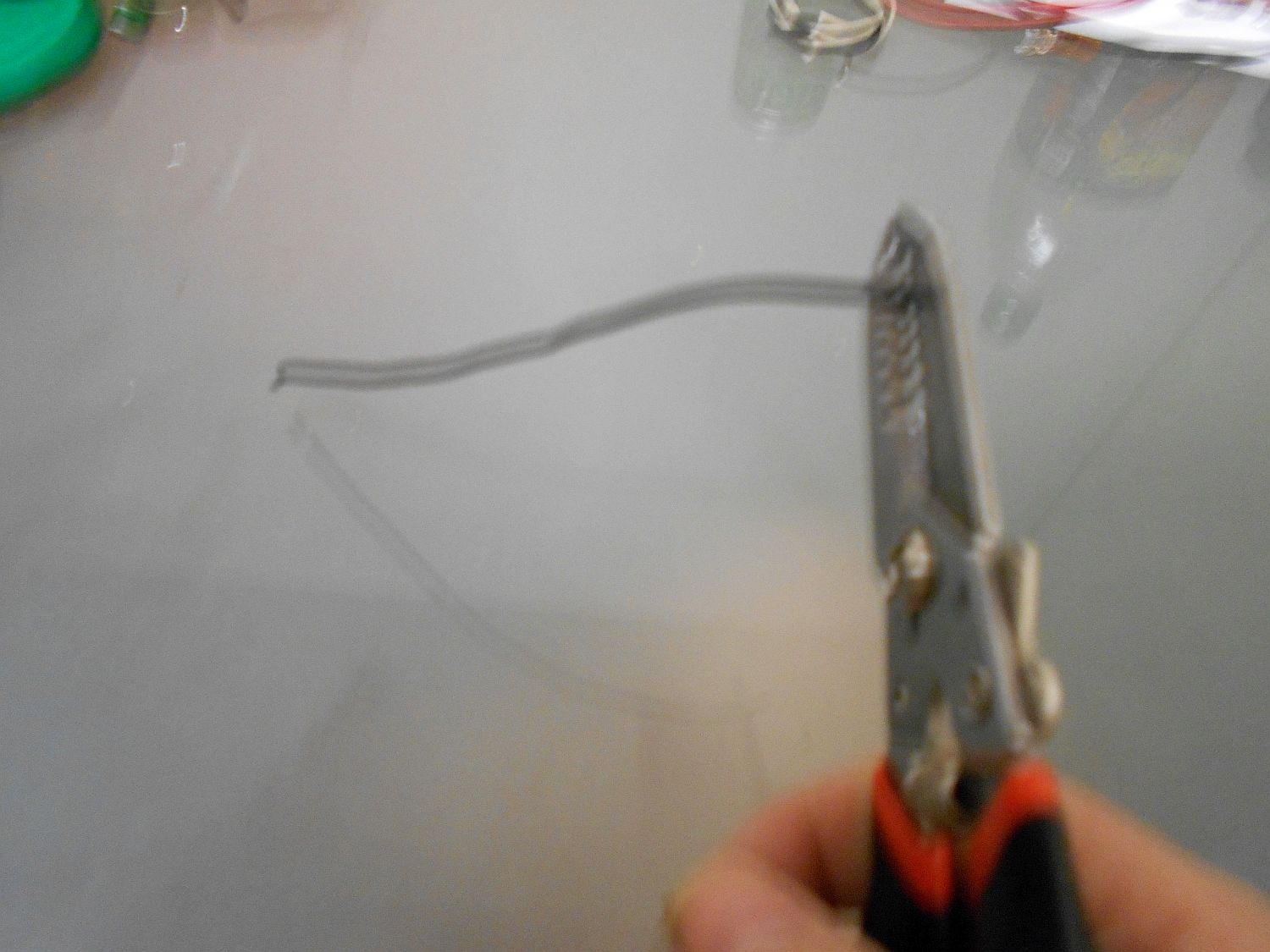

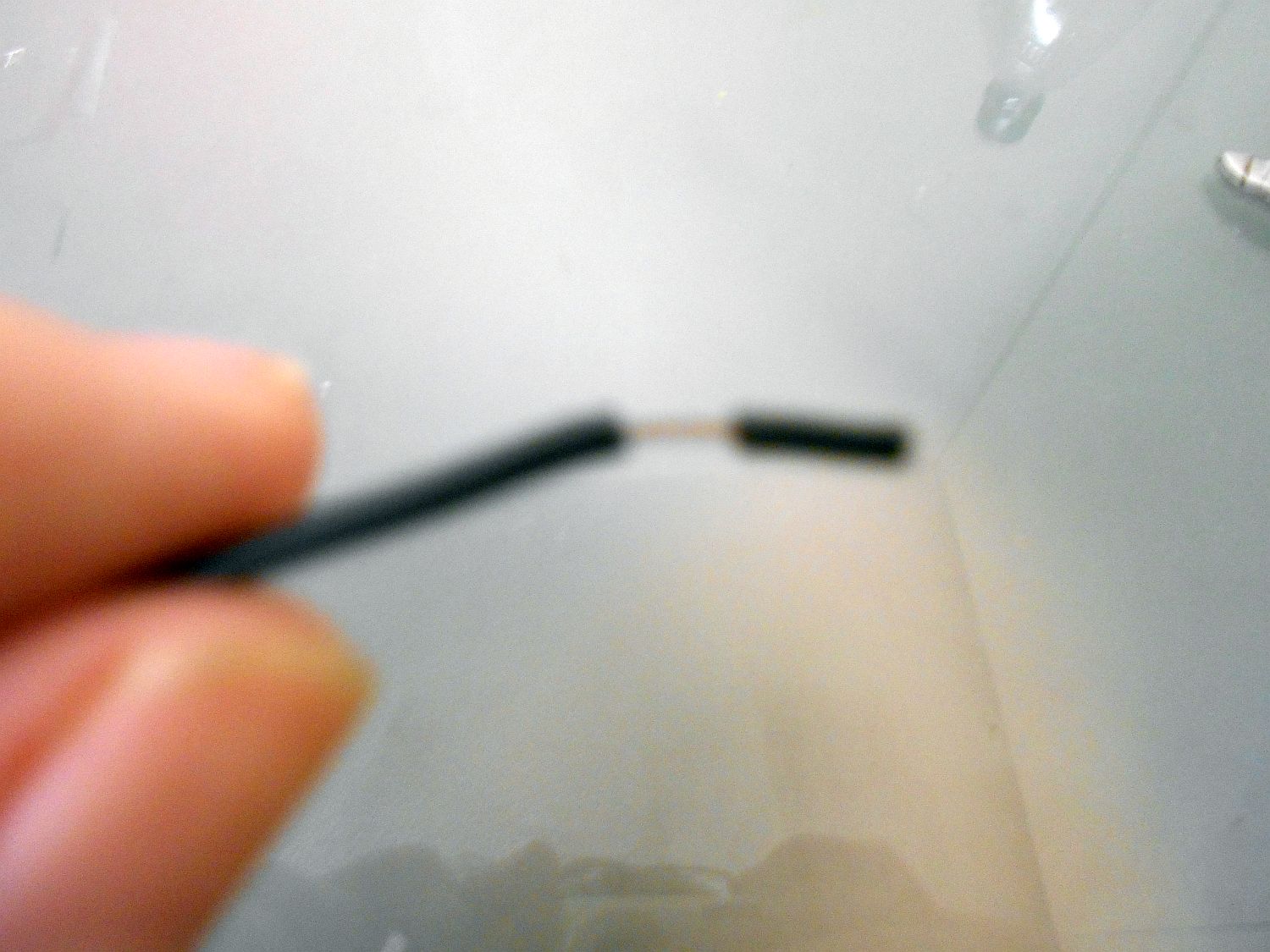

    Strip:
ID:	10230 Click image for larger version.
    I then used my wire-stripping tool to strip about 5mm of plastic insulation off the end of the wire, making sure I didn't completely remove it, then I used the excess insulation to neatly twist the small copper strands together to form one single strand.

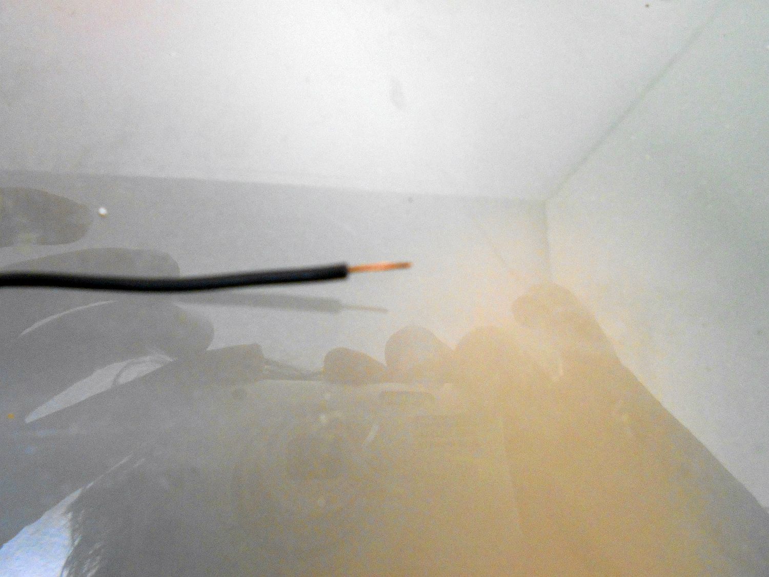

    Twist:
    You can see in the pic how the twisted copper-strands have twisted together neatly, this is what it should look like with no fraying, it should look like a single strand of copper wire.

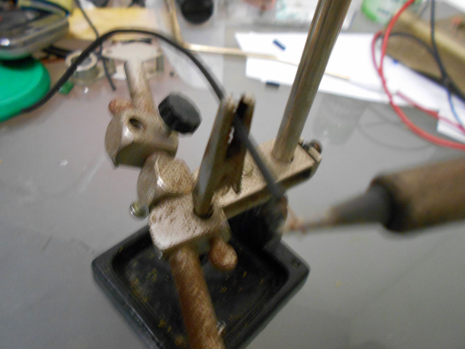

    Finally we come to the Tin-phase:
    When you go to tin the wire, first wipe the tip of the soldering-iron on the damp cleaning-sponge, or a damp cotton rag after applying some solder to the tip, this tins the soldering iron tip so it can heat the joint to be soldered more efficiently, when you actually go to tin the wire, use the tip of the soldering iron to heat the copper strands and then apply the solder to both the soldering iron tip and the copper strands, don't apply the solder to the iron tip and use it to transfer the solder to the copper strand because the flux in the solder will have gone up in smoke and won't be able to do it's job.
    The job of the flux inside the standard 60/40 Electronic Solder is to boil-off any dirt, grease, and oxidation contaminating the surfaces of the metals to be soldered, if the Flux goes up in smoke before it can do it's job, this could potentially create a dry solder-joint.

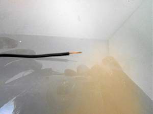

    This last pic shows what the tinned wire should look like:
    The tinned wire-end should look like the above pic, nice and shiny-silver.
    Note that some of the pics may be a bit blurry, I really need to find out if my Nikon A100 Camera has a Macro function and learn how to use it.
