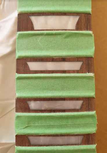

    Got on and sanded the fretboard ever so lightly with 600 grit to remove glue marks and buff out some gloomy spots on the inlays.

    Getting very close to starting the staining. Still looking to ebony timbermate+black dye the entire guitar (ofc leaving the fretboard alone) but leaving the maple veneer to be stained black without timbermate. I know PBG recommend to not sand the veneer, but im going to attempt a red mahogany with the flamed maple top, with a thin black burst around the edges; unless the post mahogany stain impresses me to stop there.
    Also decided that staining then gluing the neck is probably the best bet, and that gives me the chance to do things separately with time being a bit of a constraint at the moment, then after gluing have a chance to restain to fix up any spots etc.

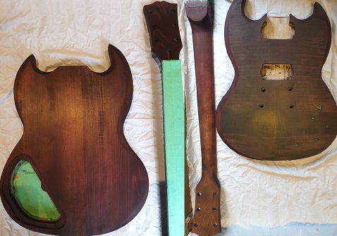

    Sanded down the timbermate and the stained veneer
Name:	Sanding shots.jpg
    Got onto staining
Name:	Stain shots.jpg
