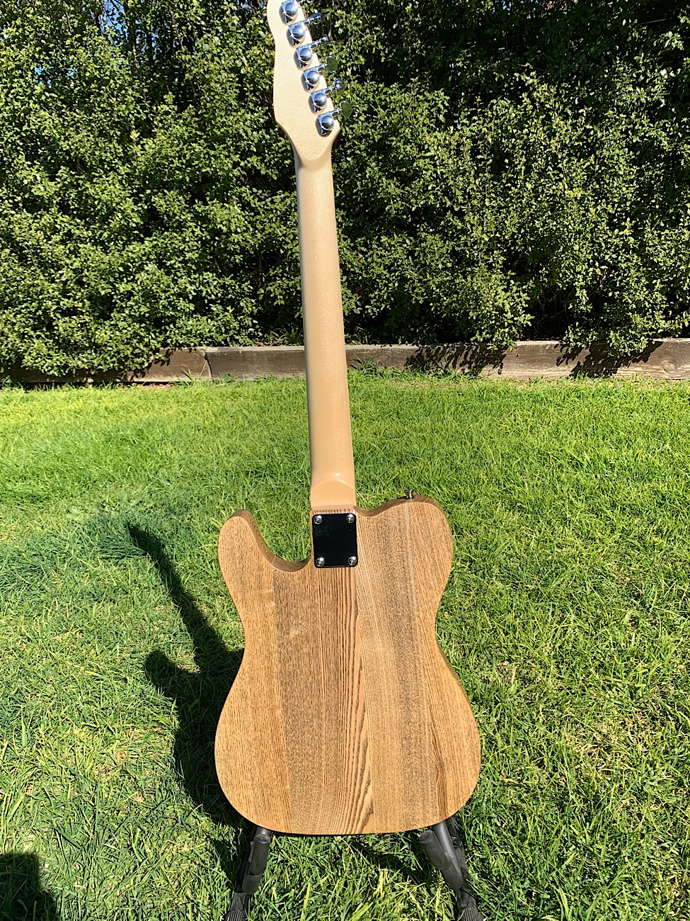

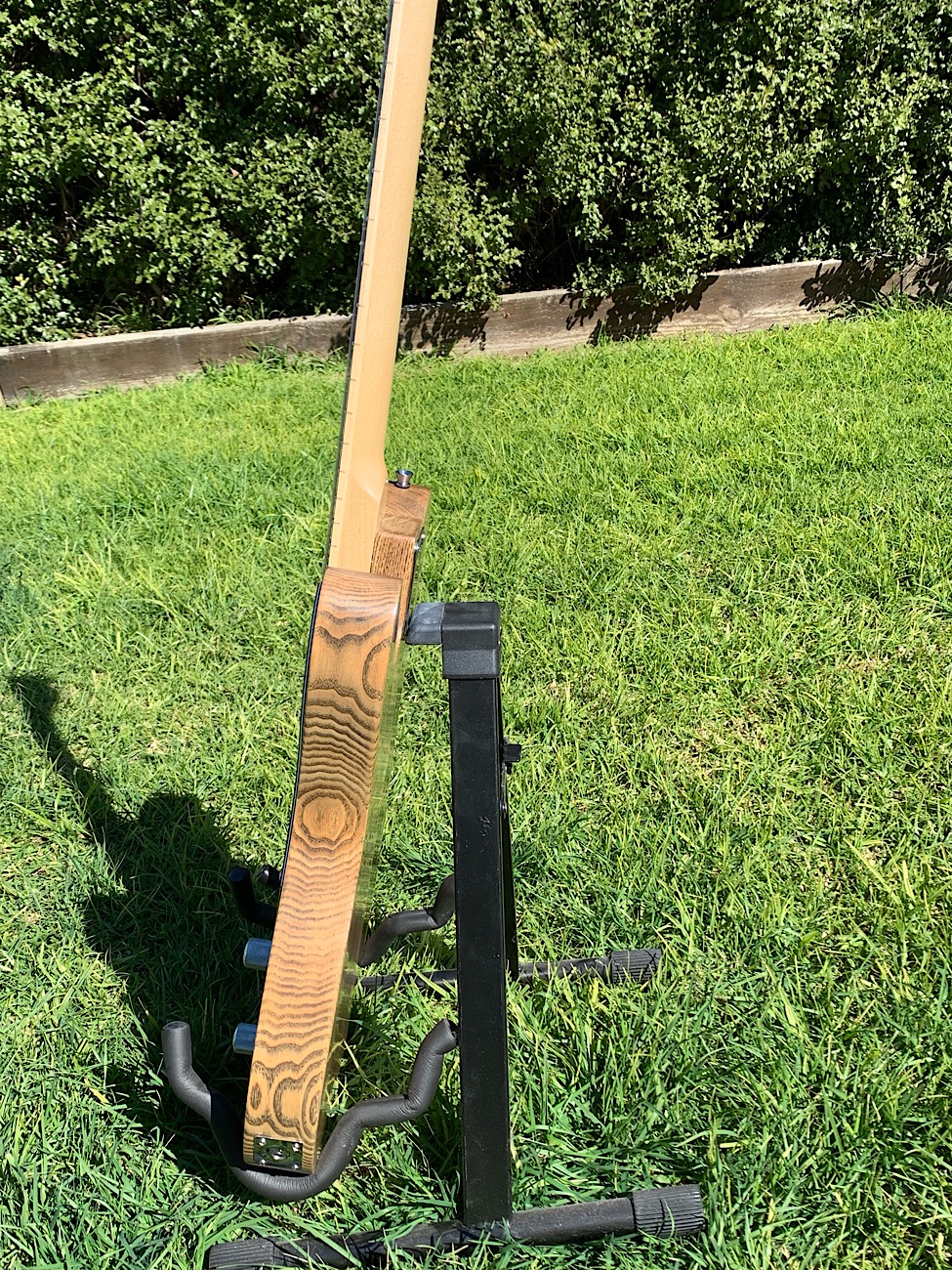

    Almost finished
    Hi All,
    Finished my guitar a few days ago and just playing around with the setup. All in all I am really happy with the end result, it plays and sounds very good to my ear (as inexperienced as I am). I just need to do a little work on the intonation.
    In terms of how the guitar finish looks it spot on to what I had in mind when I started. Huge thank you to everyone who has helped me with this build.
    Took some photos outside for the natural light
ID:	32025   Click image for larger version.
ID:	32026   Click image for larger version.

    Nice work FCD, You'll have to post up a sound demo if you have the facility.

    That looks great! The side grade pattern is really cool with the grain filling.
    With the intonation, it looks like you have plenty of travel in the saddles (presuming nothing is too flat) but remember string action at the nut and bridge (and even neck relief to some degree) can effect your overall intonation. Set the intonation last.
    I always check the tuning of fretted notes in multiple places (3rd, 5th, 9th) and balance them against what the 12th fret is telling me. It's always a compromise to get the best result from each guitar (sometimes called compensated tuning).
