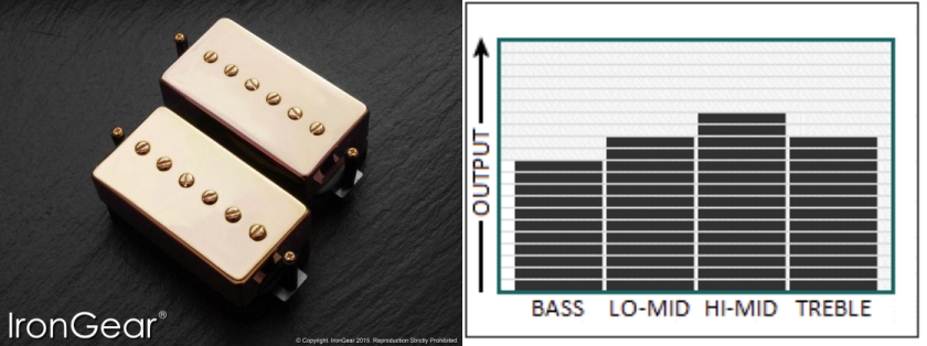

    Also dont forget that you can get P90's in a humbucker size/shape. I have them in a build and they sound great! ( Tone Rider make them) So if you had a kit custom ordered for 3 humbuckers you could put a regular bucker in the bridge, then 2 bucker sized P90's up front. (p90's are big single coils after all)
