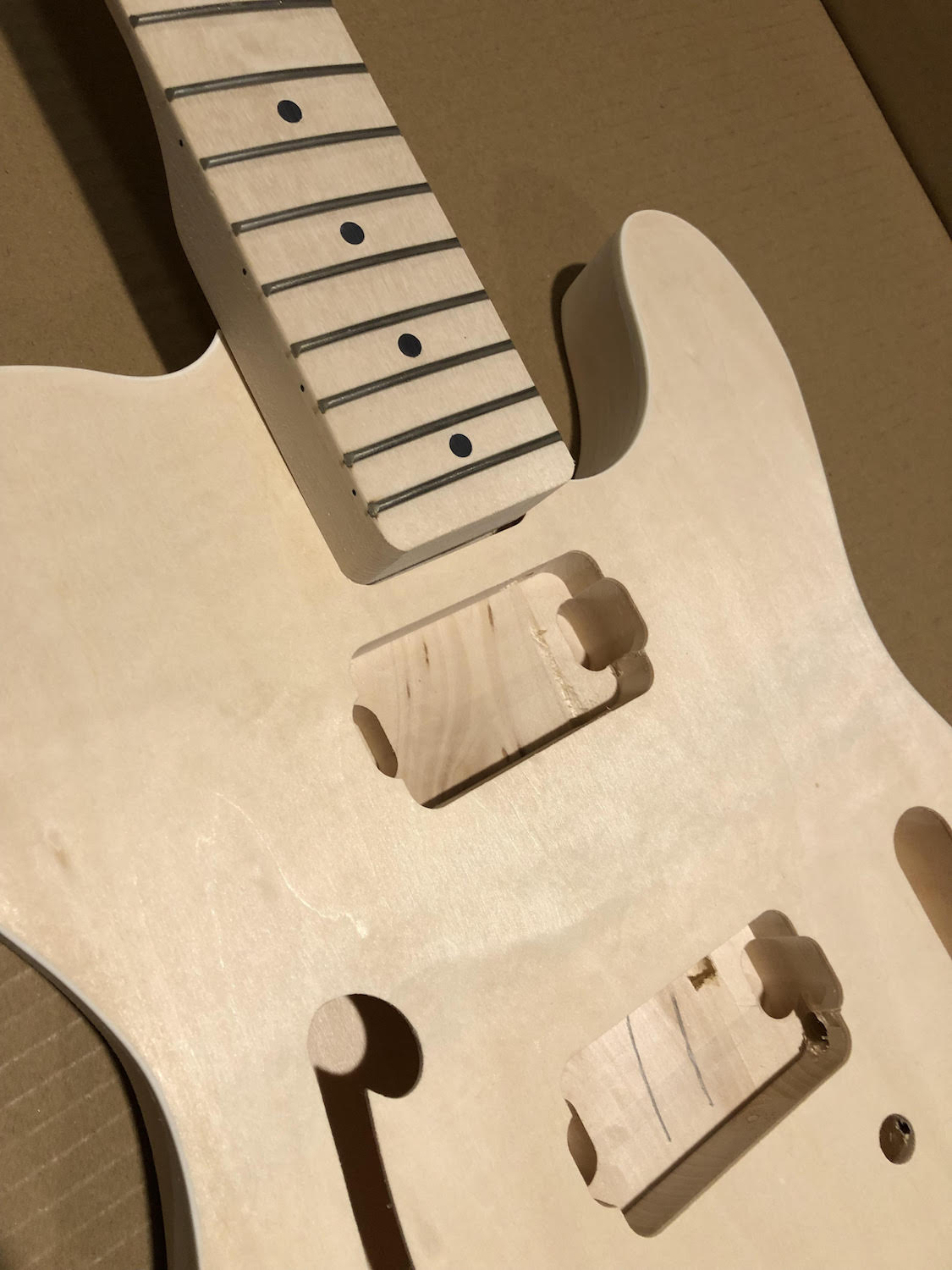

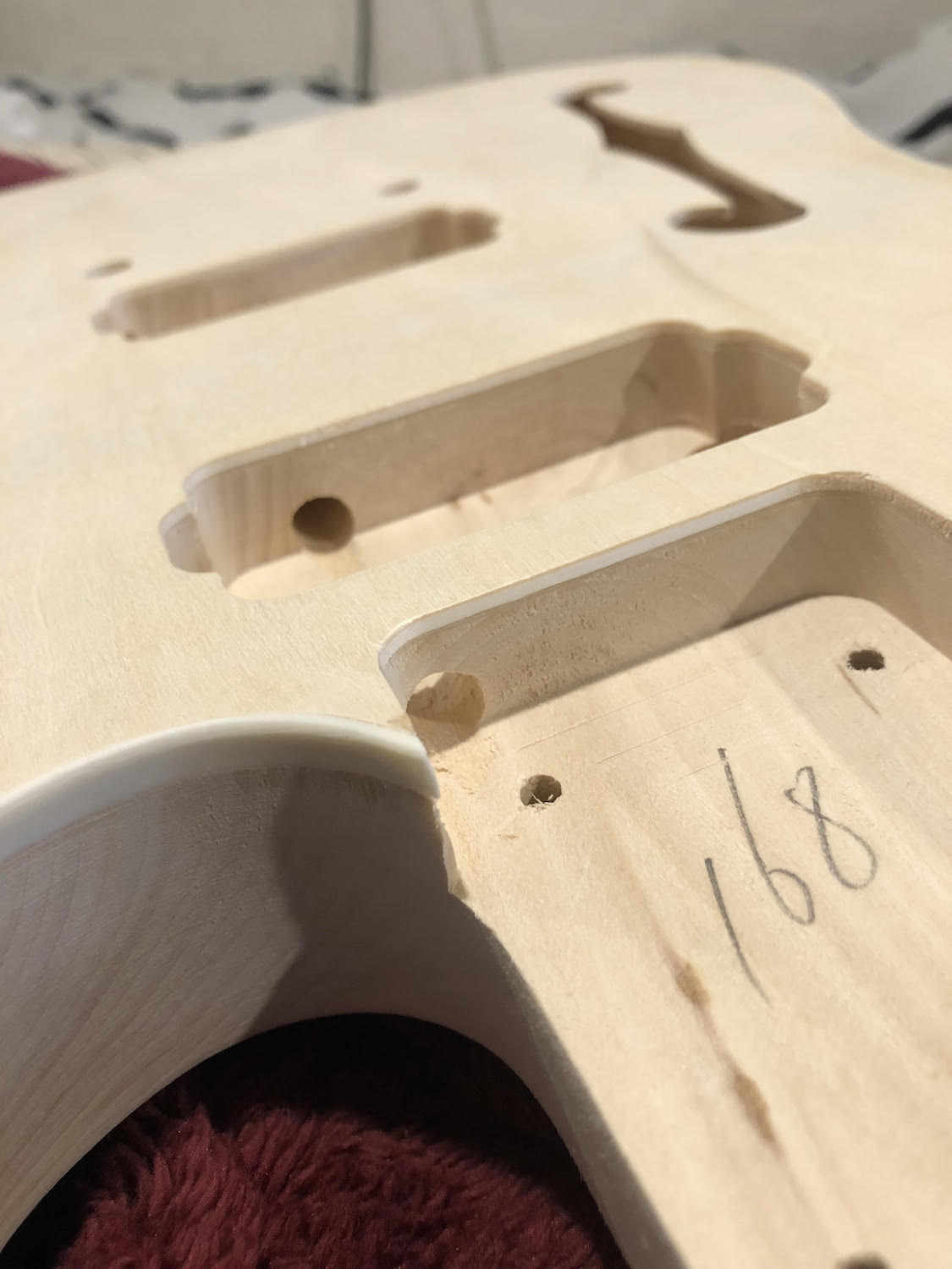

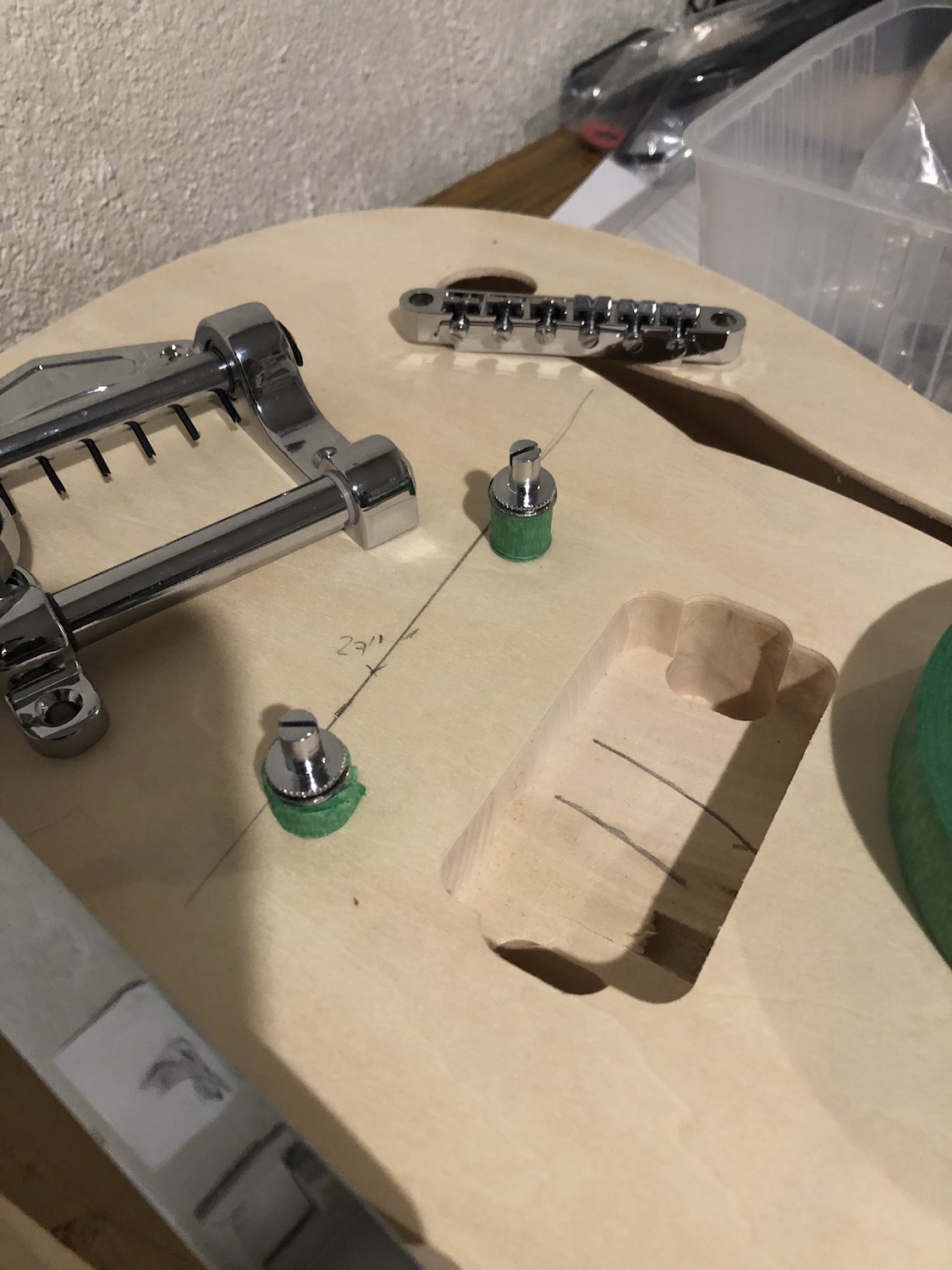

    adding some photos of the body.

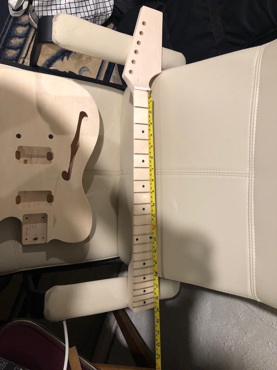

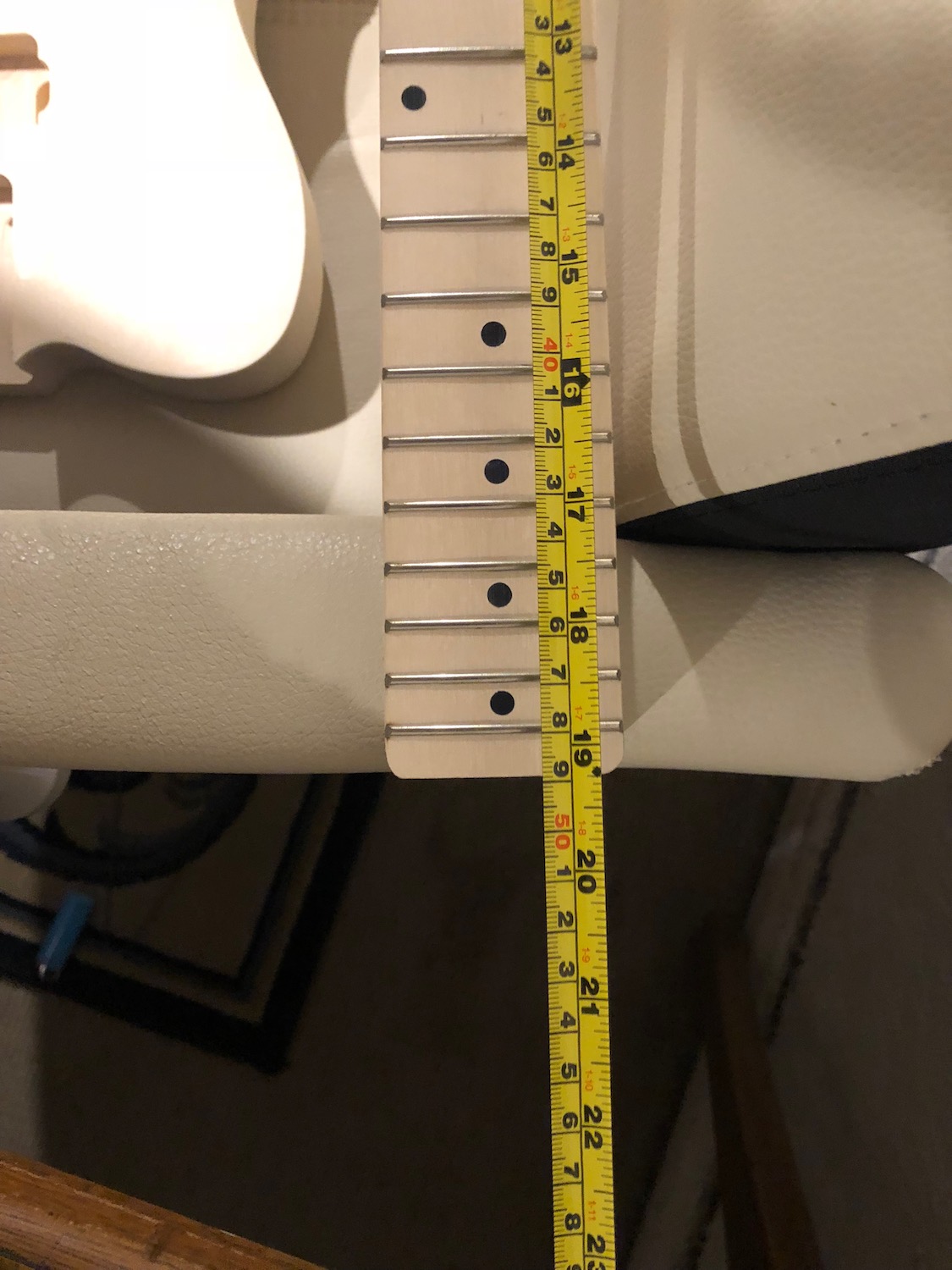

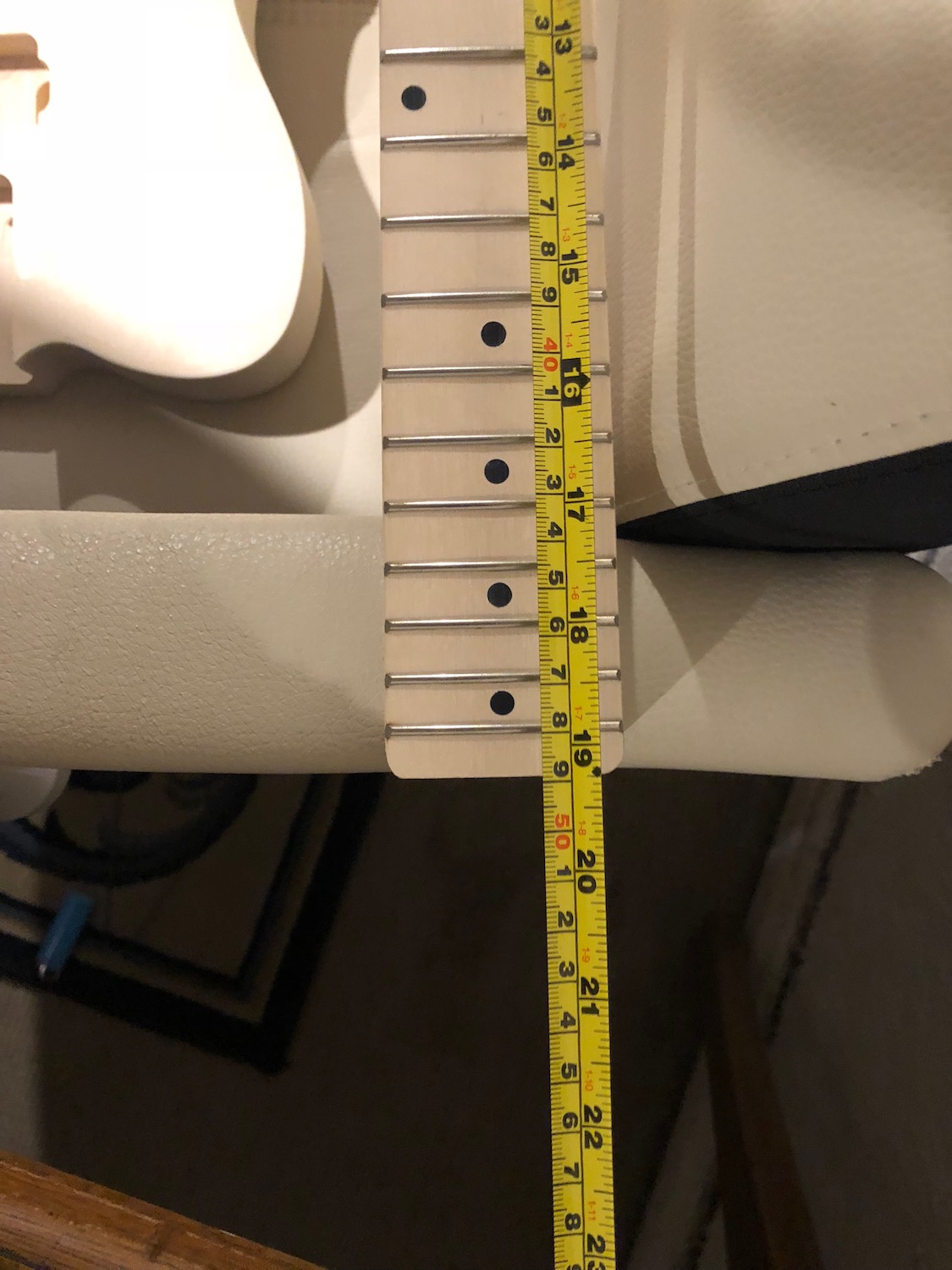

    Was also measuring the neck as I wanted to check its the right scale length (should be 27" and from the look it seemed smaller than I thought it would).
    Again, I'm a complete novice this is all coming from a place of me wanting to double (triple) check everything I do before I move ahead. It would be easier for me to check now than to realise later on.

    Scale length looks about right. Measure to the 12th fret and double. But you'll have to put in the bridge (temporarily with foam or tape rather than the posts) and check the length.
    Sent from my LG-H930 using Tapatalk
    thanks! Yep its about 13.5 so that sounds about right

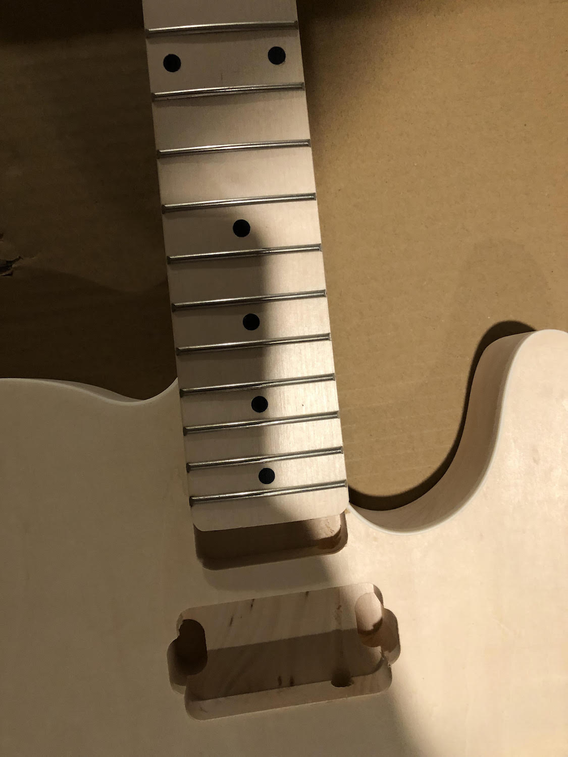

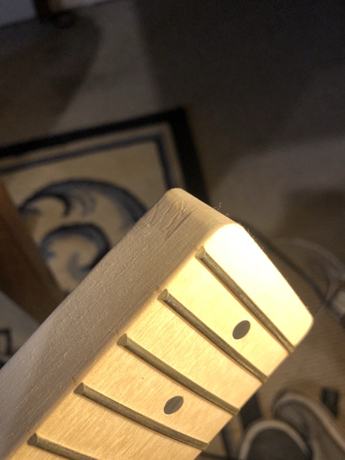

    Now to figure out how to fit it into the socket...
    slow and careful sanding of the pocket. It's usually the sides that are tight. Use a sanding block to keep everything straight. Sand a little on each side, test, sand, test. You will soon get a feel for it.
    How are you trying to fit the neck to the body, sliding in horizontally - your second picture - or pushing down vertically - first pic?
    The neck has a slight taper so you want to be fitting it by lining it up as you have in the first pic and pushing down. Give the kit a bit of time to get used to its new surroundings, temp and humidity make a difference.
    If you need to make an adjustment after that, sand carefully as Deddy has said.
