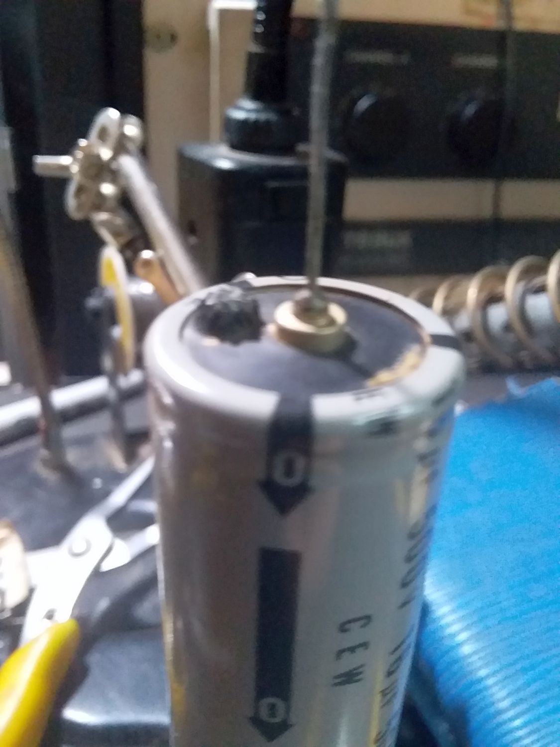

    Update:
    Recently I got in contact with a mate of mine who just happens to do amp servicing, he offered to give me some second-hand 16uF/450V and 22uF/500V capacitors he had pulled out of an amp, but were still perfectly good, so I took him up on the offer, he dropped-off the caps in my mailbox a few weeks ago, and I had a look through them and selected a light-grey 22uF/500V Illinois Cap as a suitable replacement for the 16uF/500V cap that had leaked, I soldered it into place on the eyelet board under the doghouse, then put the Super Twin amp back together and gave it a test-out, the amp seems to be working fine with the replacement cap installed, so that'll do fine till I can get a full set of brand-new caps ordered.
    A pic of the old and leaky cap:
Name:	Leaky Cap_resized.jpg
    Notice how there's an obvious bulge next to the cap's + terminal?, basically what happened to cause that was that, for some reason, the electrolyte inside the cap got hot enough to boil, and because the pressure inside the cap got a bit too much the rubber bung sealing the + end of the cap ruptured, letting the electrolyte leak-out, if you see an electrolytic cap with a slight small bulge in it's rubber sealing bung, or in a similar condition to the one in the pic, it needs replacing with a new one asap otherwise it could cause expensive damage to your amp.
