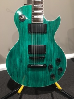

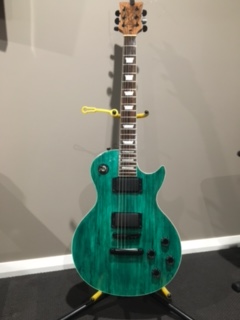

    I have nearly finished my 1st kit guitar LP-1S its been a great experience. I have a few small wiring issues to sort out as I only have the bridge pick up working.

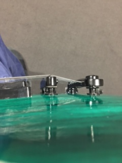

    I have a question about the bridge height. to get the action so you can play with light buzz I have to raise the bridge up quite a way. both pick ups are at full extension and still too far away from the strings which I think is making it quiet.
    to get around the problem with the bridge height has any one shimmed the neck pocket to reduce the angle to allow for lower bridge height and lower action, allowing for the pick ups to be adjusted correctly ?
    thanks in advance.

    The bridge height doesn't seem excessive (have you seen the bridge height on a lot of Gibsons lately?), though lower is always better. Looks like you could bring the stop bar down a few turns.
    Your bridge pickup doesn't appear to be that far away from the strings, so I can't see that being an issue for the guitar output being low. But I don't know anything about the stock pickups that come with the kit, and what output they should have.

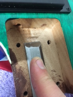

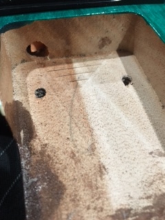

    I found some of the routing was preventing the neck from seating properly, so I cleaned this up with a chisel.

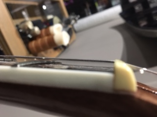

    I included a photo of the nut height let me know what you think if I need to lower it or not ?

    good work Adam you are heading in the right direction. The nut does look too high so I would carefully remove it and sand it on sandpaper that is on a flat surface and I try and lean it up against a square block of wood so it remains as square to the sandpaper as possible. I'd put a pencil mark try lowering it about 1mm and see how it goes after that. It may need to be lowered further.

    Ive levelled the frets and done a little more cleaning in the neck pocket. while I had the chance I measured the neck angle. it started out as 6 degrees as in the photo, after a little more cleaning its to 4.5 degrees. I also took the advice to lower the nut height by 1mm. this has reduced the action at the first fret to about 0.75mm. So after setting it up a again and testing it out the bridge I can get slightly lower but not much. Both E strings is where my buzz comes from now, all of the other stings ring out really well its just the Es that sound a little dampened mostly higher on the neck. I could fix this by raising the bridge height but im trying to get it lower as the neck pick up is at full extension still. I take it upgrading the stock tune-o-matic bridge is the only way to adjust the action in each string independently ? over all im really happy with how its turned out. a new set of heavier stings to match my other guitar and play it for a while until I learn a bit more. thanks for you help guys.
