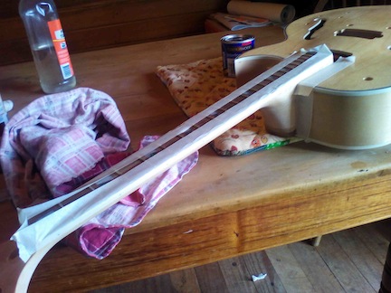

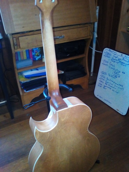

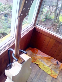

    Finish neck fail and recovery
    Ok, Mask neck binding and apply tinted varnish.
    Two coats.
    Decided I didn't like it. Much sanding later and application of stain without varnish.

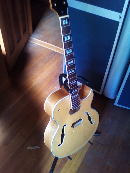

    Looking a bit more like a guitar
    Several clear coats of Aussie Oil rubbed onto top. Walnut stain back and sides. Headstock face painted black.

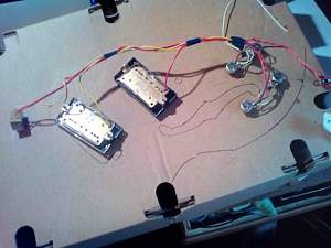

  3. #23
    Member Taswegian's Avatar
    Apr 2016
    Tasmania
    28

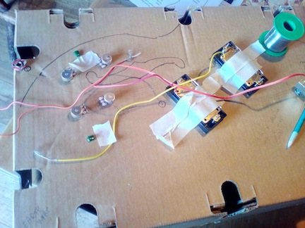

    Fruit of the Loom
    Heat up soldering iron.
    Before:
    After:
    Figure everything can fit in through pickup holes.
    After this photo I added an extra ground wire to the back of all 4 pots.
    Maybe I will redo all this one day with shielded wire. It's great fun putting it into the guitar!
    --- Over what hill? I don't remember any hill! ---

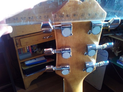

    Tuner Day
    Trial attachment of tuners. When I finally drilled the holes for the little screws I forgot I was going to align them all horizontally.

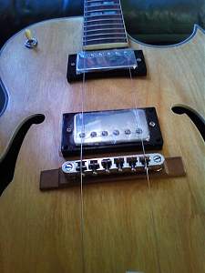

    28

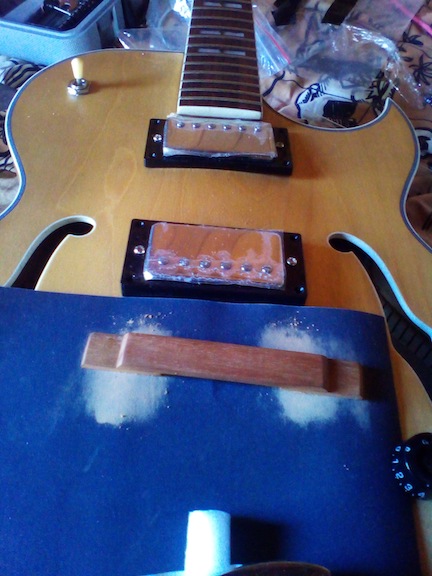

    "Fake" Floater
    You may recall that the neck angle was still slightly askew but thought that a floating bridge or renotching the bridge saddles would get it right. Had an idea for a sort of fake floating bridge.
    1. Remember to drill an extra hole for an earth with to the tailpiece because I'm not using the stud mounting inserts.
    2. Some strips of hardwood, blackwood I think or maybe myrtle, glue together and sanded to contour.
    3. Holes drilled for studs.
    4. Threads cut with bolt.
    5. Voila
ID:	32390   Click image for larger version.
ID:	32391   Click image for larger version.
ID:	32392   Click image for larger version.
ID:	32393   Click image for larger version.

    However quite a lot of sanding to get action down. Also I ground the bottom off the ABR to make it flat.

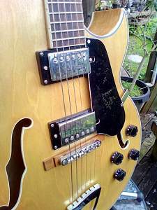

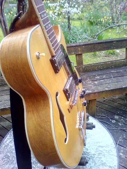

  8. #28
    Apr 2016
    Tasmania
    28
    Thar She Blows
    Finished maybe. Still touching up fret ends and whatnot. Very low fast action. Plays really well.
ID:	32398   Click image for larger version.
ID:	32399   Click image for larger version.
ID:	32400   Click image for larger version.
ID:	32401   Click image for larger version.
