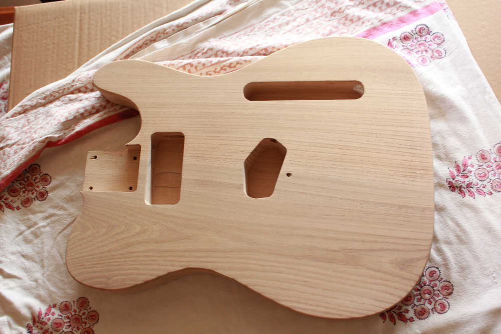

    Grain-filling and final sanding are done! I went with the Timbermate 'Walnut' colour. Overall the effect of the grain fill is pretty subtle - not sure if I'd do it again on a future build, but I might change my mind once the stain goes on.

    Tomorrow I'm hoping to apply the first coat of 'Coolangatta Gold'.

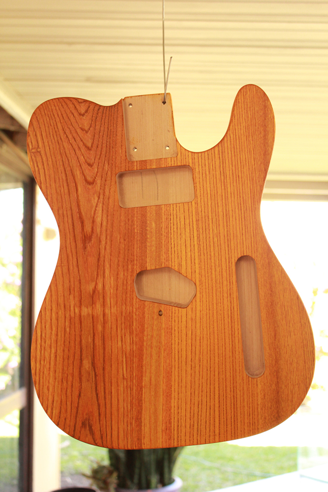

    Here's the body after applying the 'Coolangatta Gold' stain. It's a bit more orange than I was expecting but I'm still pretty happy with the result.

    There is a small patchy area on the front of the guitar - I'm not sure what has caused it, or whether it's just part of the grain? It wasn't noticable after sanding but has shown up once the stain went on. I'm not too concerned but if anyone has an idea of what casued it or how it could be treated then I'm all ears.

    Quote Originally Posted by Ralphile View Post
    I think that is all part of the fun. Waiting to see what colour the stain will end up as when it reacts with your bit of wood.

    Those lighter patches are evidence of the stain not being "taken up" in those particular spots. For some reason in those areas the stain did not penetrate. The most likely cause is residual glue in the wood fibre. You can open up those fibres gently using a brass toothbrush, and re-apply the colouring in those areas carefully to blend them out.
    Id be tempted to attempt another application on the right hand side of the body as well, as that slab is considerably-lighter than the other.

    - Tried to use the wire brush technique to open up the grain on the patches in the body finish, but without any success. There doesnít seem to be any residual glue so it might just be a quirk of the wood grain.
    - In any case, Iíve moved on with another coat of stain to the lighter side of the body as suggested, and put on a couple coats of intensifier (I think one more this weekend should do it).
