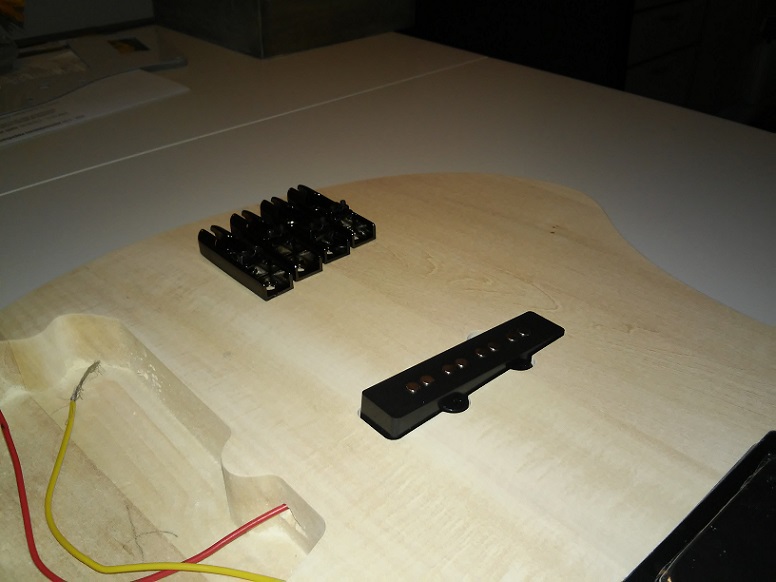

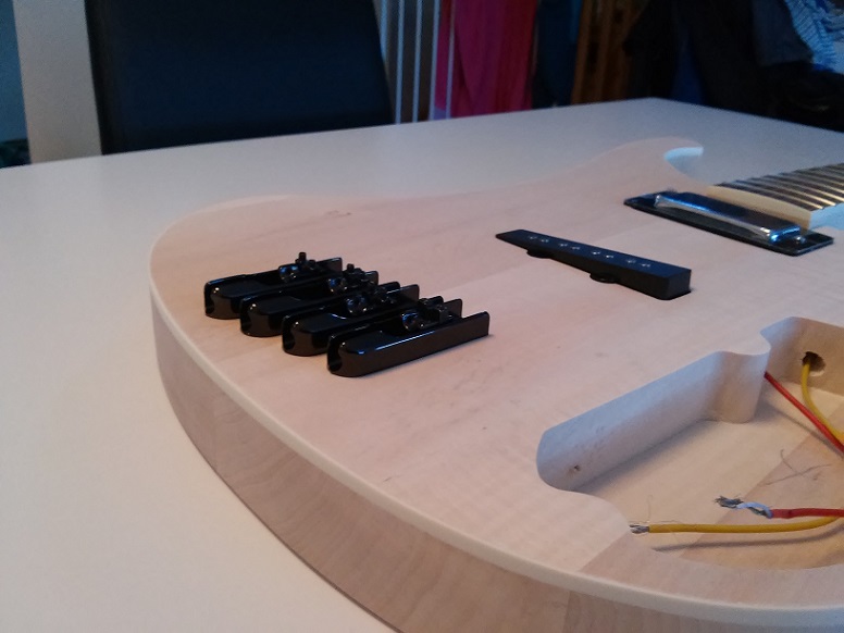

    I got my bridge replacement today and did a mock build to see how they would look. Ordered a five strings set so I would have spare parts if one was broken or if I break one myself (has happened before...) Took about 10 days to arrive at the local post office. When ordering these you never know it might take anything from 7 to 60 days to arrive. Easier to estimate the delivery time or product quality if customers have given feedback on the site.
    The pics show what I had in mind. So far when adjusting intonation on my other two basses, the saddles moved like shown in these pics - moving further from the neck when dropping down to E-string. So I figured if I place my G-string saddle 430mm from the 12th fret (nut to 12th) with approx 1/3 wiggle room on the neck side of the bridge - then placing the others about 2-3 mm further like in the pics when moving to E. This way I would make sure I have enough room on the last saddle to adjust the E. This is IF this is the way it goes with this one too. Tried with a fishing line if the bridges were high enough for the strings on the neck and they seem to work well.
    Also I took out the pickguard material I ordered for the other bass I have built but then decided not to use it. I think it would look good on this one. The shades of black on the pickguard are quite similar of what I had in mind for the grains on this body and neck. AT least thatīs what Iīm trying to achieve. And with high gloss TO surface the pearl would look nice. Same material I was going to use to make a ring for the J pickup - shape it a bit to go nicely with the pickguard. Might be too much to try blending both pickups with in one pickguard? covers too much of the body surface in my opinion.
