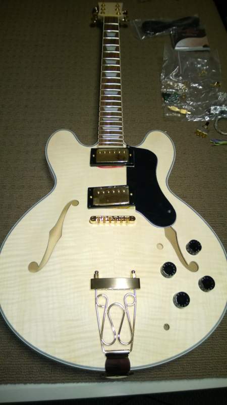

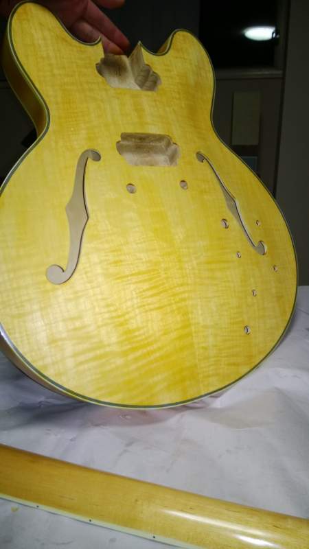

    Well here goes, my very first build.
    All the parts are present and accounted for and in good condition. The maple top looks great, maybe the gold looks a bit cheesier than expected, but I am think about swapping for Toneriders anyway.
    I'm a little bit worried about getting all the electronics through the f-hole and maintaining all the solder joints etc, but am sure its possible.
    Pictures are of a dry assembly to check inventory and general fit, then with a few layers of Shellac.

    Mentor vh2580's Avatar
    Cleveland Qld
    1,184
    Lovely cap. The shellac looks cool.
    As a tip before you install/ wire check your pot in the nearest hole for height so you only have to do it once and work out spacers etc.
    I installed mine and didnt realise till later when i fitted knobs that they sat way off the body due to the thinness of the top.
    Pulling pots out and trying to reinstall ended up with lots of broken connections, resoldering and frustration.
    Theres a few different methods to install in the forums so have a look through some of the build diaries for the ES.
    Tony

    Welcome and enjoy your first build! Nothing beats the satisfaction at the end when you plug in the axe and crank it up! Like the shellac

    I'm about to start one of these and have also upgraded to gold AC4 Toneriders. Tony makes a good point about checking the pots for fit. You could probably find some extra nuts for the pots so you can set the spacing easily. This method of mounting is best for pots and switches as it doesnt apply any load to the top of the components body. I've broken a few switches that way and always use two nuts now with no more problems.
    That shellac looks real good. Can't wait to see this finished and strung up. Good luck and have fun!
