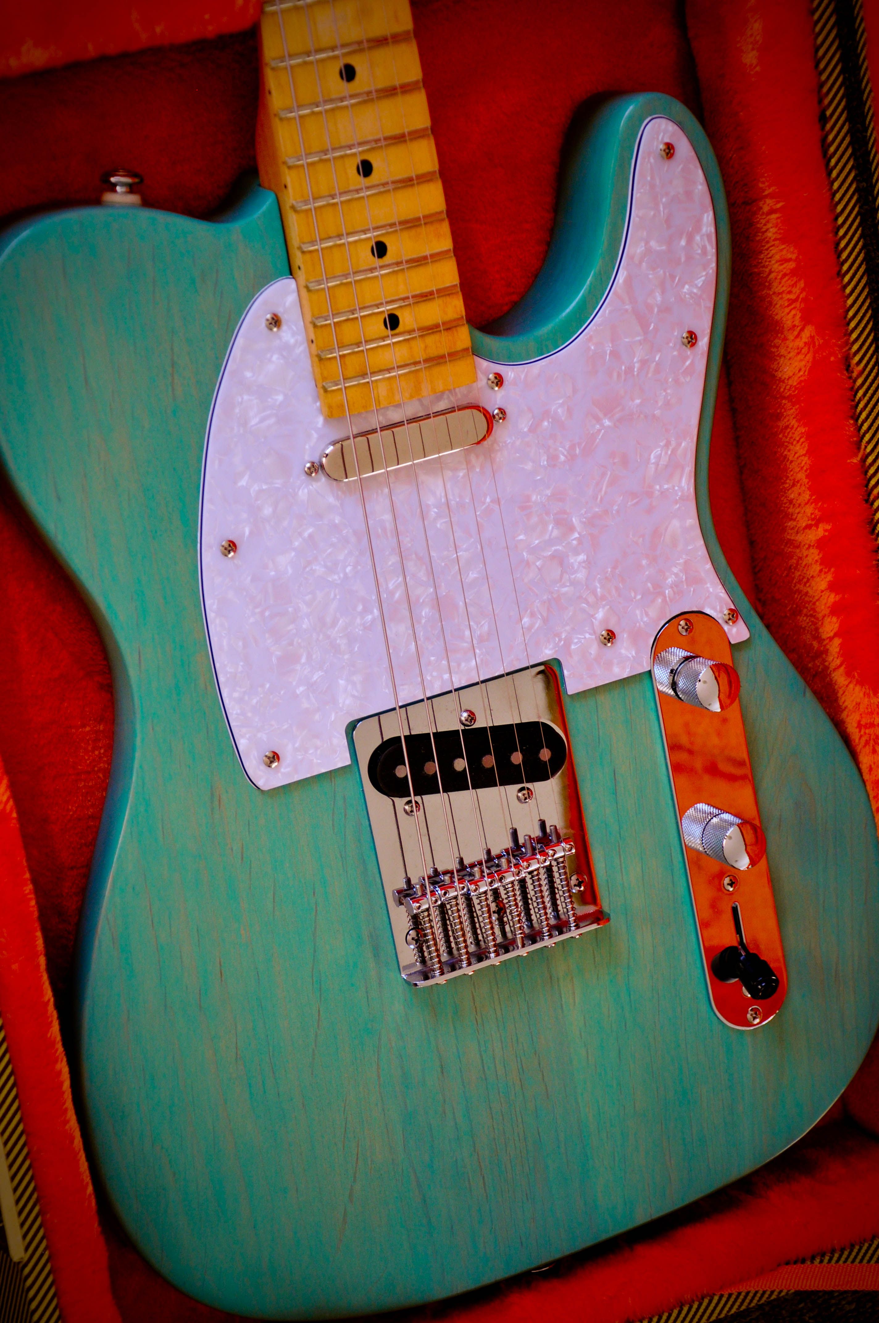

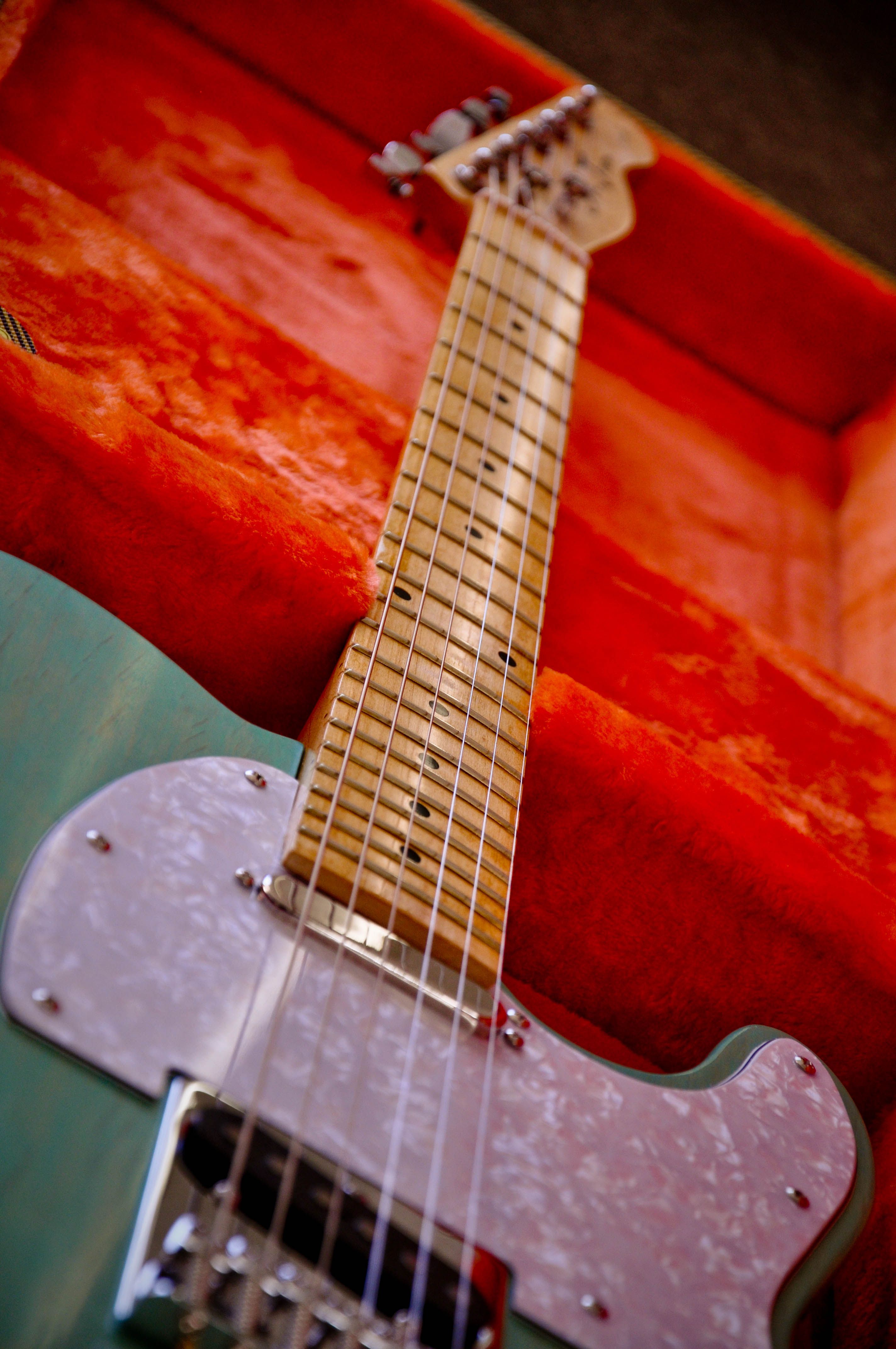

    Tele finished in Surfer Girl and Amber.

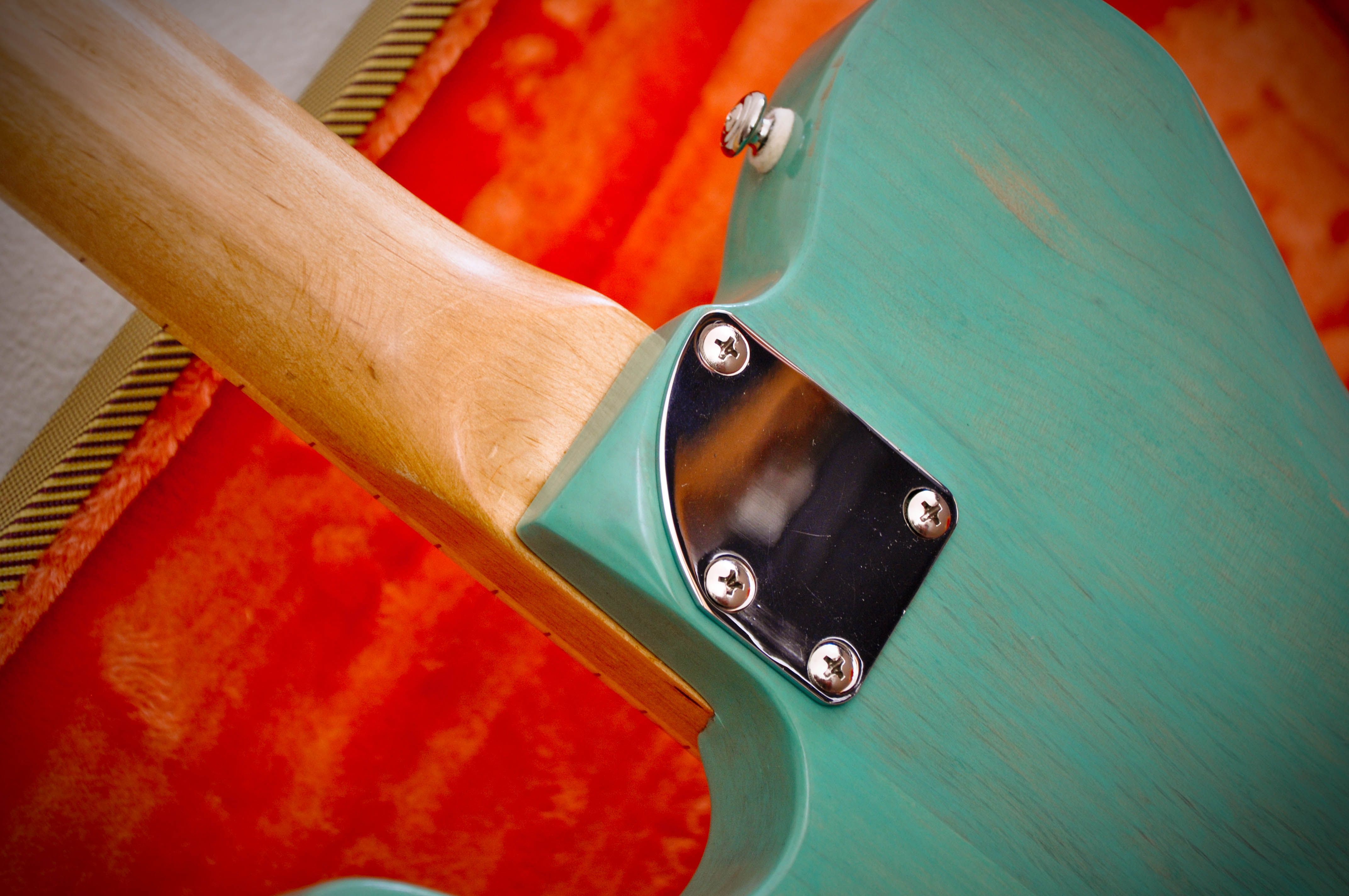

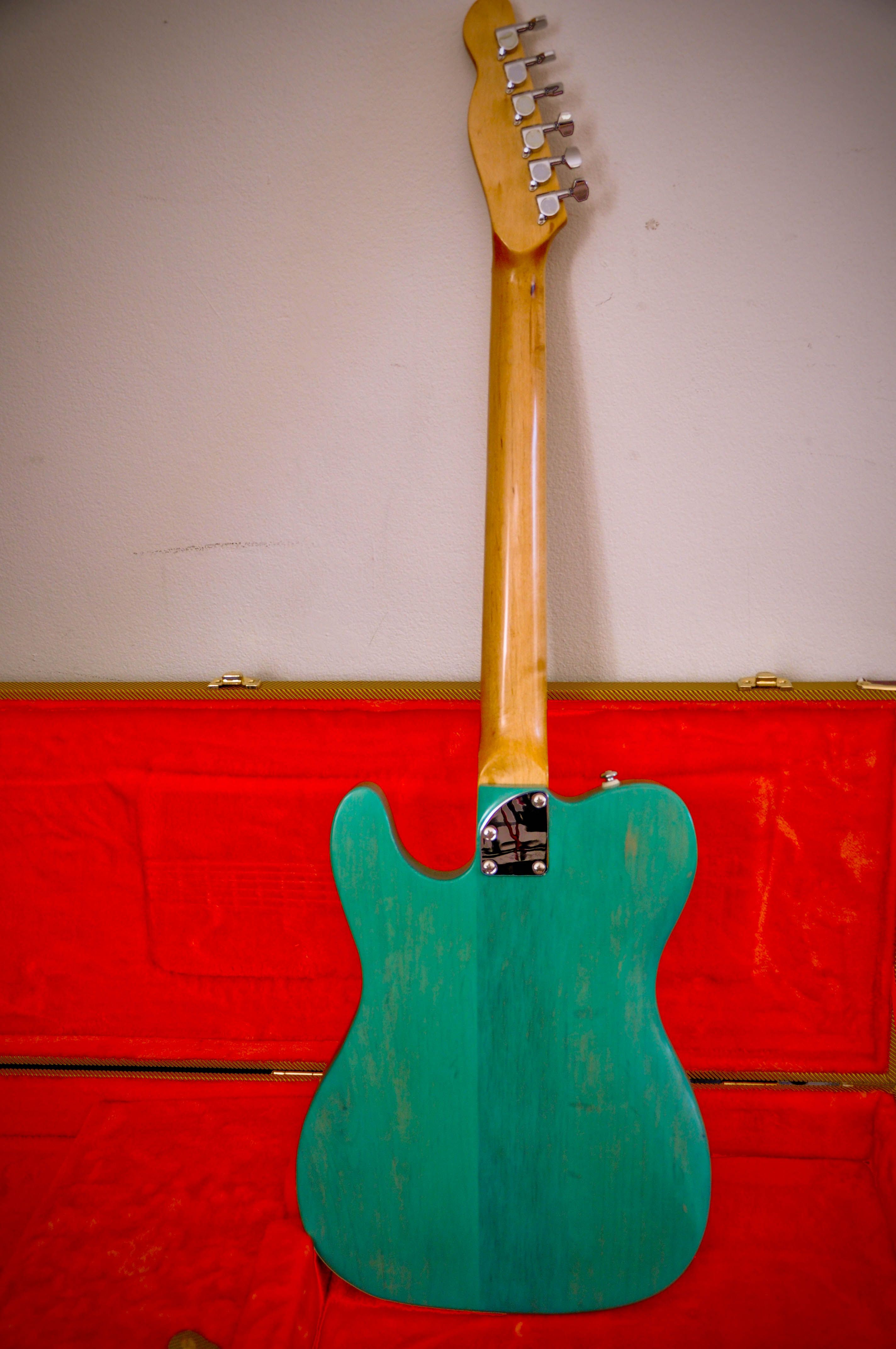

  10. #8
    Feb 2016
    victoria
    20
    When you say surfer girl and amber has the amber been put on the body as well?
  11. #9
    Quote Originally Posted by mark h View Post
    Nope amber was on the neck. The alder didn't absorb the surfer girl that well and there were areas that were blotchy. I've since refinished it to a solid Seafoam green colour. Will post pics soon.

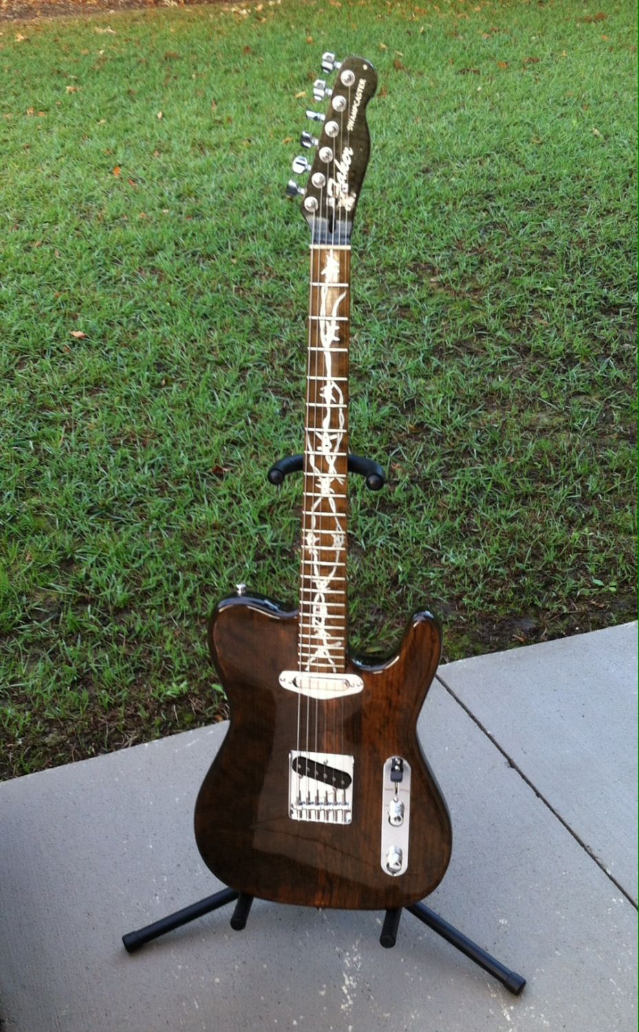

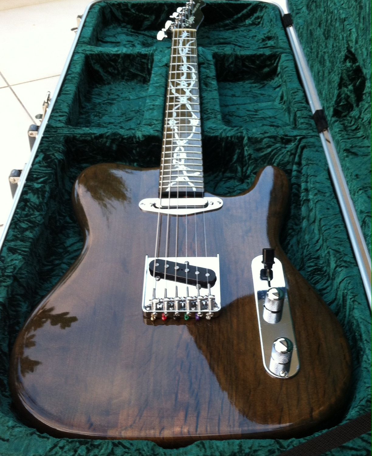

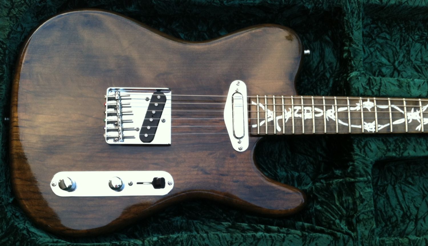

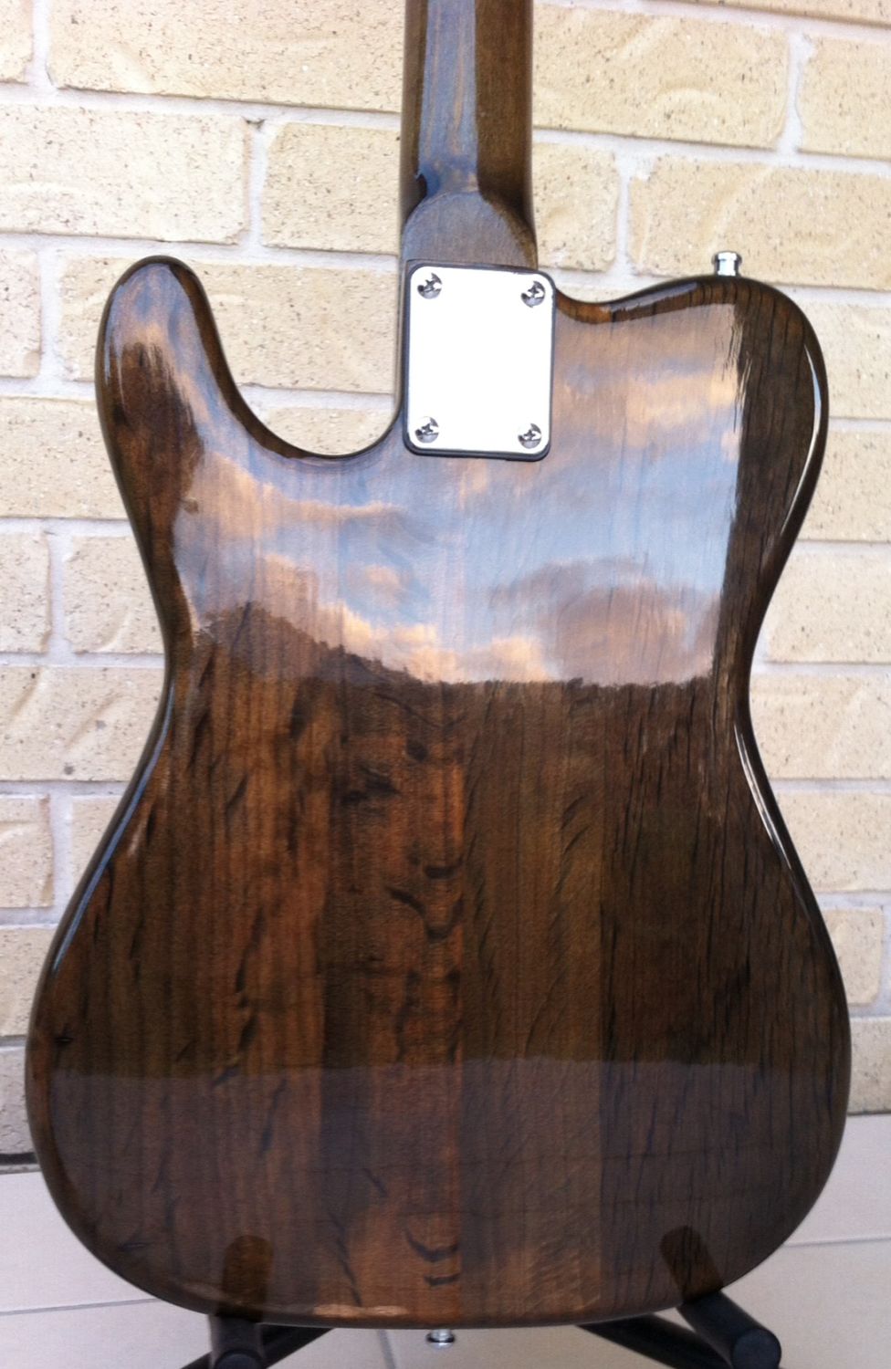

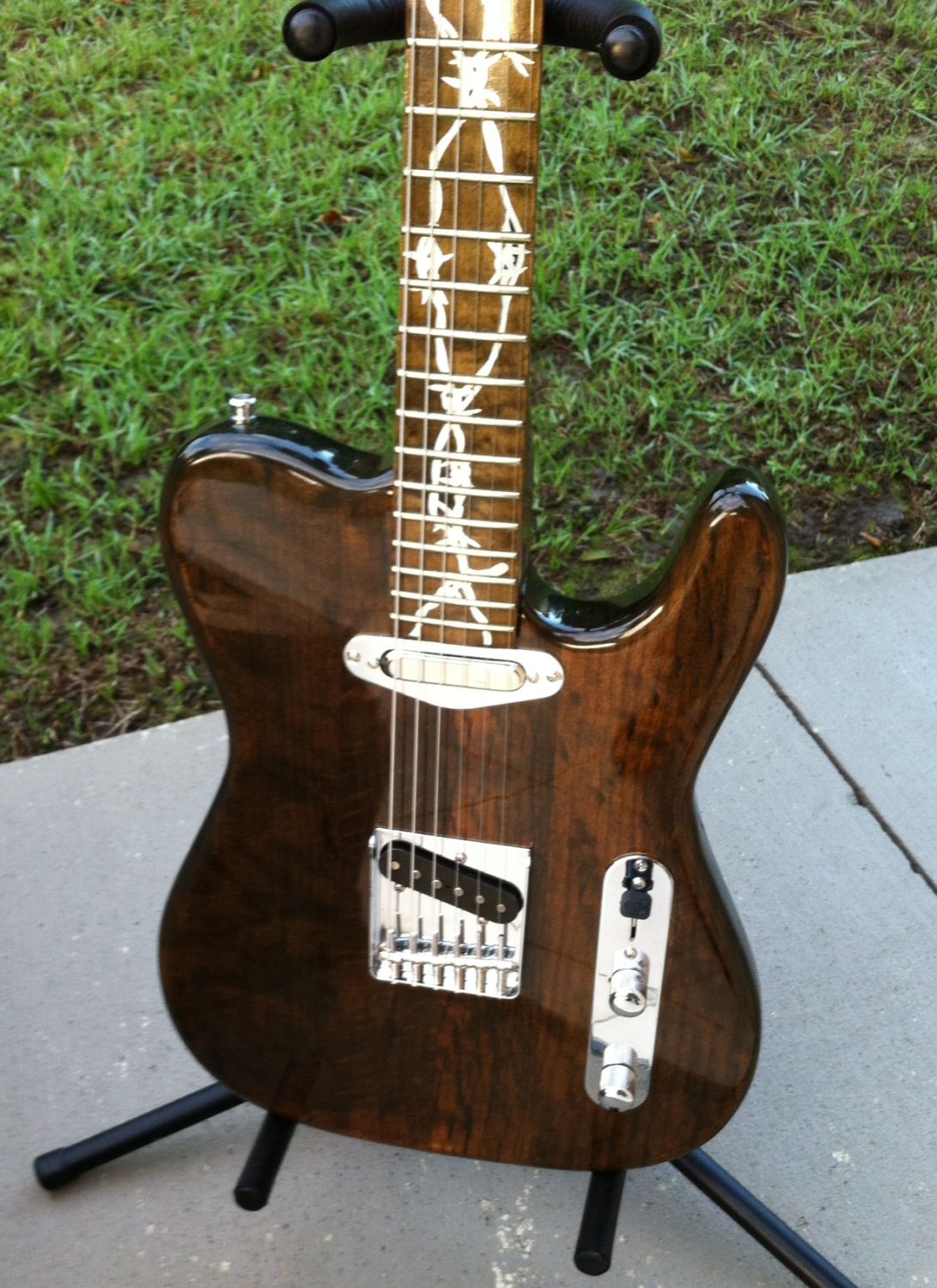

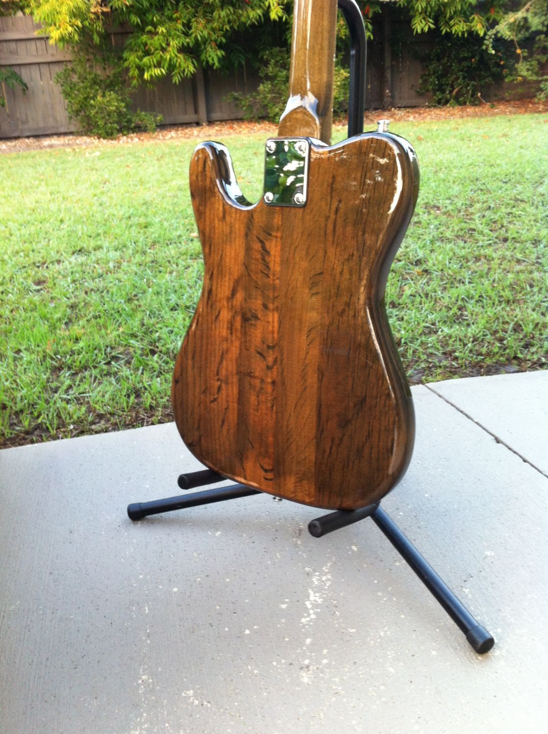

    TL-1A 'Swampcaster' http://www.buildyourownguitar.com.au...t=6792&page=17
    Body Finish: Chemical Wash stain with plenty of Tru Oil top coats.
    Neck finish: Chemical Wash stain with plenty of Tru Oil top coats, Metallic Fret Board inlay sticker kit, Chrome Nail Polish under reversed out logo printed on waterslide decal paper.
    Upgrades/Modifications:
    Real Parts 6 saddle bridge
    Gotoh tuners
    PBG Bone Nut
    Tonerider Vintage Classic Pickups
    Bourns mini 250k pots
    Oak Grigsby 4 way switch where 4th position is neck & bridge in series
    Black Top Hat PUP selector switch tip
    Orange Drop cap
    Schaller style strap locks
    Recessed Chrome Electrosocket mount with a Switchcraft jack
    Chrome Neck Pickup Mounting Ring
    Copper shielding
