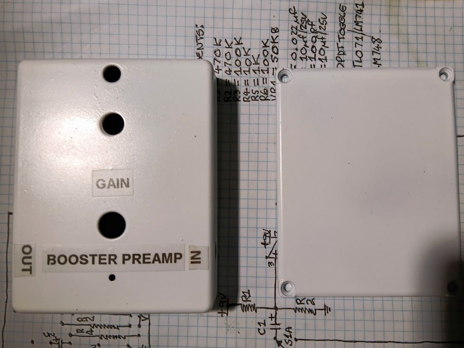

    Made some more progress on the booster pedal build, both parts of the diecast aluminium case have been spray-painted with flat white prime n paint spraypaint, just waiting for it to dry so I can do the labelling and satin clear-coating, and then it'll be ready for the final wiring-up and testing.
    Update_2:
    I gave the two parts of the diecast aluminium case a spray with some satin clear coat after applying the paper labels I made with my Labelmaker, I think it looks pretty good so far, just need to let it dry overnight and then tomorrow I can do all the final wiring-up and testing.

    I was wondering how you planned to label it. I am slowly working up to doing one for a double footswitch. Thinking of using waterslide decals.

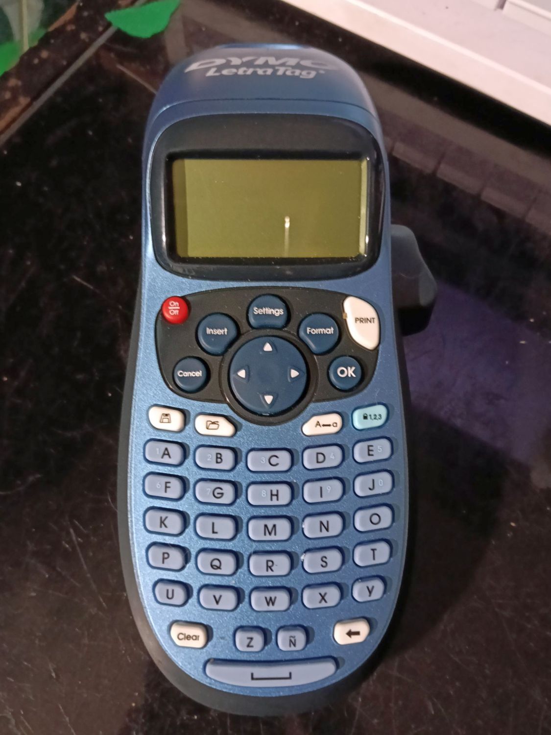

    I used some white paper labels I made using my Dymo Labelmaker, very useful little device, though they can be a bit expensive.
    My Dymo Labelmaker:

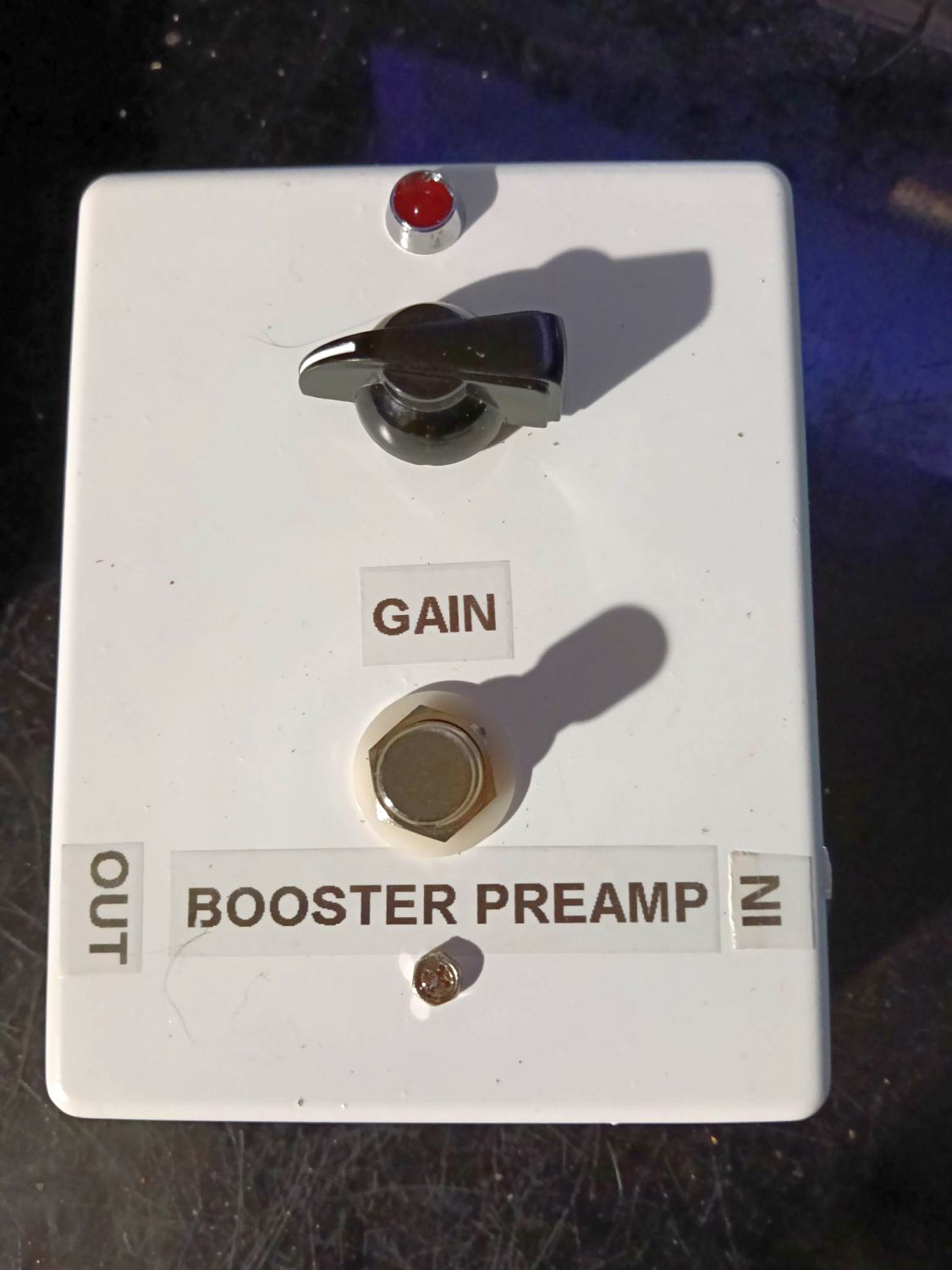

    The finished and working booster pedal:
Name:	Booster Pedal_3_resized.jpg
    I managed to give my new Booster Preamp pedal a quick test out last night with my Fender USA Stratocaster going into the audio interface of my Studio PC, I had it going through FL Studio's Hardcore plugin which is a virtual pedal board and amp simulator, one thing I did notice is that at the lowest gain setting it still boosted the signal a bit, when you turn up the gain it really comes alive, my Fender USA Stratocaster has a set of three Fender Noiseless Single Coil pickups installed in it, they tend to sound a little weak to my ears, but when put through the new Booster pedal, they definitely sound like they benefit from having their output boosted, but it's a different tone than what I get when I try boosting them with my TS-9 Tube Screamer, the natural sound of the Noiseless pickups seems to come through along with the boosting, I noticed that when I was testing the pedal with my Digital Scope, if I fed in a 1Vpeak 1kHz Sinewave, the output signal was a bit greater than 3Vpeak.

    I tried playing my Fender USA Stratocaster through the preamp booster, into my Marshall amp, wow, the booster pedal really kicks things up a few notches, works great.
