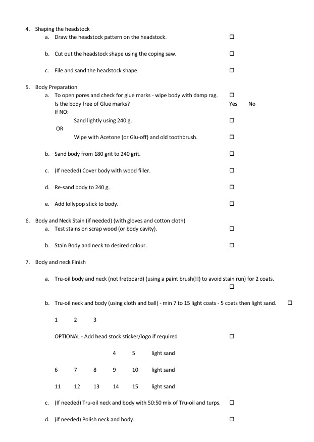

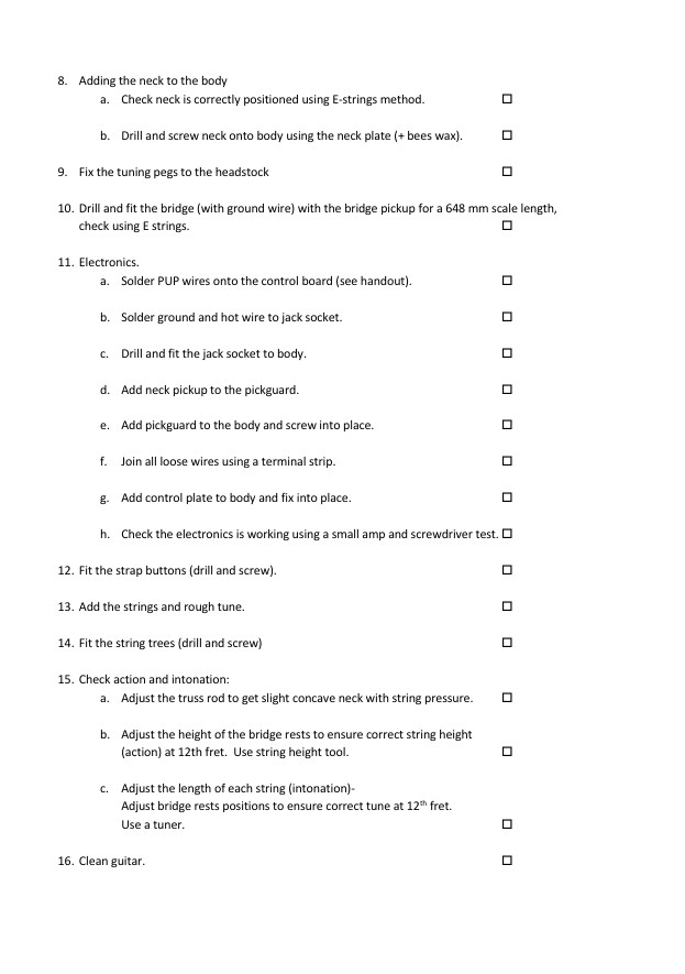

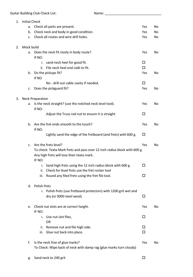

    School resource for building the PBG TL-1 kit.
    I have attached a JPG version of my TL-1 Building Checklist. This provides the plan and sequence of tasks, but not how to do the tasks.
    Please note that this version uses Tru-oil as the final coats and uses a terminal strip to join pup/controls/socket wires together (instead of soldering).
    I would often change the order based on time available.
    If you would like a pdf or word version please pm me. I also have a similar checklist for the ST-1 kit.

    Wow, those are some very fortunate students. I saw the guitars they built in your post from last month and they look beautiful. If I had been able to do this when I was a student, it would be a wonderful memory that I'd never forget. Good on you for doing that, and thanks for posting the build list.

    Love your work, Trevor. That's perfect, easy to follow and instructive. Concise, yet informative!
