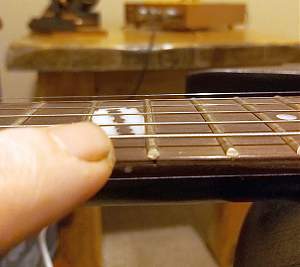

    What is a problem is one fret, the 12th. I had trouble with it earlier, it was slightly raised when I was starting to work on it.
    Now, it's raised so playing anything lower than that fret on the E, A, D strings sticks on that fret and rattles. It's not too bad on the G, and not really noticeable on the top E and A. In fact though, playing the note just after the (lower) E where the fret is, then one note down, it's exactly the same note because of the height!
    This model of guitar doesn't allow to adjust the action / height as far as I can tell (there're intonation screws which I'm leaving until I resolve the fret issue)
    I trying carefully tapping on the fret with a nylon hammer - no luck.
    The only three things I can think of doing are:
    1. Trying to file a fair bit of the fret off, by loosening the strings and very gently with a needle file try to lower it.
    2. I'm not sure if adjusting the neck screw will help (?)
    3. Taking it to a guitar shop after his birthday and asking for them to replace the raised fret.
    I've attached a pic. And one of the finished (almost) guitar. The wiring and everything is fine; it has a nice sound. No hum or anything - the ground wire etc went well. Downside - you can kind of only use 1/2 of the guitar....
    I'm leaning toward option 1 until I can find someone to have a go on option 3.

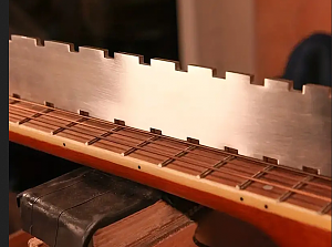

    First step: Take off the strings and set the truss rod so that the neck is as flat as you can get it. Easiest way to know if it is completely flat is to use a notched straight edge. You can get these cheap, or make one for even less. I saw this one on Temu for $7.50 USD.

    Check the frets with a fret rocker.

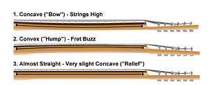

    I may have got my convex and concave slightly wrong - in fact I think I have. I attach a pic where I measured the gap between the string and the actual fretboard. At the head, it's 2.4mm, and the pickup end 2.7mm, on the 12th fret, 3.1mm. In the second pic, my guitar is like example 3, very very slight bow. So it's not too bad?

    1. I can (with strings on, I guess), turn the truss nut (using the allen key provided) 1/8th of a turn clockwise to get the last tiny bit of concave out of the neck.

    That 12th fret looks like it has become "unstuck" so I think it will probably keep moving about over time through playing and environmental changes etc. (in my limited amateur opinion). I'd say it probably needs to come out and be replaced or reset. If it has been filed to level it before and then is reset, it will probably then be sitting too low compared to its neighbors.
    If it were my guitar, I'd take it to Rob Matthews guitar repair in Wellington. He's a great luthier and a top bloke, I highly recommend him. I believe he is operating out of the CBD. You should be able to find him on Facebook to make contact.
