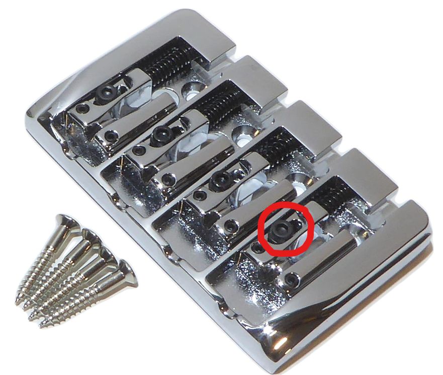

    One thing I will say for anyone worried about what shimming might do to sustain... This thing has TONS of sustain. I have contended for years that the only thing I have found that really improves sustain is a locking bridge. Most bass bridges don't really lock down the saddles, but this is my 2nd build using a Sung-Il BB-404 bridge, which is a relatively heavy locking bridge.
    Once the saddle is adjusted for height and intonation, the screw on top of the saddle (with the red circle) locks it down to the bass-plate so that it won't move. I used it on a Precision, also with a paulownia body, and it also sustains well. It may be the new strings but this one seems even better. The only difference between the two is that I did string-through on the Precision, and string-on-top with this one. I had always heard that that string-through improves sustain, but if anything the sustain is better on this bass.
    Sustain is not usually something I worry about much. I tend to think that most basses have more than enough sustain for most kinds of playing--and that a lot of right-hand technique is actually devoted to deadening the sustain. But I have done some experiments comparing locking bridges with normal F-style and even one G-style. The difference is not huge, but the locking bridges do noticeably better...so credit where it's due ;-)
