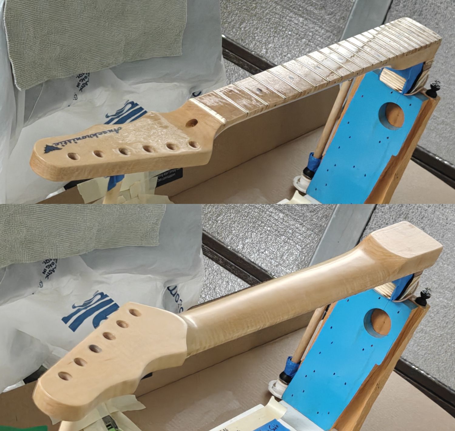

    I had the body sanded and had begun polishing, but have finally gotten the neck sanded down to whatever gray 3M sanding pads are... I think around 800 grit. The neck has also been leveled, and the fret-ends are pretty much dressed. I confess that I cheat on the fret dressing. I hit it with a fret beveling file, and then once the frets are flush I take any burrs or sharp edges off with a maroon sanding pad. Sometimes two maroon sanding pads. This completely destroys the pads, but it works pretty well and is much faster than dressing with files. It only works on a new neck that hasn't yet been finished, since the sponges would also take the finish off.
    I haven't finish crowning this neck or the bass neck I am also working on. I started to, but it was going pretty slowly with my "Baroque crowning file." These have worked reasonably well for me. They are mostly idiot proof and don't require much technique...but definitely takes some elbow grease. It cost me about $30 on Amazon, and does the job... But I decided to upgrade to Fret Guru Dagger crowning file, which has gotten great reviews. It's a diamond file, like the Music Nomad and Stew Mac Z-files, and I have seen reviews that it works as well. Keeping fingers crossed (which makes it harder to use a file ;-) ).
    Also figure that I am going to have to be able to file fret ends on finished necks as well as on new necks, so I bought an Uo-Chikyu end dressing file. I am pretty sure this is the same as the file made by SM and Hosco. In any case, a high quality Japanese file. Will review them here...eventually. But happy at least to get a little done.

    Funny, I have recently purchased a Music Nomad diamond fret file - part of my Christmas present. I also have a fret end dressing file - needed after a number of guitars suddenly had sharp fret ends after a prolonged heatwave a couple of years back.
    I hope the new files are nice the use.

    How do you like the music nomad file? Did you also get their fret end dressing file? I have seen exactly one review of it, and it was great...also I have heard that they are used by makers like PRS. My main gripe with the baroque file is that I don't think the diamond coating is as good now as it was originally. I still wanted diamond coating for the speed and am hoping the FretGuru files will have a bit of longevity. If not...I'll be sure to check in with you again about the MN files ;-)
    Did you go with another diamond file for the fret ends? The one I ordered has a good rep, but it's a conventional file.
    I don't have to do the fret ends much. We have enough humidity here, that wood doesn't shrink much here even it it gets hot. The humidity makes me wilt, but evidently doesn't have the same effect on wood.

    How do I like the MN fret file? I have used it on the Mustang and the Acoustic necks - and I do like it! It creates a nice shape to the fret. The fact that there is the top section that does not file seems very important. I finished by running 600 g and then 1200 g wet & dry across the frets before polishing with 0000 steel wool.
    My fret-end file is a conventional file (the Uo-Chikyu end dressing file), with one surface being smooth - it seems to do a great job. Took a bit of practice to get the hang of using it, but I'm confident with it now. I have been going back through my earlier builds (and some bought G brand guitars) and using it. Filing the fret ends is now a part of my neck work process.
